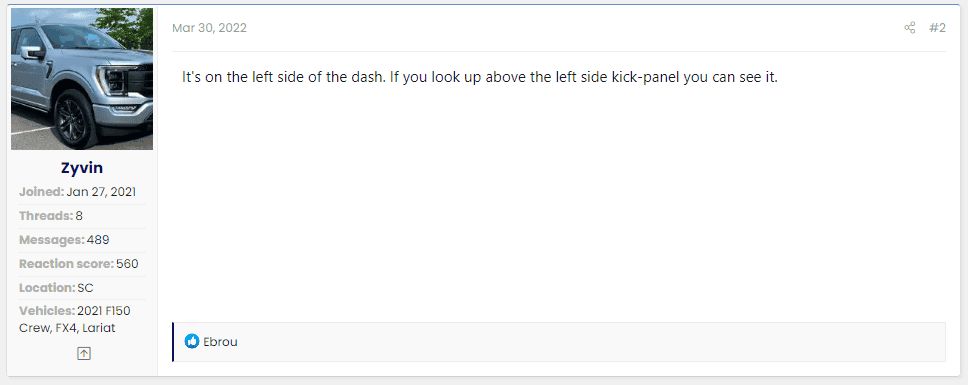

A really bright guy over on the Mach-E forum has figured out how to add a button (or repurpose the Park Assist button) to enable the cameras. This would be handy when parking since the camera view only comes up after you trigger a sensor. Of course you can also bring them up by pressing a few times on the screen but that's not as handy. The 12" screen trims (Pro/XLT) have a physical button already.
It looks like this could be done on the the Lightning. Does anyone know where the IPMA module is located on the Lariat?
Here's the DIY post for the Mach-E: https://www.macheforum.com/site/threads/adding-a-direct-camera-switch-diy-how-to-instructions.23728/
