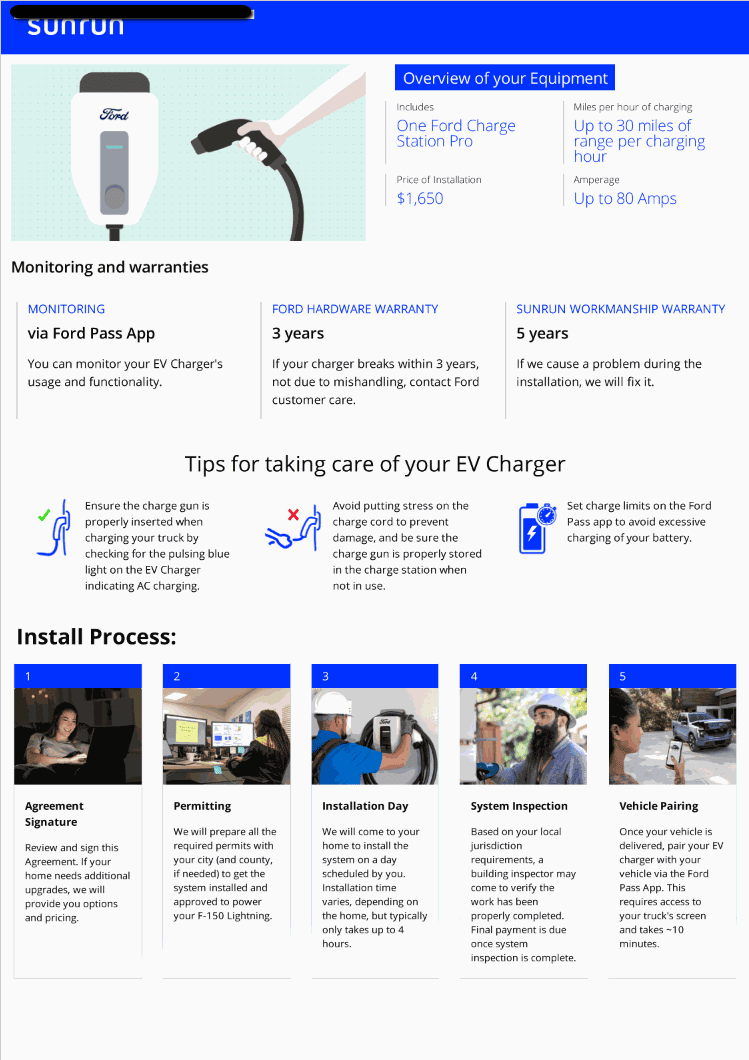

For anyone curious, I seem to be making some progress with the SunRun on getting the Charge Station installed. Initially I filled out the web form and SunRun contacted me. They came out to do a site survey on May 5th. Had to poke them a few times, but today I got the official agreement to sign, along with an installation cost quote of $1650 and tentative completion date of 7/2. Which is after my scheduled date to get my truck.

$1650 all in for 80amp install? Not bad honestly.

That seems a little high to me, but I haven't priced it yet. It depends on how far of a run it is. It's not crazy though.
Does that include any required inspections?

I believe it includes all permitting, installations and inspections required.

But does that include running the 100 amp circuit from one side of a single family sized home to the other side as well as installation of the charger, or is it assuming that you have a 100 amp circuit where (or at least adjacent to) you will install the charger.
I know Sun Run would hate my county because they are very strict in the permitting and inspection process. They require a detailed load calculation as part of the permit processes.

From my discussions with them it includes a installation of the circuit with up to a 65 foot run

My setup will have the charger on the same wall as my circuit panel and solar setup. Charger inside, panel outside. So there won't be much running to get to the charger location.
Just in the garage and to get from one side to the other where they put the 100 amp shut off was approx 50 feet. The garage is about 20 feet wide, it the cabling has to run up from floor level, across the ceiling and then Dow; the opposite wall. This is after it has gone across the length of the basement and u into the space between the first floor and the basement in order to make into the garage. All told, my charge was $2,400 and covers two sets of permits. One for the work already done and the secon for the charger when Sun Run decides to send it.

My lowest quote accepted from my trusted electrician was $1,685 to install a 26’, 100A run from my 200A/240V existing Service Panel….I would say your quote is reasonable…….
