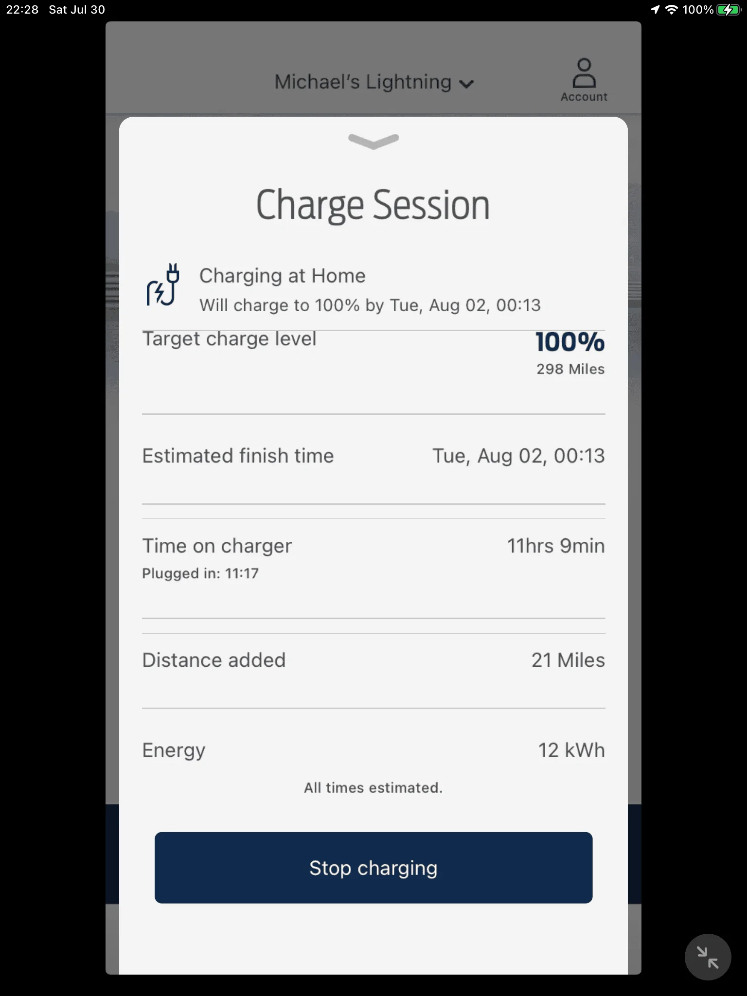

Yes, yes it is terrible…my truck is on 120V/20A now…limping along until I get my FCSP delivered/installed/derated (until Siemens solves their issues). I’m averaging adding about 1.0 kWhr per hour of charge time……
Correct. 1 kWh per hour on 120v.
