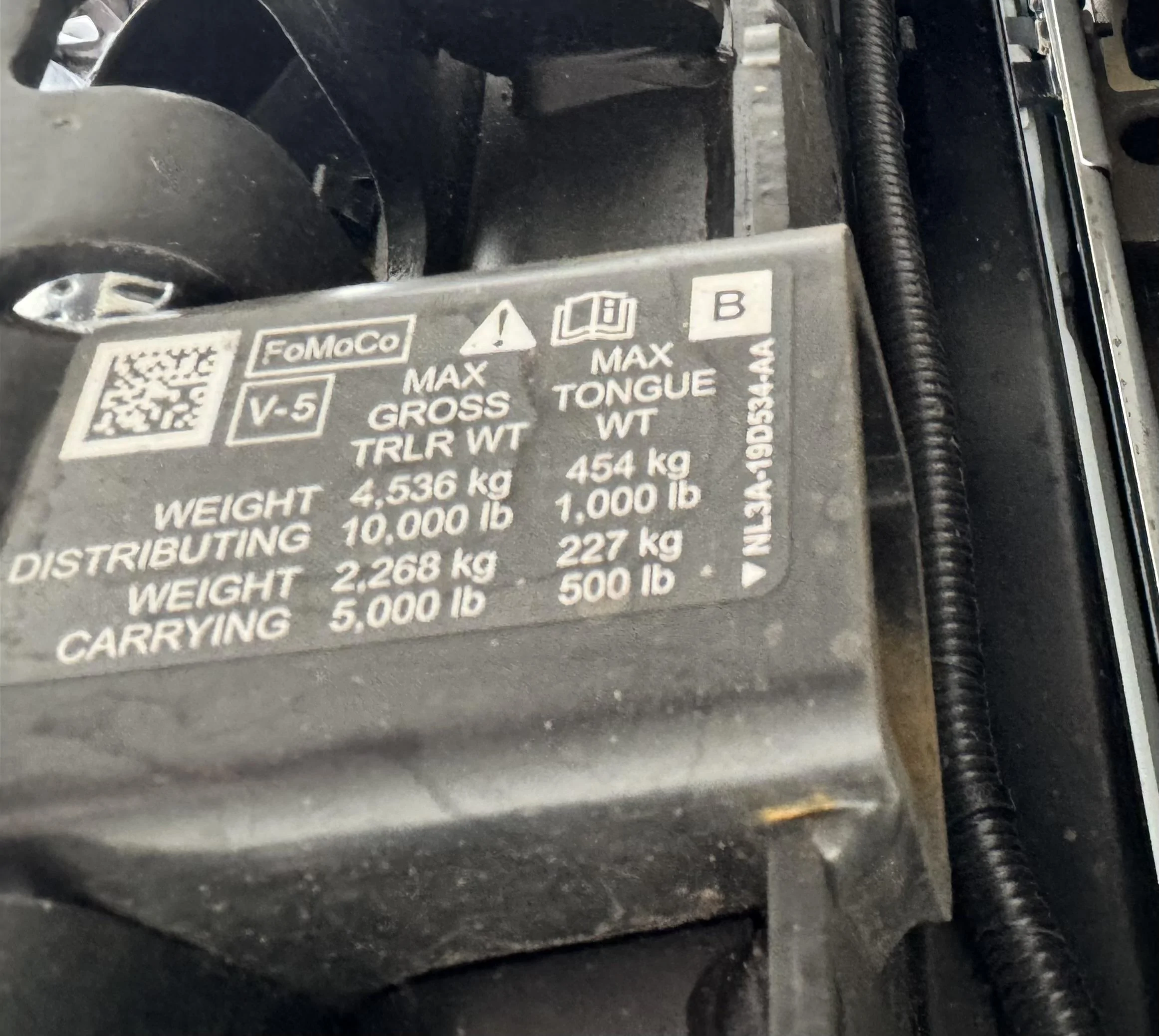

I just found out today that receiver hitches on Max Tow trucks are only rated to 5k lbs with non weight distribution trailers.
Has anyone replaced theirs with a true class 4 receiver yet? If so, what did you go with?
Full story, reserved a trailer at the local rental spot. They bent down to look at the hitch and said no go since it was. 7.5k lbs capacity trailer. That’s when I saw this sticker.
It’s my fault for not knowing but it’s kind of ridiculous for Ford to not provide a class 4 hitch with the weight capacity of the Max Tow.

Every F150 made since at least 2003 when I started looking has been rated for 500 lbs weight-carrying tongue weight. I had a loaner Max Tow Powerboost truck while mine was in the shop, and the hitch was rated for 500/5,000 WC, 1,400/14,000 WD.
The hitches on the ICE trucks are different because the rear frame is an entirely different design. I've never heard of someone upgrading a hitch to get a higher WC rating, and I've never seen any aftermarket hitches for the Lightning. I don't think you'd ever find one because every Lightning comes with a hitch.
I've never heard of someone breaking their hitch by exceeding the reduced WC tongue weight, but it's not something I've done before. It's an extremely common thing, though.

It’s really crappy that they provide a receiver class that doesn’t even come close to the advertised towing weight. It feels like a cheap out move to same some dollars.
5,000 GTW is something like a class 2.5 hitch.
A class 3 hitch would give us 8,000 lbs of GTW.
Trucks with the max tow package are more than capable at handling this weight.
An internet search shows nothing for an aftermarket Lightning receiver hitch. I can’t be the only running into this cheap problem?

Ford is keeping the truck within safety parameters. The truck is not designed to carry more than 500lbs/5000lb on the hitch alone. Loading additional tongue weight will squat the truck more than is deemed to be safe by Ford, hence the limitations. I suggest if you want to tow more than 5000lbs that you actually do use a weight distribution hitch. It intentionally shifts the tongue weight (up to 1000lb) from the hitch forward to a more centered location on the truck instead of hanging it behind the bumper. This minimizes squat and uses the suspension of all 4 wheels to carry the extra load safely instead of over-leveraging the rear suspension only. They work really well for heavy trailers and are far safer for heavy loads.
The factory receiver will work fine to 10,000 lbs if you use the weight distribution hitch as described @SilverJ's post above.

This isn't a hitch issue. It is a truck suspension issue. The trailer tongue weight should be 10% of the trailer weight. A weight distribution hitch places some of the hitch weight on the front axle of the truck and the trailer wheels. The 500 pound limit is to keep weight on the front axle of the truck. Which keeps the setup from being too squirrely. So, if you are carrying 7,500 pounds you should have a tongue weight of 750 pounds, which would overload the rear axle of the truck, lift the front end of the truck and give you a real squirrely ride.
