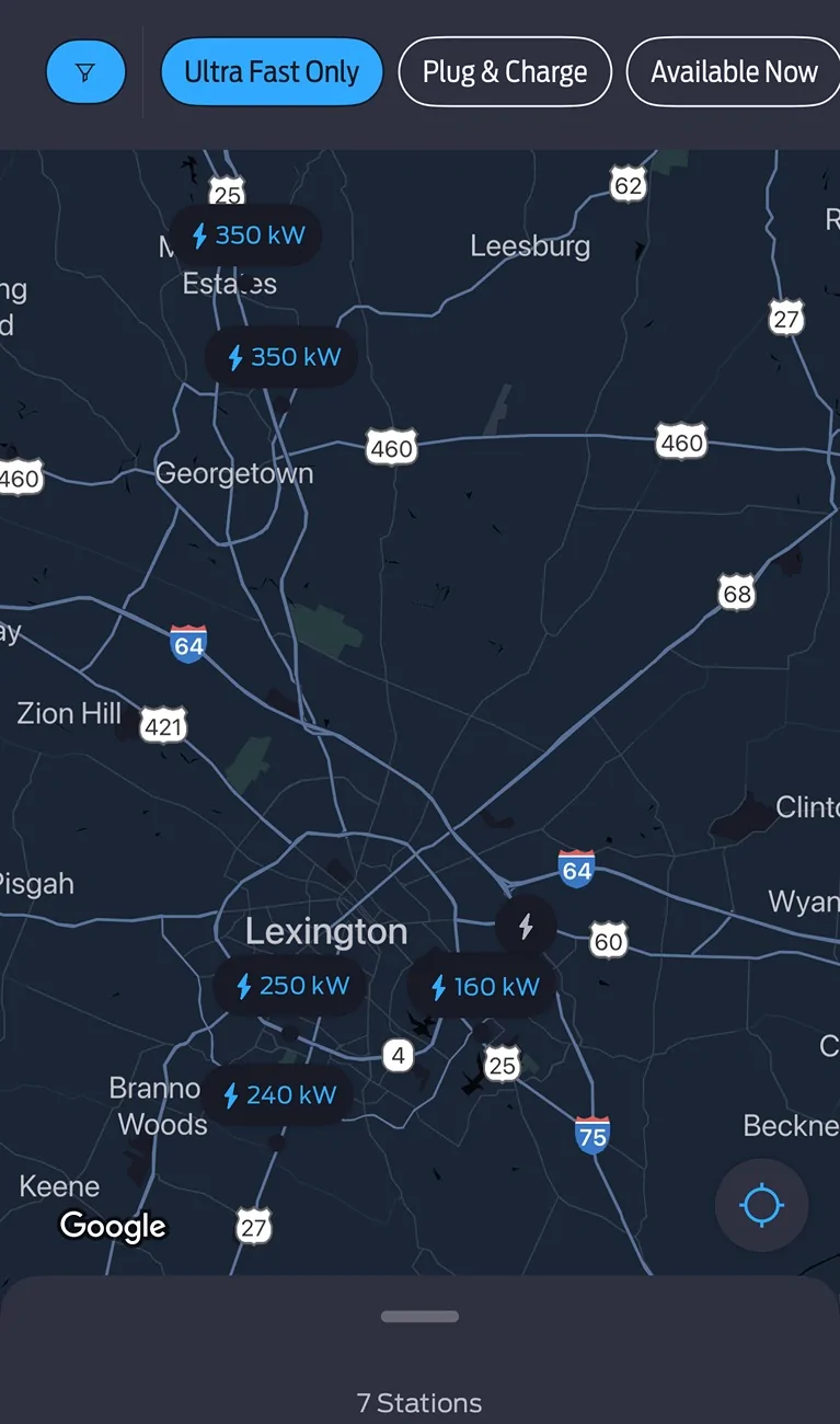

I'm in central Kentucky and I spend most of my time in between Lexington and Versailles and Lawrenceburg and Frankfort. Frankfort is the capital city and Lexington is actually the second largest city in this state. Yet when I pull up the map on my Ford Pass App it doesn't show any charging stations at all around me. What am I doing wrong?
Ford F-150 Lightning How Do I Use Ford Pass to Find a Charger: Solution Post-6 1000015147
93
6,051
8,155
You have some filter set that is blocking them. There are several south of Lexington, and some north of Georgetown.

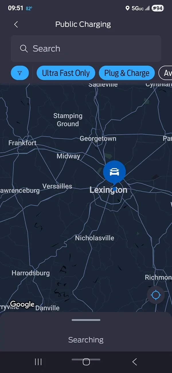

I just went back into the app and turned off all of the filters and now I see absolutely no charging stations on the map at all. Something is jacked up on mine.

Not sure what's up, my app does not show chargers over there either. Just stuck on "searching" with the back and forth chasing status bar.
Alternate sources of charge location info that I would consult, in rough priority / accuracy order:
- Plugshare.com / app
- Supercharge.info (fastcharger.info seems to be abandoned :(
- abetterrouteplanner.com
- Google maps
Edit: FordPass app just loaded chargers around Lexington, about 5 minutes later. Smells like an app / database glitch or maintenance to me.
4,036
5,267
Did you turn off P&C?
