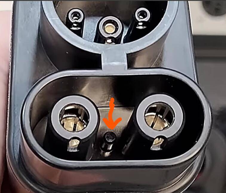

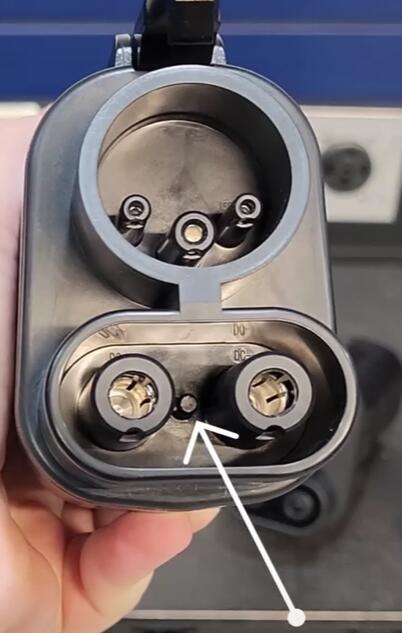

Lectron made a change to their Ford version that is related to the NACS lock. @tommolog describes the changes in his video linked below (the key part is about 4:45 in). There is a pin on the CCS side between the DC pins that locks the NACS side when it is depressed. That means you have to disconnect the CCS side before you can disconnect the NACS side. One way to test is to plug a Tesla AC charger into the CCS adapter and plug the adapter into the truck. Then see if you can pull the NACS plug out. This is a safe way to test since the charger will not activate.

Concur - Based on the state of charge video, that pin would appear to be a NACS release lever lockout device (which is an excellent safety feature to add, so thumbs up for at least the design @Ford Motor Company). The lockout would only be effective if it had successfully latched in the first place if I’m understanding the mechanism properly.

Tested the adapter on Level 2 this AM. CCS end locked to the truck and locked out the cable release lever (underneath) while locking the cable to the adapter. Gave it a tug and for the first time, the NACS cable was securely attached to the adapter.
As @Maquis commented, the NACS release lever is functionless, at least in the case of my adapter. Also appears Ford needs to revise their included instructions.
