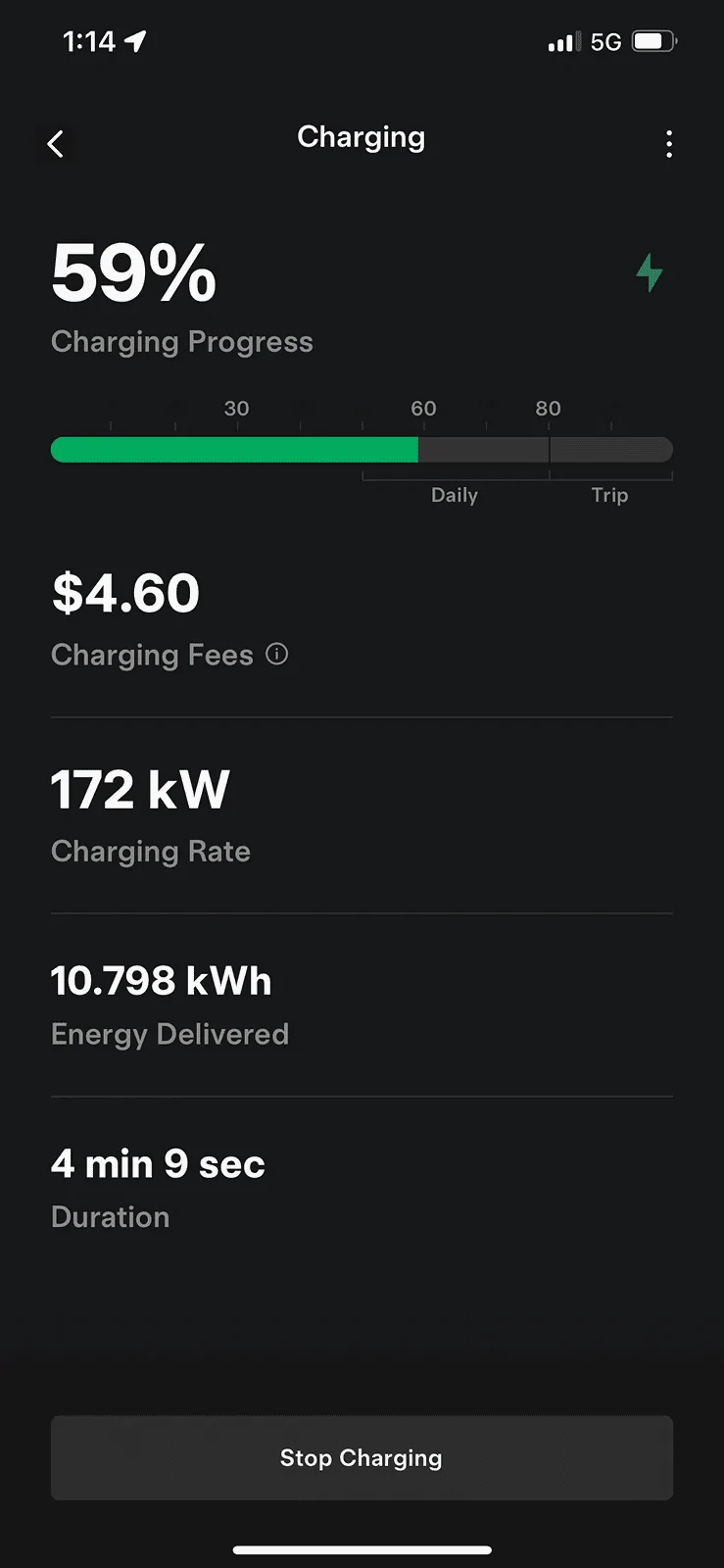

I doubt that there is any throttling. This is with the A2Z, but still a really good charge rate. Comparable with what I saw at EA. This was on a really hot FL day a few weeks back (well they all are this time of year anyway).
Ford F-150 Lightning Tesla Adapter overview from Tom IMG_8271

Reports of derating happening with Tesla adapters and Magic Dock with Rivian and Ford due to the Handle temp . The Tesla wet rag trick helps and so does cooler weather. Anecdotally could be less derating with the A2Z, but nothing definitive.
Hoping somebody does an objective investigation.
https://riviantrackr.com/news/hot-temps-derate-tesla-superchargers-for-rivian-ford-evs/

Interesting. I’ll have to do some comparison testing when I get my ford adapter. Or maybe I can get a local owner to ride up the superchargers with me one day to do a side by side in the same conditions. (I’m looking at you @flyct ?).

For what it's worth, as someone who has supercharged an absurd amount with an A2Z adapter the past couple of months: There should not be any derating on that initial charging spring (165 - 170kW), it's only after that fades you start to see the effects of heat (it drops down to 100 and even 80 whereas in good weather it should hold 120 til 70% or so). I saw this exact behavior with EA stations as well as Tesla on my last trip. I saw the same thing last summer using EA across the South in 100+F temps. I think it's just the truck protecting itself. By all means, do a side by side test in the same temps at the same location because it would be interesting to see what occurs but I wouldn't get my hopes up that one adapter will be clearly superior, at the end of the day when it's legit hot out don't expect to pull normal speeds once you've been on the charger a bit.
Counterpoint worth exploring more, I was in 100+F temps on my trip this past week and I stopped to charge at a Tesla station, couldn't find a bathroom so jumped off, drove another 20 min, then charged again and got the same 170kW sprint I did the previous charge. So maybe there's a strategy there in high temps to charge much more frequently and for less long versus letting the charger derate down below 100kW due to heat. Food for thought and ideas to explore in testing.
