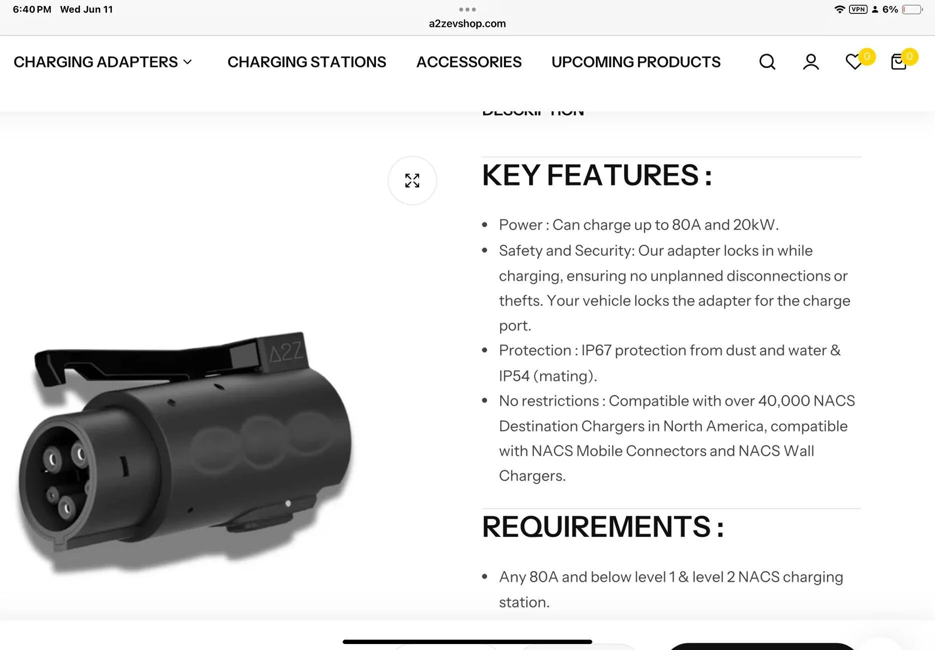

If you have a 2023 or older Lightning ER it should charge up to 80:amps. The 2024+ Lightning Extended Range will only charge up to 48 amps.
This L2 adapter is rated for 80 amps and should work at your office 100 amp circuit Tesla Wall Connector to charge your 2023 Lightning ER at 80 amps.
https://a2zevshop.com/products/a2z-stellar-plug
I haven’t been successfully getting this adapter to work with my HPWC at my office I get a charging error on my phone app screen. Do you have any idea what is causing this?
114
7,236
9,915
As post #15 said, "The HPWC must support the J1772 protocol (most newer ones do)." It also may have a "Tesla-only" setting.
