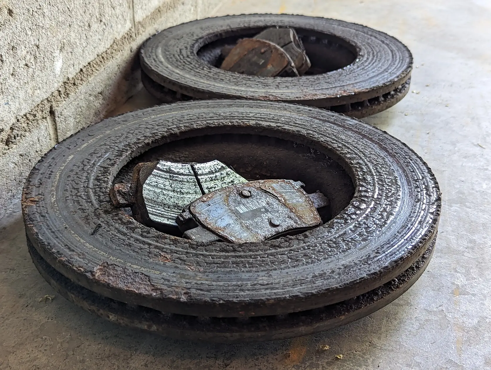

Make sure you brake hard enough to use the friction brakes periodically.
I learned this the hard way when my Chevy Volt didn't pass inspection. The rear rotors had rusted too badly from disuse.
I don't know what the hell you were doing with your rear brakes, but this picture isn't from Disuse! Are you smoking crack?
I had issues with the rotors of my Chevy Bolt rusting in the Northeast when I lived there...
Bingo. The car was mostly parked outside in wet, cold New York state, driven on salty wet roads in the winter, with occasional trips to western PA. This was absolutely due to disuse of the friction brakes.
It doesn't take much to prevent this. Just slight friction braking once a week would have been enough. This amount of rust happened after about two years, IIRC.

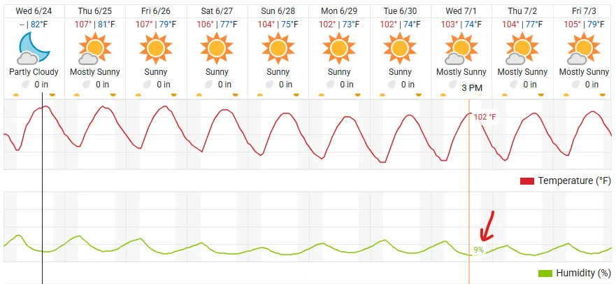

Hopefully, by keeping my Lightning in a closed garage when I'm not driving it, where the humidity is usually lower than 60% (this is central Texas) and with no salt on the roads in winter, rust-related issues will be minimal.
2,780
3,058
Ford F-150 Lightning 1Pedal mode causes rear rotor rust 1782339925633-7q
When it comes to worrying about rust, single digit humidity FTW. Now if I could stop shocking myself every time I get out of the car, touch a door knob, get up from my desk, ....
