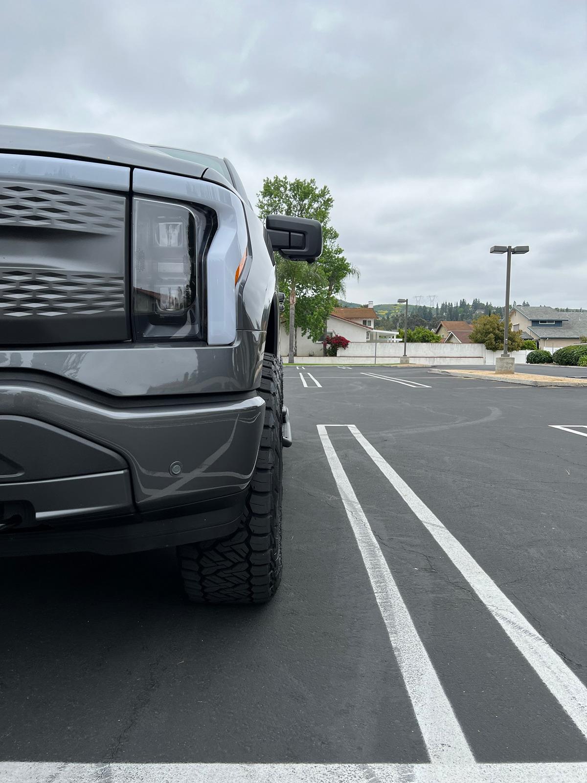

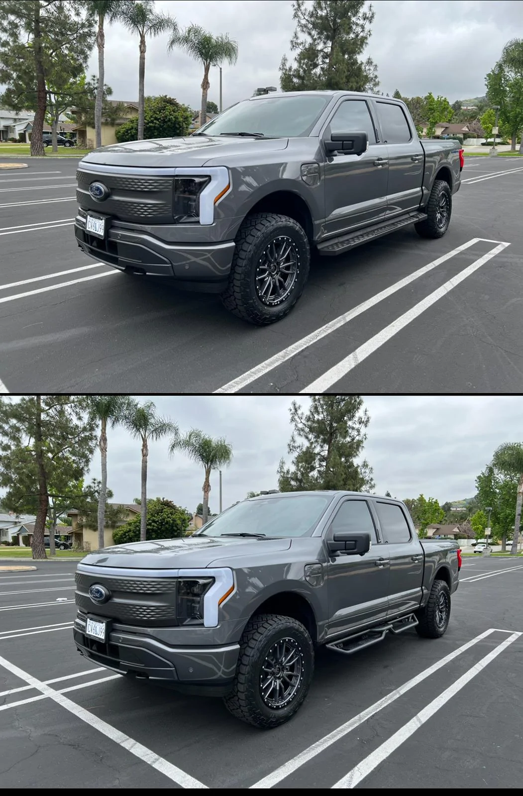

OK so I did something today and I need some opinions. I changed out the running boards. I really like the way these new ones look, but.... they are wider than the OEM ones and from the side of the truck you can see they protrude about an inch beyond the wheels. Maybe it is ok? I feel like I am violating some kind of rule. I think it would have looked better if my wheel offset was closer to 0 then the +20 now...
Ford F-150 Lightning 2.6" Eibach Shocks Level, 295/60R20 Recon Grappler Tires, Fuel Rebel 20x9 Wheels IMG_0412
It is hard to capture in pictures, but it is noticeable to me when I stand next to the truck how they stick out a bit:
Ford F-150 Lightning 2.6" Eibach Shocks Level, 295/60R20 Recon Grappler Tires, Fuel Rebel 20x9 Wheels IMG_0410
What do you think? OK? Or not OK?

I mean, it's not illegal. If you like it, you shouldn't care what any of us think. I personally wouldn't go with that running board because I use the very back part of mine as a way to step up and access the bed, but as far as looks go, those are pretty sharp.

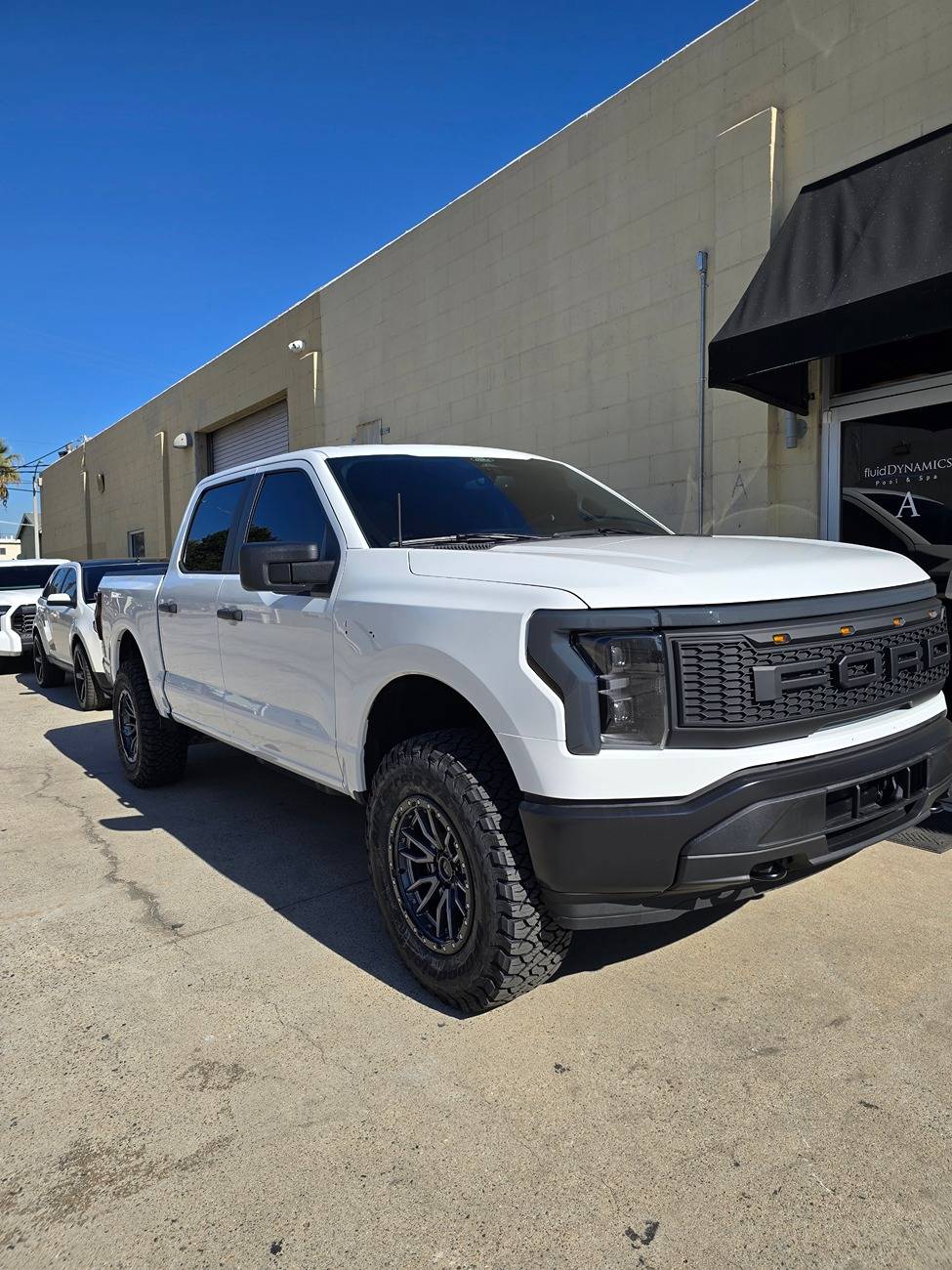

Mine stick out a little too and it doesn’t bother me. But I like the boards better than the steps.

That's a stunning F-150 Lightning, Erik! Thanks for sharing!

I like my running boards to protrude a bit. Then they can act as a "bumper" for at least the front doors of small cars and suv's, as the bottom of the door will contact the running board before the top dings your paint. Helps that you lifted your truck a bit, as it will catch more vehicles.
Doesn't help for back doors though, as they usually have a cutout for the rear wheel well.
I like the look! Post range numbers from the wheel swap when you get them. How many kW/mile are you averaging?

Thanks! After a few days, I definitely like these steps, i am keeping them for sure. The thing that keeps bouncing around in my head is if I should try and swap these wheels for ones with more poke. Maybe not, but we will see. For now I am pretty happy with it. After about 400 miles i am getting 2.0mi/kWh. So about a 15-20% range hit, but IMO well worth it...

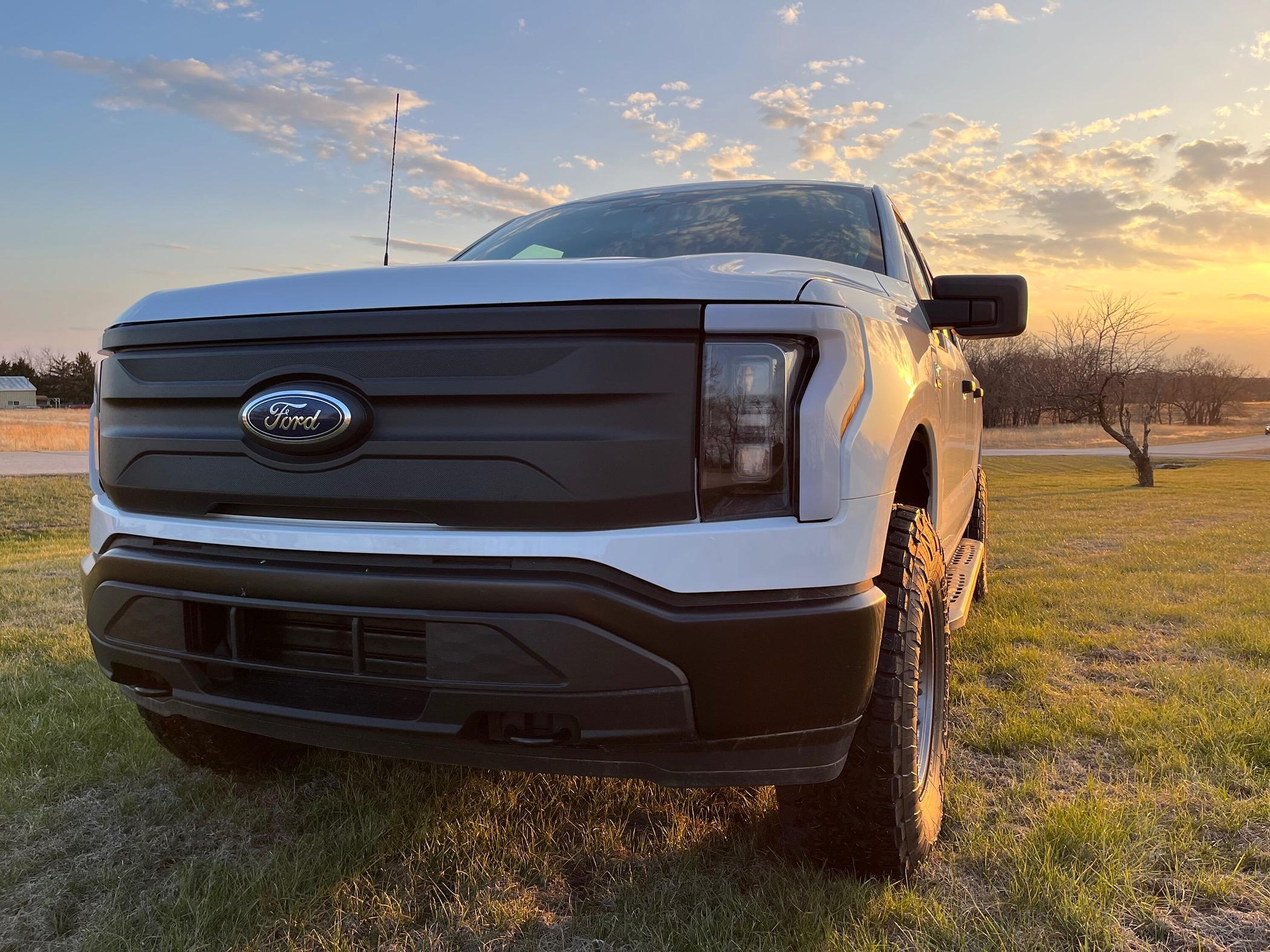

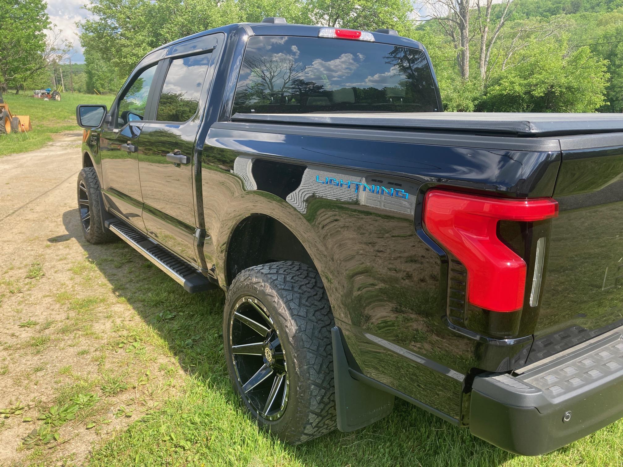

For reference these are 10 x 20 with a -19 offset. 275/55/20 tires though. Around zero offset might be perfect for ya. What running boards are yours? I was thinking of making extentions for mine, but maybe just replace them.

Yeah I was thinking an offset close to zero would be better, but after having them on for a few days, I think I am happy with the way it is.
Here are the ones I got: https://www.oedro.com/2015-2020-ford-f150-supercrew-running-boards-0108
Their selector tool didn't have these for the Lightning, but the running board mounts are the same as an ICE supercrew, everything bolted up just fine. And these are pretty reasonably priced too.

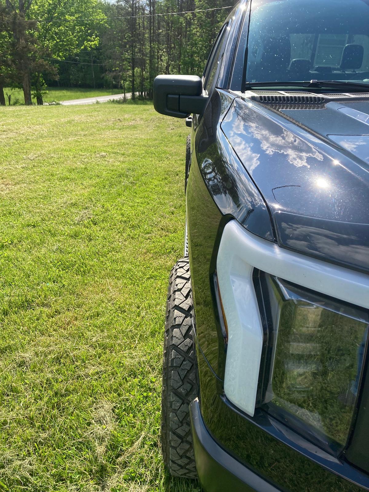

For reference to those viewing this thread
I went with the Eibach kit as well, but I went with 295/70/18's with 18x9 Fuel Rebels at +1mm offset
Yes I did need to modify the bumper and a tiny bit on the front crash bars, but nothing dramatic.
Not sure my range hit yet.....
