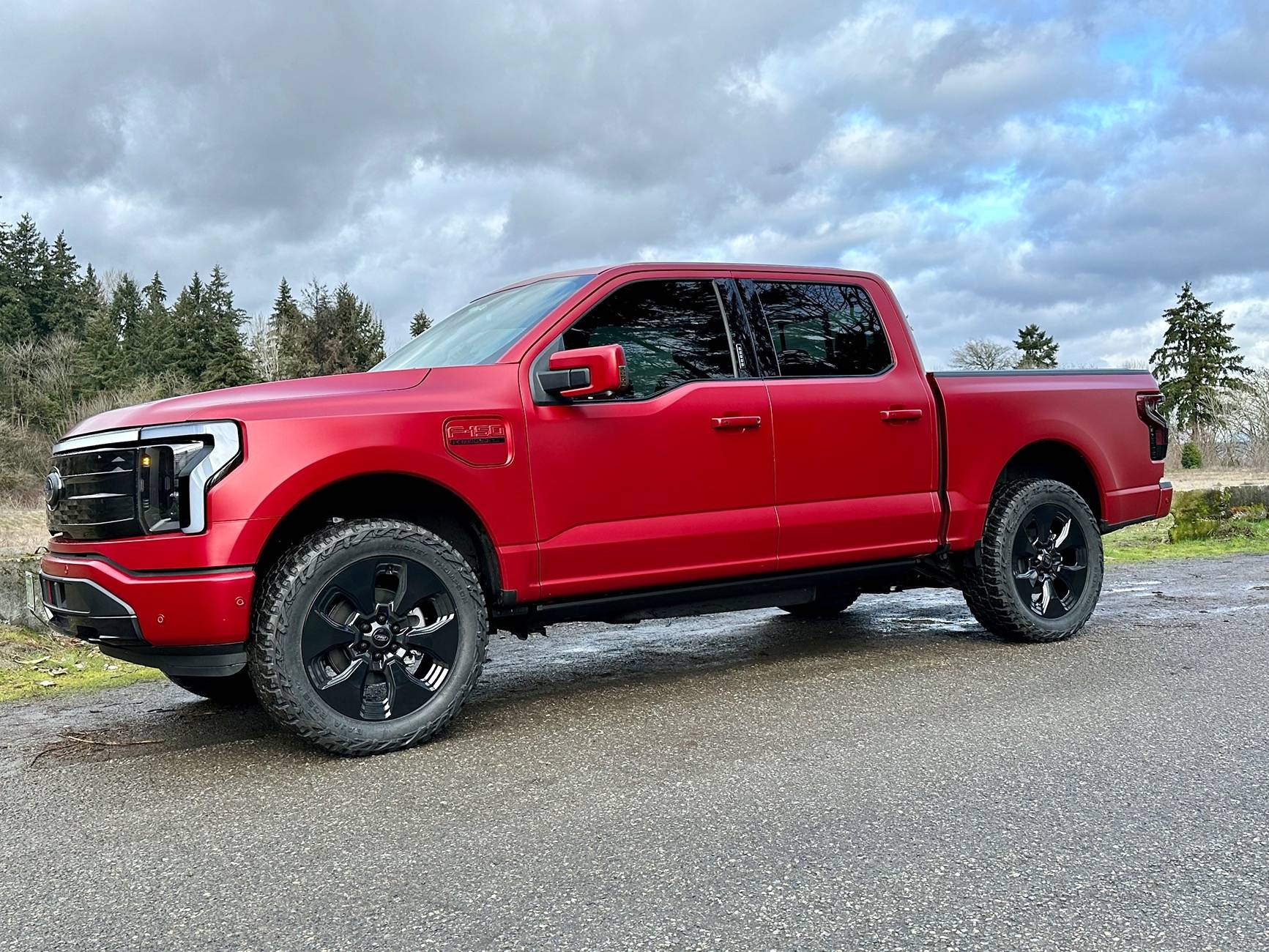

yes and no. It is the oem carbonized grey but put Xpel stealth satin wrap over it.
XPEL stealth for the win. So many comments on it. Nice looking rig, man!
Ford F-150 Lightning Eibach 2.1" level, 275/65R20 tires, Fuel Rebar +20 wheels IMG_1396
