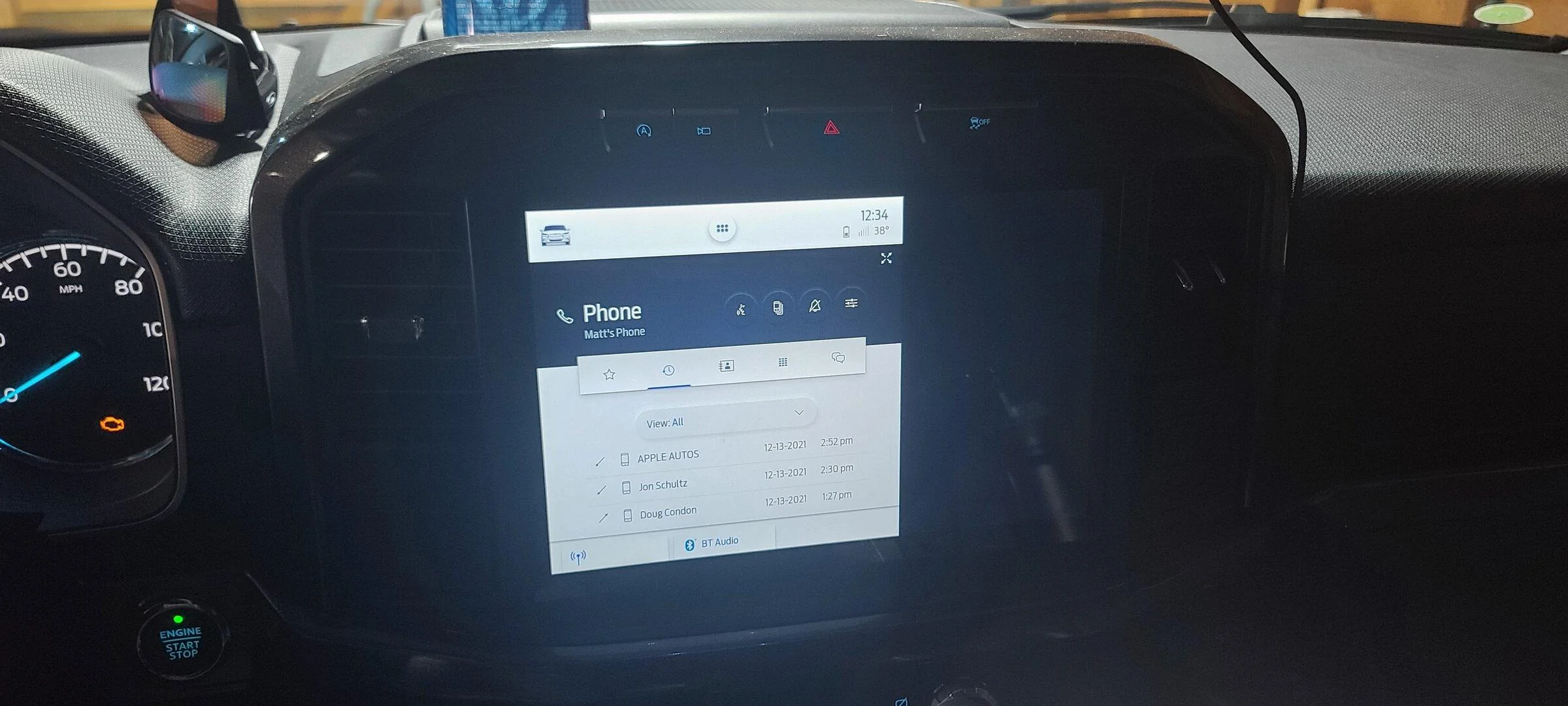

Had some free time today so I played with a couple things. First of all, the DRL brightness mod 100% worked for me. Very cool!
I asked a couple times about changing my screen size to try and get rid of the sidebar and force everything full screen. I tried all the configurations, and none seemed to change anything, except for 09 - 13.3" Landscape (Qt based). That one changed my layout to the one from the Mach-E, squished on to the left side of the screen. ??
Ford F-150 Lightning 2021+ F-150 FORScan List / Database / Spreadsheet ? 20211214_123449
Interestingly enough, changing back to 03 (my default value) brought up the Mach-E screen again. To get back to normal, I had to switch to 00 (8" landscape) and then back to 03 to get my original screen back.
Unfortunately, there isn't a way to get rid of the sidebar via the screen size settings... ?
