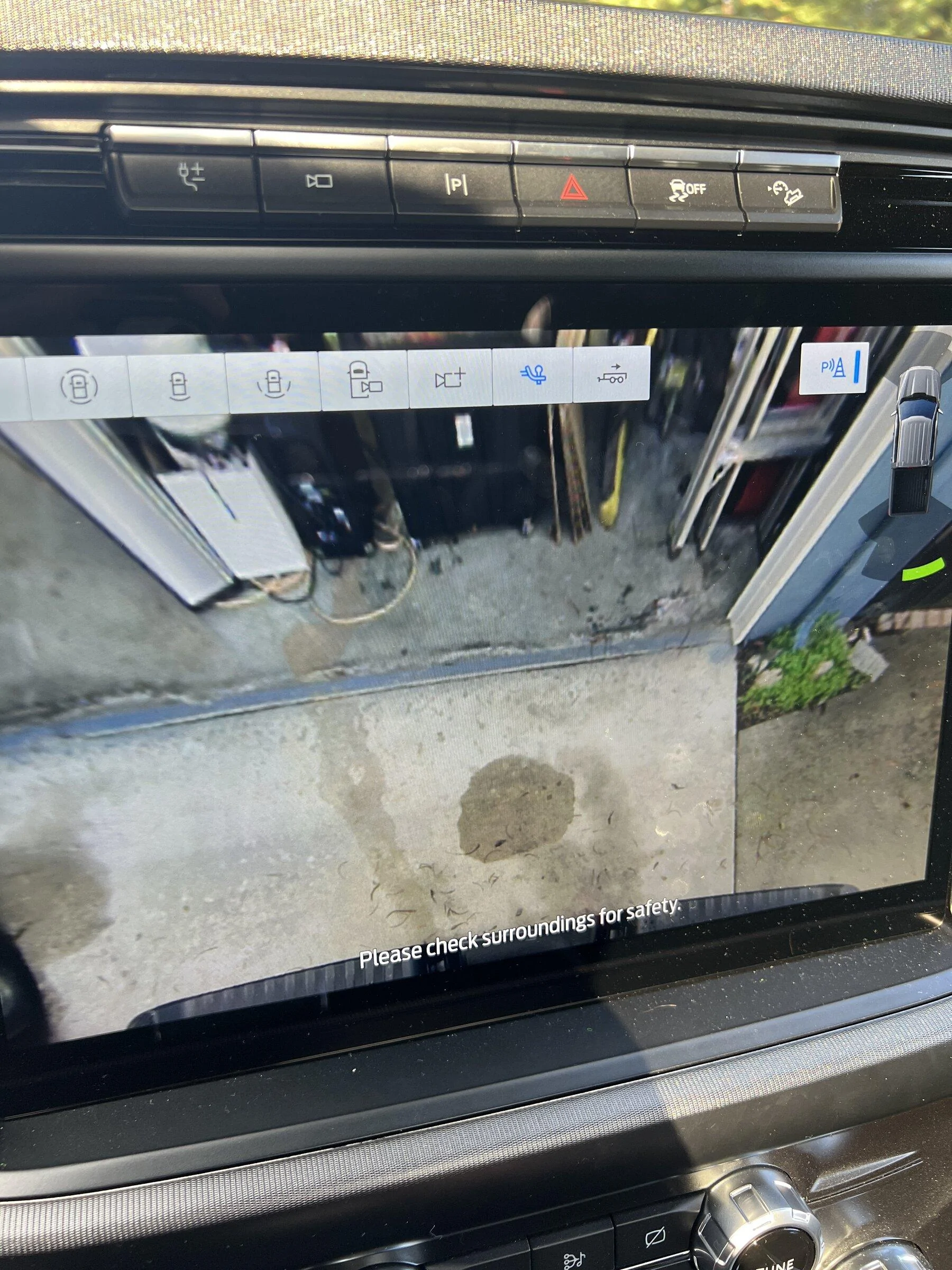

The camera in motion is possible on the PRE 21.5 Builds.
1 - You need to update the IPMA. FDRS Only cant be done with USB like other modules. Takes 4-8 hours. The update will allow for the IPMA to display in motion. The update will NOT allow the cargo cam to be full screen or to display on side card.
2- The 21.5 Builds have a different IPMA. They are much more expensive than the 21 Builds. I looked into upgrading mine. I added 360 Cam to my truck and was frustrated with the state of no cam in motion. So i looked at the later build IPMA and they are WAY MORE than 21 builds.
3 - The 21.5 builds APIMS have a later build for the software. 21223. This update as of NOW is not available for 21 builds.
4 - The IPMA update alone will NOT give you camera in motion. The APIM as built data will need to be altered. I took a 21.5 build as build and used it as a base. You may be able to go into the Forscan APIM configuration(Non Hex) and select the options to make it work. I dont know.
5 - The Update WILL provide the new hitch view capability.
I have tested all of this MINUS the 21223 build because I can only update apims to the 21146 build as of now. I need a later Gateway (October Build) module to be able to update beyond that as of NOW. I do not believe the later APIM build adds any functionality such as cargo cam on side card/full screen - July/August builds have it and do not have that build.

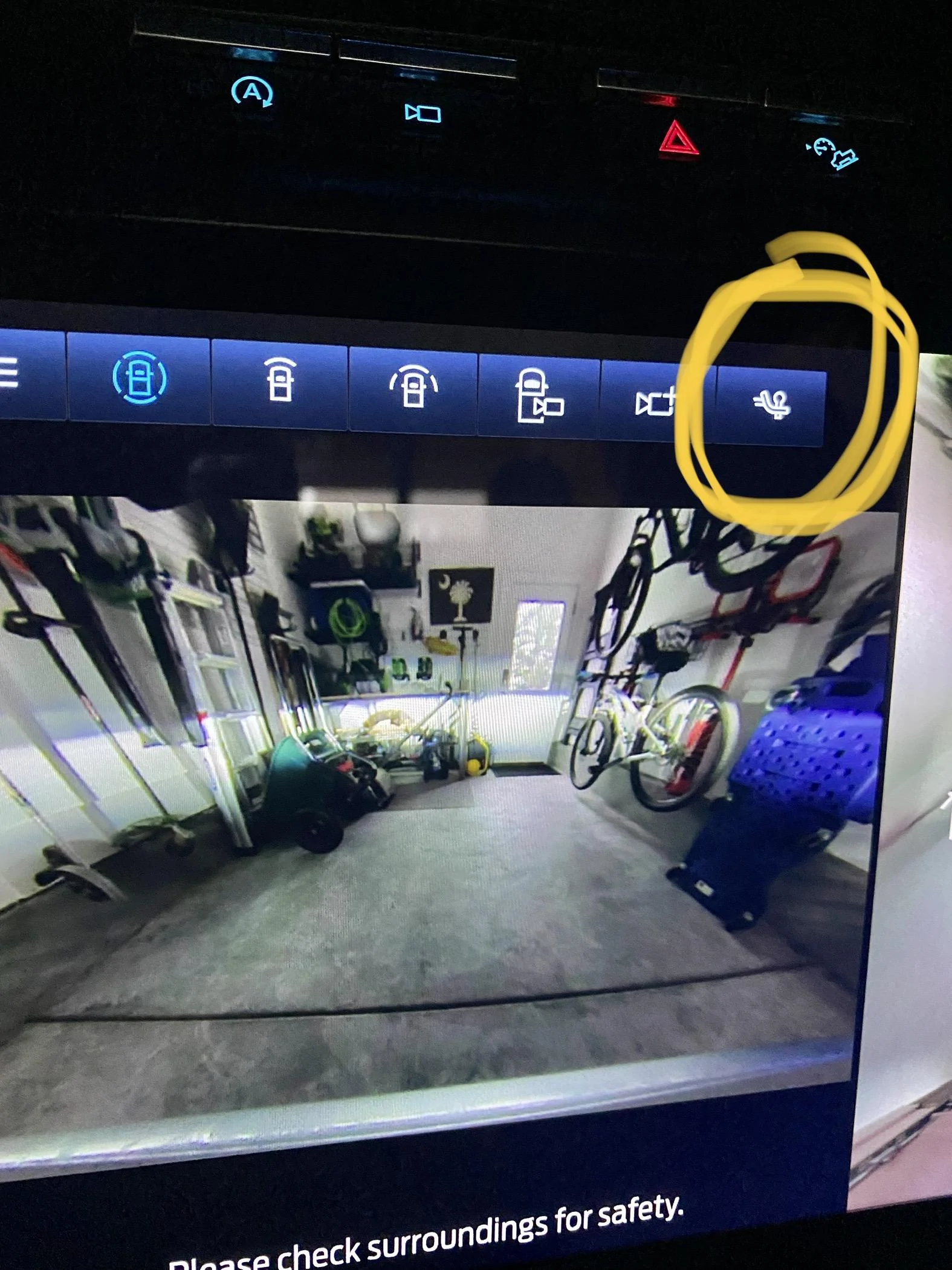

What’s the NEW hitch view? I added hitch view to my APIM. Granted I can’t use at speed, but I can select it, where I didn’t have the option before.
Hitch view should show it as if looking straight down on the hitch, not part of onboard scales as I don’t have ccd or the scales.

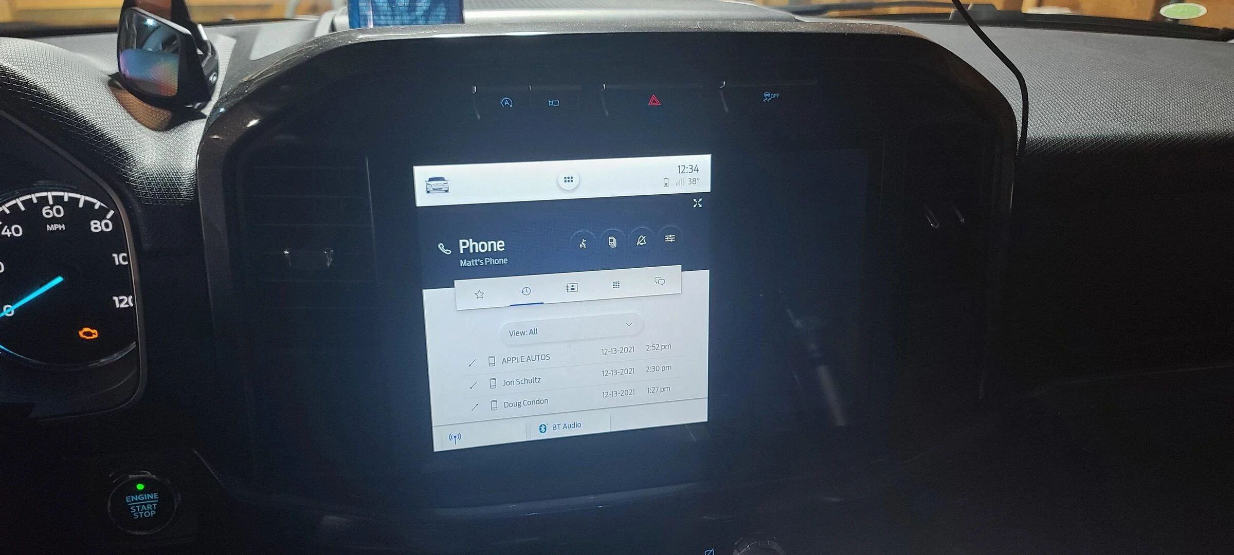

Unfortunately, there isn't a way to get rid of the sidebar via the screen size settings... ?
Had some free time today so I played with a couple things. First of all, the DRL brightness mod 100% worked for me. Very cool!
I asked a couple times about changing my screen size to try and get rid of the sidebar and force everything full screen. I tried all the configurations, and none seemed to change anything, except for 09 - 13.3" Landscape (Qt based). That one changed my layout to the one from the Mach-E, squished on to the left side of the screen. ??
Interestingly enough, changing back to 03 (my default value) brought up the Mach-E screen again. To get back to normal, I had to switch to 00 (8" landscape) and then back to 03 to get my original screen back.
I think that X with arrows on the screen will make it full screen and get rid of the sidebar.
