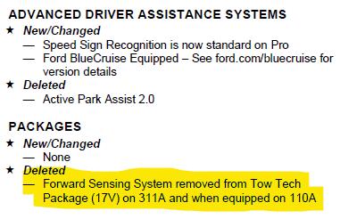

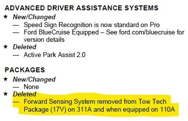

I posted this in the FORScan thread - but the 2024 Order Guide does state that the Forward Sensing System was removed from the Tow Technology package for XLT and Pro.
Ford F-150 Lightning 2024 Lightning XLT "build & price" AND window sticker both say it's included - it's not: What now? 1736452713467-p3
Ford F-150 Lightning 2024 Lightning XLT "build & price" AND window sticker both say it's included - it's not: What now? 1736452759228-94
The website has been persistent about displaying outdated information. E.g., in 2023 it still had features for the Lariat that were removed that year (underseat storage).
I would think if it shows on the window sticker though, that's a legal obligation. In the '23 Lariat case, it was not on the window sticker so no recourse.

Hi, I was shown this after I'd put 500 miles on the truck. It was helpful in that the dealer understands it's a Ford marketing department problem. Before they found the "delete", they were insisting Forward Sensing System was part of the Pre-Collision and AEB system and that I was just confused. I think you suggested on the FORScan thread that I search the ICE F-150 threads. Thanks, I found someone who added the sensors on 2021, so we'll see how badly I damage my truck with FORScan.
