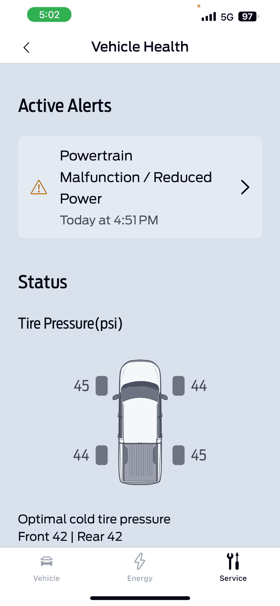

I keep getting this issue, When I start the truck I get a Service Vehicle soon notification. Sometimes it stays on sometimes it goes away. I took it to the dealer and they couldn't figure it out. Basically said just live with it. The Ford Pass app sometimes show an issue with it but goes away. One said something about powertrain fault. 4wd system not working as it should. Then other times it says shifter issue. Been to the dealer 3 times now and no answers. I screenshot this, but It doesn't tell much. The truck is running fine.
I have no idea what to do now.

Took 5 weeks at the dealer to figure out the ABS module was bad and the Shifter needed to be replaced. No Loaner vehicles available and for would not pay for a rental. Only reimburse me for the rental IF its a covered repair. Ford was no help at all on this.
