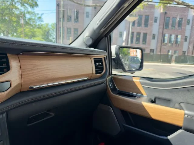

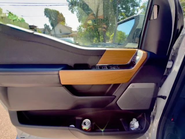

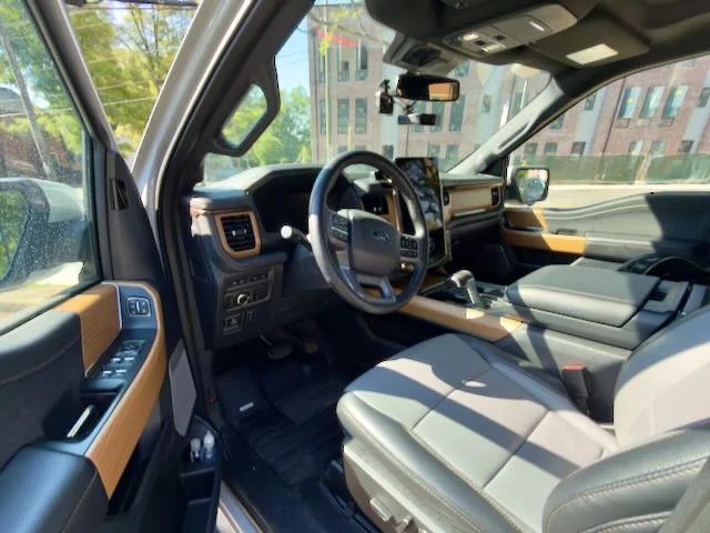

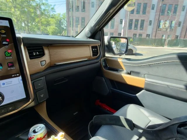

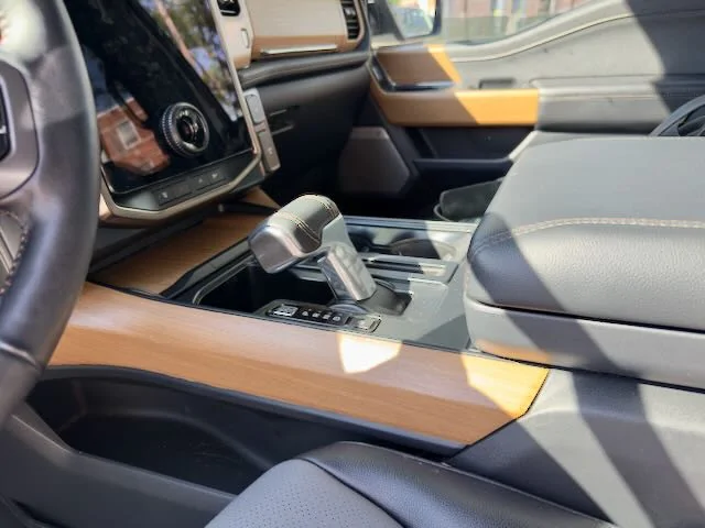

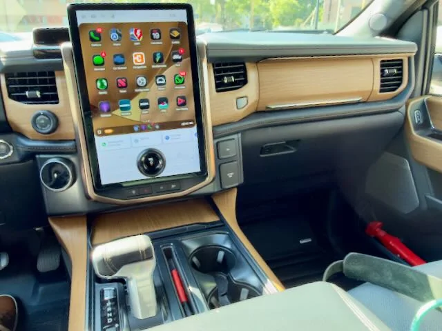

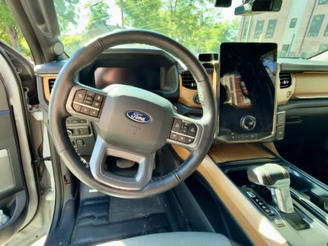

All that to say.. After 18 months of staring at the sea of grey, I finally broke down and vinyl wrapped the interior with 3M™ DI-NOC™ Wood Grain. Do I love it? No. Is it better than stock? Absolutely. The woodgrain actually picks up the brown stitching that's running through the cabin and breaks up all that grey. I'll probably redo the sliding cubby cover in all black — the wood's a bit much there — but overall, I'm happy.
What do you think?
Woodgrain: 3M DI-NOC Burma Teak Woodgrain Vinyl
Black: 3M 2080 Matte Black Vinyl Wrap | M12
Next up: Katzkin throughout.

Undstandable! I still remember staring at the "wood" down the side of my mom's Plymouth Voyager thinking, "why would the do this?" This Di-Noc vinyl is a significant upgrade from 90s faux wood. It's architectural vinyl used primarily in PJ and yacht interiors. It's really very good.

Looks really good! Did you have to disassemble anything to make things fit and look stock? Personally not a fan of woodgrain myself, but would definitely be interested in covering surfaces in a matte black. I'll be checking out the Di-Noc vinyl for sure as well.

A bit much for my personal taste, but you did a fantastic job! Did it come in a precut kit or did you do that yourself? I have to admit, if I did that it would likely look a 3rd grader's handiwork.

Thanks! I did it myself from a large piece I ordered. No pre-cutting. The only pieces I disassembled were the two long pieces in the center console area. Everything else was wrapped in place. It took me some time, but having regular plugs makes it much easier to use the heat gun! The wrap job I did on the light bar was a much different story. It looks so bad I have an appointment to have it done professionally next week.
Two things I'll likely change to matte black: the pieces on the door handle and the cover to the charging cubby.

I would prefer a darker stain color and a bit less of it. But you nailed the execution of it and I like the idea. Never attempted anything like that though, so it feels a bit out of my wheelhouse to DIY.

Thanks! I agree on less of it, and I thought the same thing about the stain color. I ordered six samples with this being the lightest, and was surprised that I liked the look of this one the most.
Here's another option that I think most would go with. It matches the wood in our Rivian exactly.
It's not very hard once you get the hang of it. Vinyl is very forgiving and can be repositioned a few times. There are endless how-to's on Youtube.

I'm a fan of wood, but in my opinion you overdid it just a bit for my taste.
Still, you did a really good job with the install and as far as how clean it looks, I can't find any defects, there! Good work and as long as you like it, that's what counts!

You made your self a king ranch lightning!
Nice job please share the photos of the exterior light bar and charge port doors when they get done.
