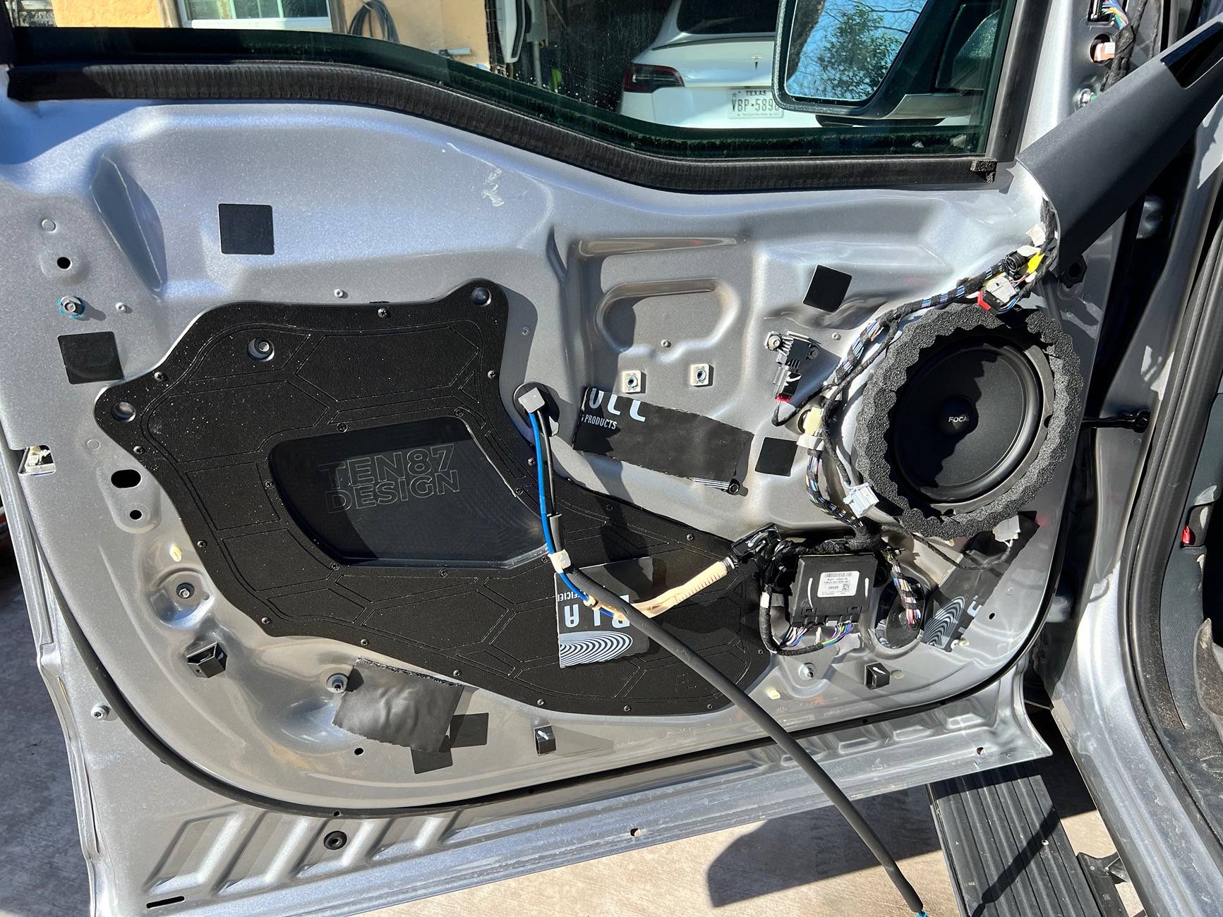

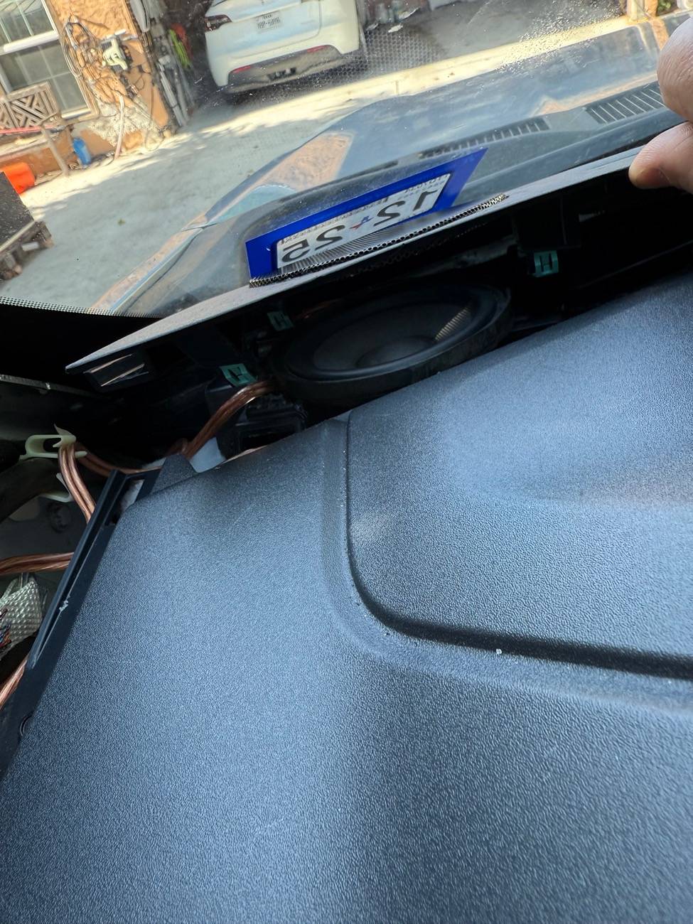

You are going to need an amp(s) and an A2B device. I just (last few weeks) installed an iDatalink Maestro with an Audison AF-C8.14 DSP amp. With the 8” drivers I replaced in the front doors I don’t need a sub. I also added midrange speakers to the dash. It’s as good as my Model Y now. It takes time but what you are able to achieve with a DSP amp is impressive. Enter Sandman sounds awesome now. This is something with a bass beat for comparison.
I agree that Tesla has one of the best factory systems and they do part of it with speakers across the dash. What I've found with the truck and what I bought was good replacements for the doors and tweeters, upgraded the amp and got a good tune for it. A good tune can set the sound stage across the dash from the doors and tweeters without dash speakers if you don't have them. I won't say maybe they'll still help, but that awful center speaker Ford put in does have to go. I just disconnected it and replaced all the others with Focal Flax and a JL Audio sub.
I’ve got 3 of the Tesla 100mm (4”) speakers in the dash. The center is disconnected right now because I ran out of powered channels. Currently it all sounds very similar to my Y. There is SO MUCH you can do with a DSP amp and I think Telsa has a very heavy tune to thier speakers to the car. I tried one of the 3/Y 8” in the door and did an A/B with the Focal 8” in the other. The Focal was a lot better, but the Tesla speaker also sounded better in the Tesla. I’m considering adding another 4 channel amp to just run the doors and free up a channel for the center on the current amp. I don’t know that it would get that much better though. Same with a sub. I would need to go pretty big to get something that would overpower where it is now. How much better do the Flax sound than the Focal polyglass?
I didn't do any comparisons. I shopped the two bigger online retailers that sell "kits" if you will. They both used and sold Focal Flax at the time. I did a bit more research and just went with it.
