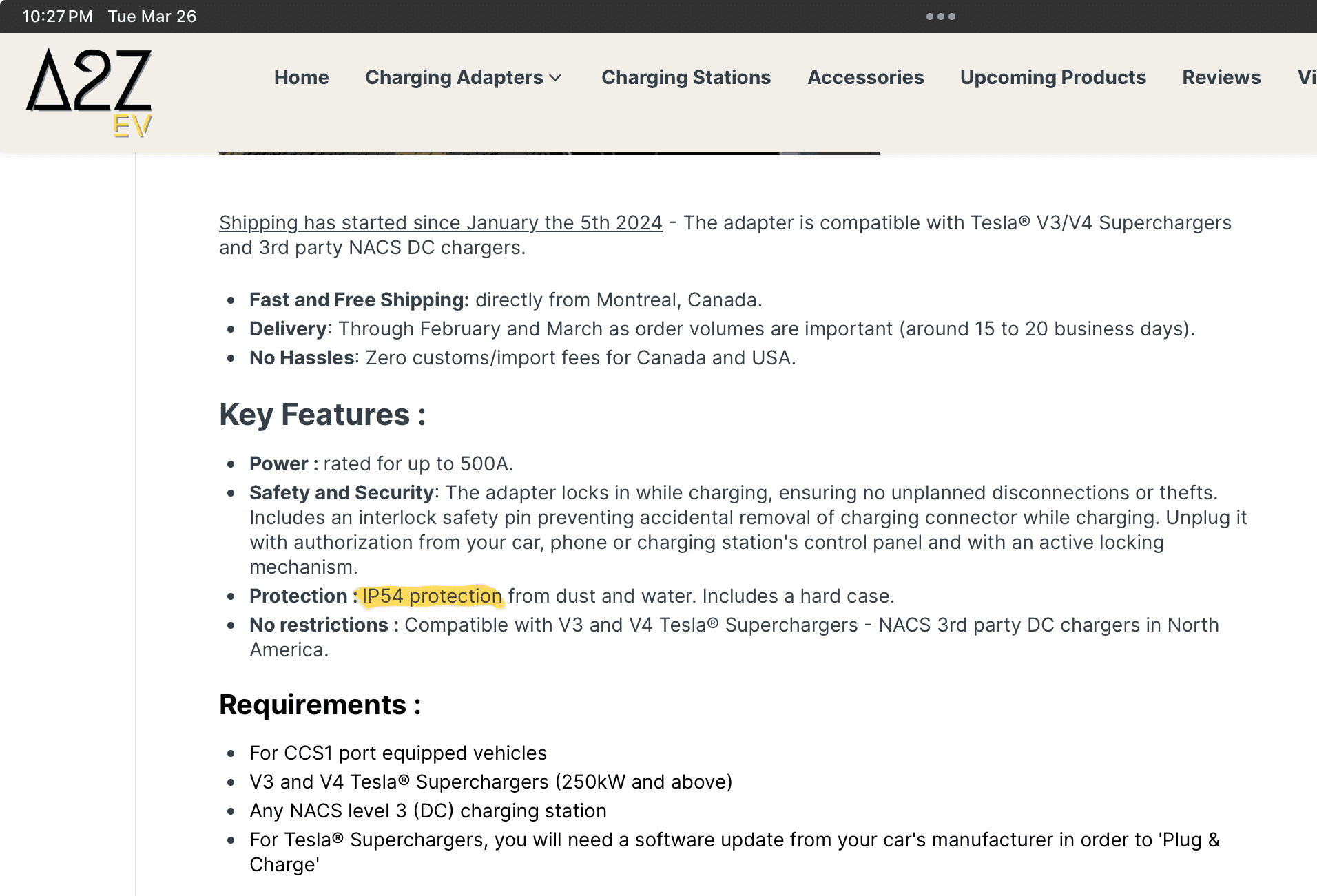

A2Z is IP54. Lectron IP67. Both made in China. Anyone knows what Ford/Tesla Rain rating is? Where it is made?
knowing the A2Z NACS to CCS1 adapter is fully insulated from the inside with organosilicon and seals all around the the pins, we are reviewing our rating and will make modifications to the website's description in the next few hours.

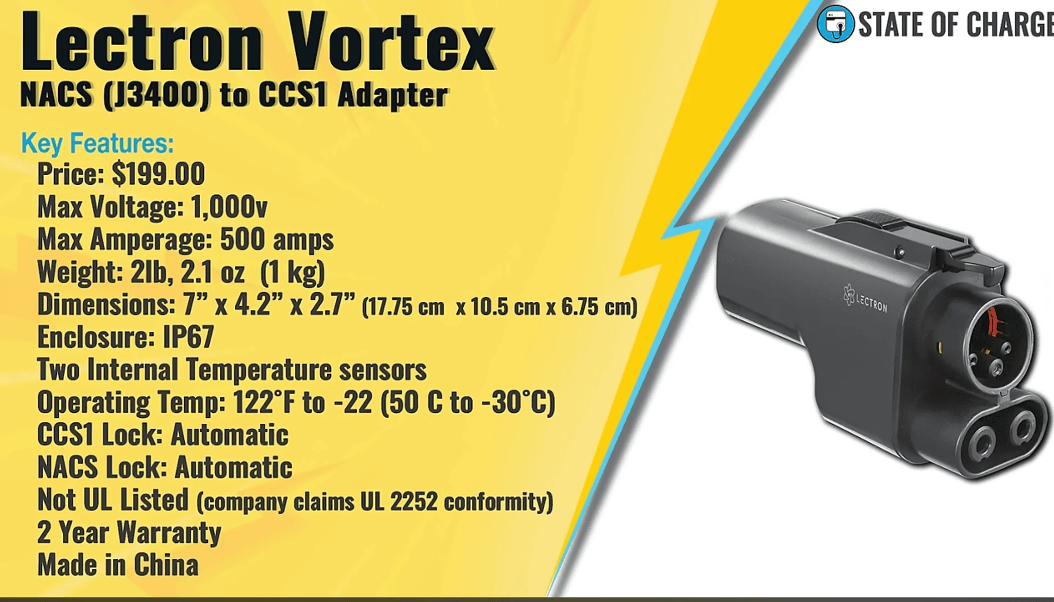

So Lectron is IP67 in case you need to use a Supercharger that is 1 meter under water. I managed the development of a product that had to meet IP67 and the test to verify the 6 dust rating is a pain in the ass and I would be surprised if Lectron actually did it. There’s no benefit anyway, I really don’t care if some dust makes its way into my adapter. IP54, 55, or 56 are plenty for this application.
Just curious, what is the testing procedure to determine the IP rating? Is third party involved in testing? Will the construction of the A2Z adapter changes in the next two hours or just the website text?
I do have to mention, I could not find IP67 on Lectron website. That screenshot is from state of charge YouTube video. Min 3:08

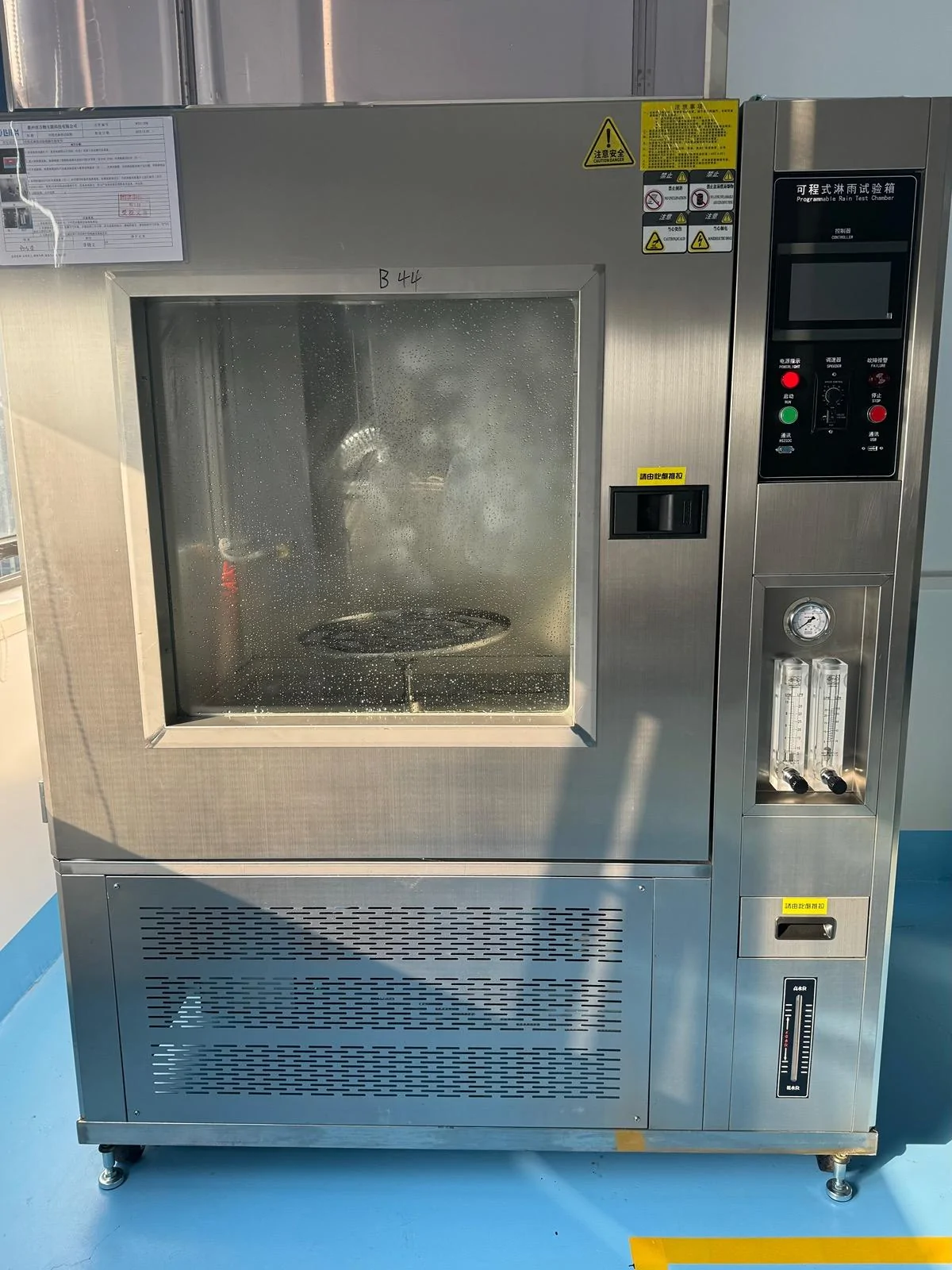

Ford F-150 Lightning A2Z NACS adaptor review by State of Charge FullSizeRender
This IPX test chamber that we own allows us to test the IPX and rate it according to international standards and procedures. The adapter will not involve any changes, only websites description.
