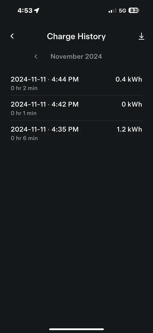

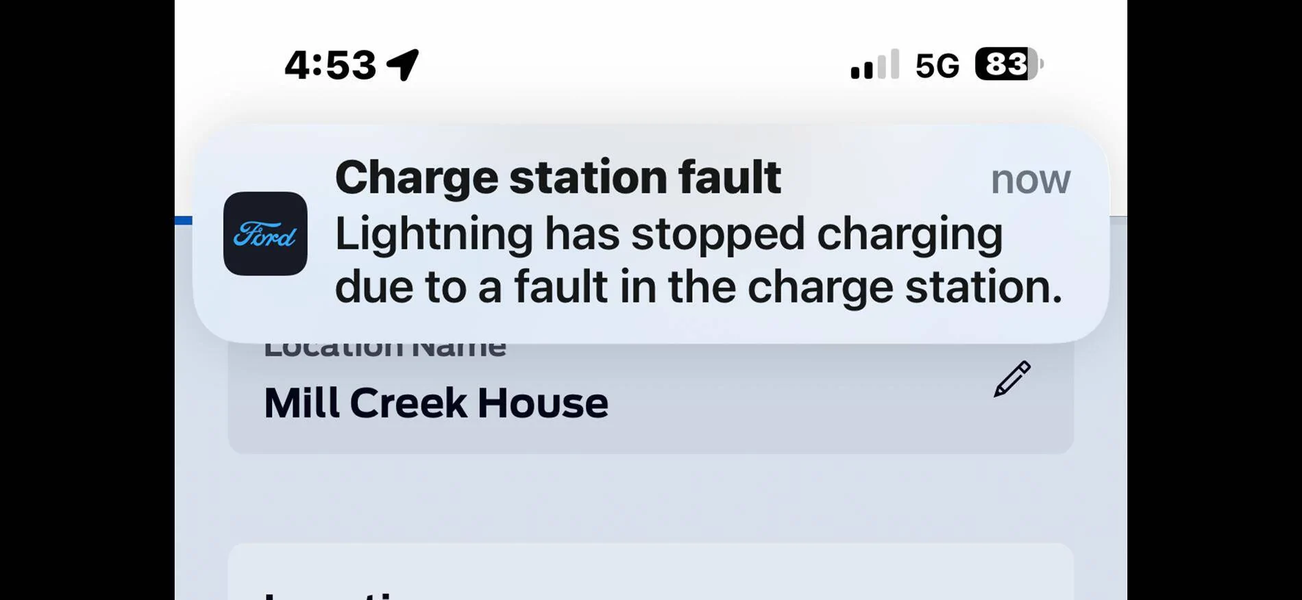

I just received a new A2Z NASC to J1772 adaptor. My Lighting faults out after 2 minutes due to overheating. I'm using this on my Tesla Wall Connector hardwired to a 60 amp circuit.
One of the 2 top pins at the NACS side of the NACS to J1772 gets REALLY REALLY HOT. The charge output slows quickly and after 2 minutes the charger STOPS. Lightning APP sends a Charge Station Fault error. It happened 4 times in a row. Using my older $54 Amazon adaptor it works fine. https://www.amazon.com/gp/product/B0BZ4F3GM5/ The only reason I ordered the A2Z was the latch on the Amazon adaptor is sticking. My old inexpensive Yeekue adaptor has added 8kWhs in 49 min and still is going strong. Tesla app is showing a constant 11.7 kW output

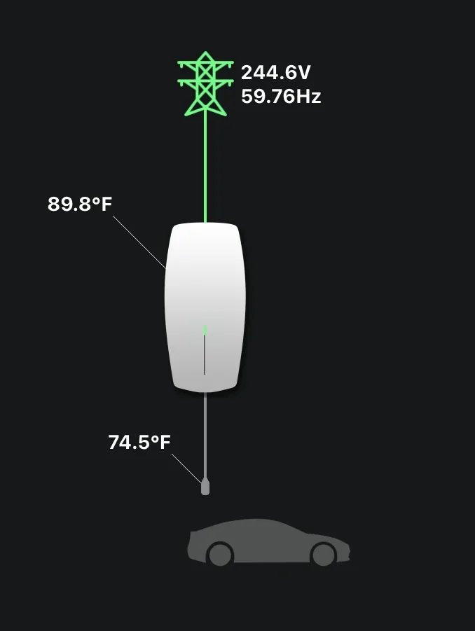

I strongly suggest you download “Wall Monitor for Tesla” App from the iOS App Store (don’t think there’s an Android version). If you have a Tesla Gen3 Wall Connector, this is a must-have: it will reveal the internal state of the charger, including graphs of voltages and currents, in and out, and most importantly, handle temperature and circuit board temperature (including graphs over time). Might help you to decipher what’s happening.

WOW!. Didn't know that this app existed. What a great tool THANKS! I paid for the Premium upgrade. Real cheap for what it does.
The App couldn't find the Wall connector on the network using the search feature. I manually entered the IP address for the Connector and it immediately displayed info.
Exactly the tool I need. Tomorrow I will charge the Lightning with both adaptors and report the temps. I can tell you that one pin at the handle BURNT my finger when the other was only warm to touch. Obviously a high resistance contact at the pin on the handle.
Here is what t showed tonight when Wall Connector was idle.

“Live Charts” is also a really useful feature. Only limitation of this app is that your iOS device has to be connected to the same router/network as your Wall Connector (it can’t access your Wall Connector remotely over the web, only locally). Perhaps some network settings magic (port forwarding? static i.p. for Wall Connector?) might accomplish remote connection, but that’s beyond me.
