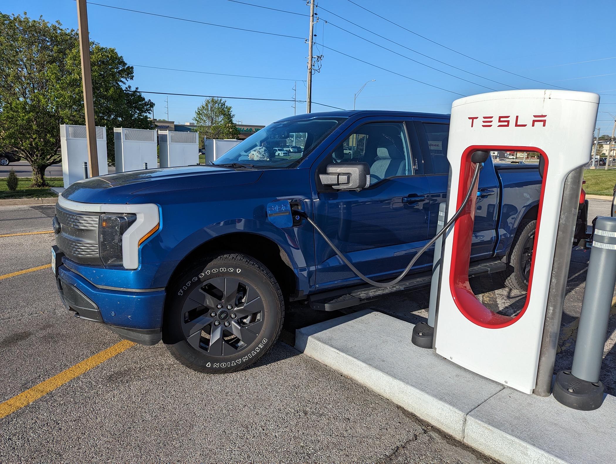

The locking switch can be a bit finnicky, and the Tesla plug is a tight fit. The locking switch won’t lock if it’s not slid all the way in, and I sometimes force it in by slapping the end of the adapter. I sometimes had to slap the adapter all the way onto the Tesla plug, but it consistently worked on my recent road trip. I got to the point where I’d activate the charger with the Tesla app, plug in, and walk away knowing that it was gonna work.
I’m real happy with the quality of A2Z’s adapter. I’m thinking about ordering their Level 2 adapter because of how well they seem to build their hardware.

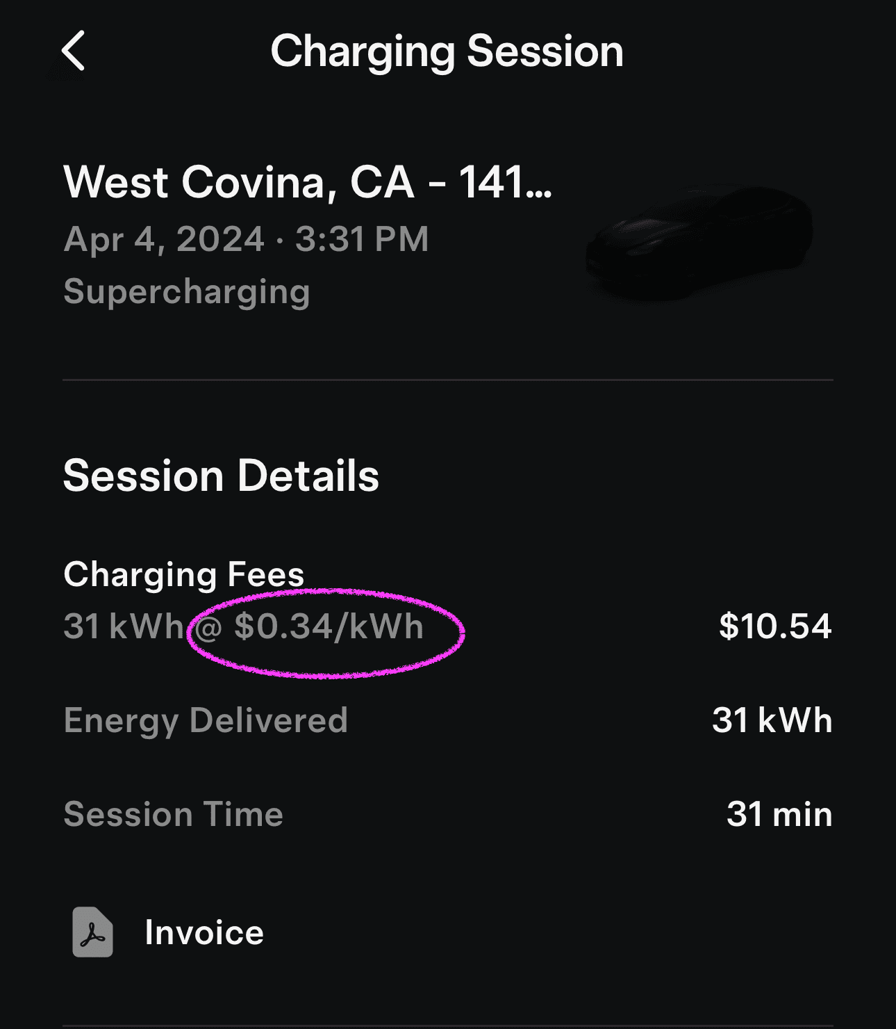

I have a Tesla membership and saves me $0.15-$0.23 per kWh over the regular non member rate.
Just 2 charges a month and it pays for the $12.99 monthly membership.
Takes a few more seconds using the Tesla app, but you would select the charger number, then plug in.
Loving my A2Z adapter - charging flawlessly at all Tesla SC for the past month.
