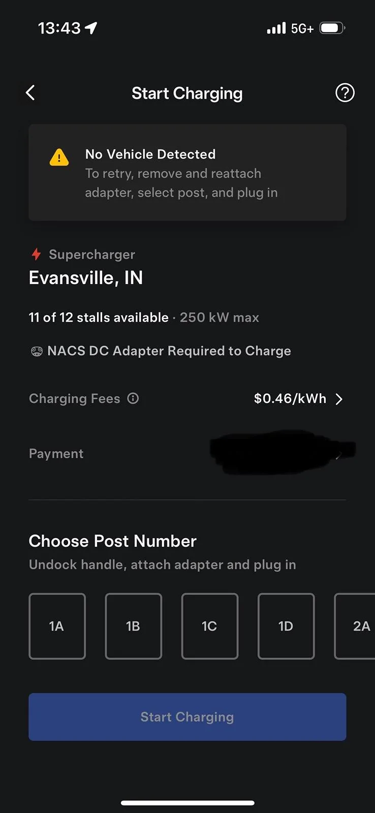

I just had this same issue, but even using the the Tesla app didn’t work. Were there any other possible fixes? Tried to call the number but it was after office hours. I was hoping to have this figured out before heading back to Texas next weekend, won’t have access to another Tesla supercharger station until I hit the road on my road trip. I’m on 6.2.0 of that matters. Btw I repeated the steps at least 15 times, and the adapter seemed pretty well seated for after a few tries… unless it’s still not enough. I also tried three different units. Just picked up the truck from the dealer with 98 percent charge so I don’t know if that could have made an impact. I’d also note that I have successfully charged on a magic dock charger before.
So for steps you:
selected the charger in the Tesla app
connected the adapter to the Tesla plug
secured the lock on the bottom
connected the adap to the truck
If so, I think it’s the lock at the bottom that’s your issue. I just completed a 1,200 mi trip using Tesla chargers and the A2z adapter and I encountered multiple charger faults until I figured out the bottom lock.
I now make sure the lock is fully forward, then insert the Tesla plug, pull the lock back toward the Tesla plug. I then hold the adapter and Tesla plug and plug in to the truck while simultaneously ensuring the lock remains fully engaged.
If you hear the audible latching of the truck, you’re going to be successful. If not, you get a charger fault.
The first 3 stops I encountered multiple faults before getting it right. Something clicked and after that I’ve been able to get it on the first try.
The lack of a positive lock (I.e. push in and click) is the Achilles of the A2z. Other than that it’s a great adapter and has worked perfectly thus far.
