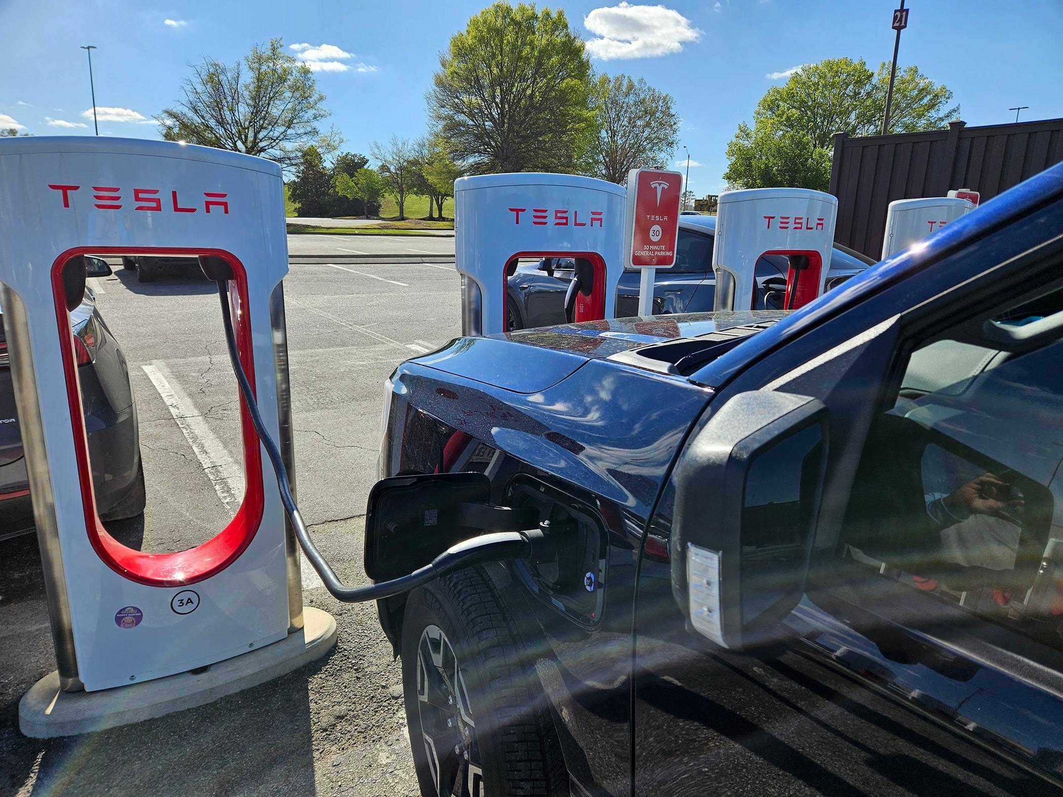

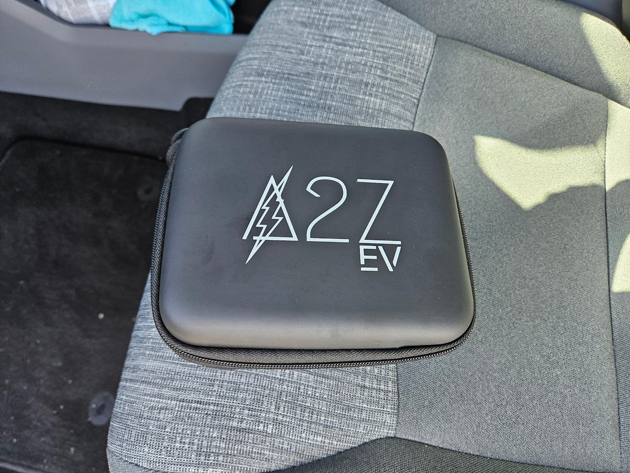

I just charged at Tesla using the A2Z adapter and everything was flawless - plug and play, peak of 165 kw charge speed. I had to take 2 spots, but it was not full.
This is a game changer for traveling.
