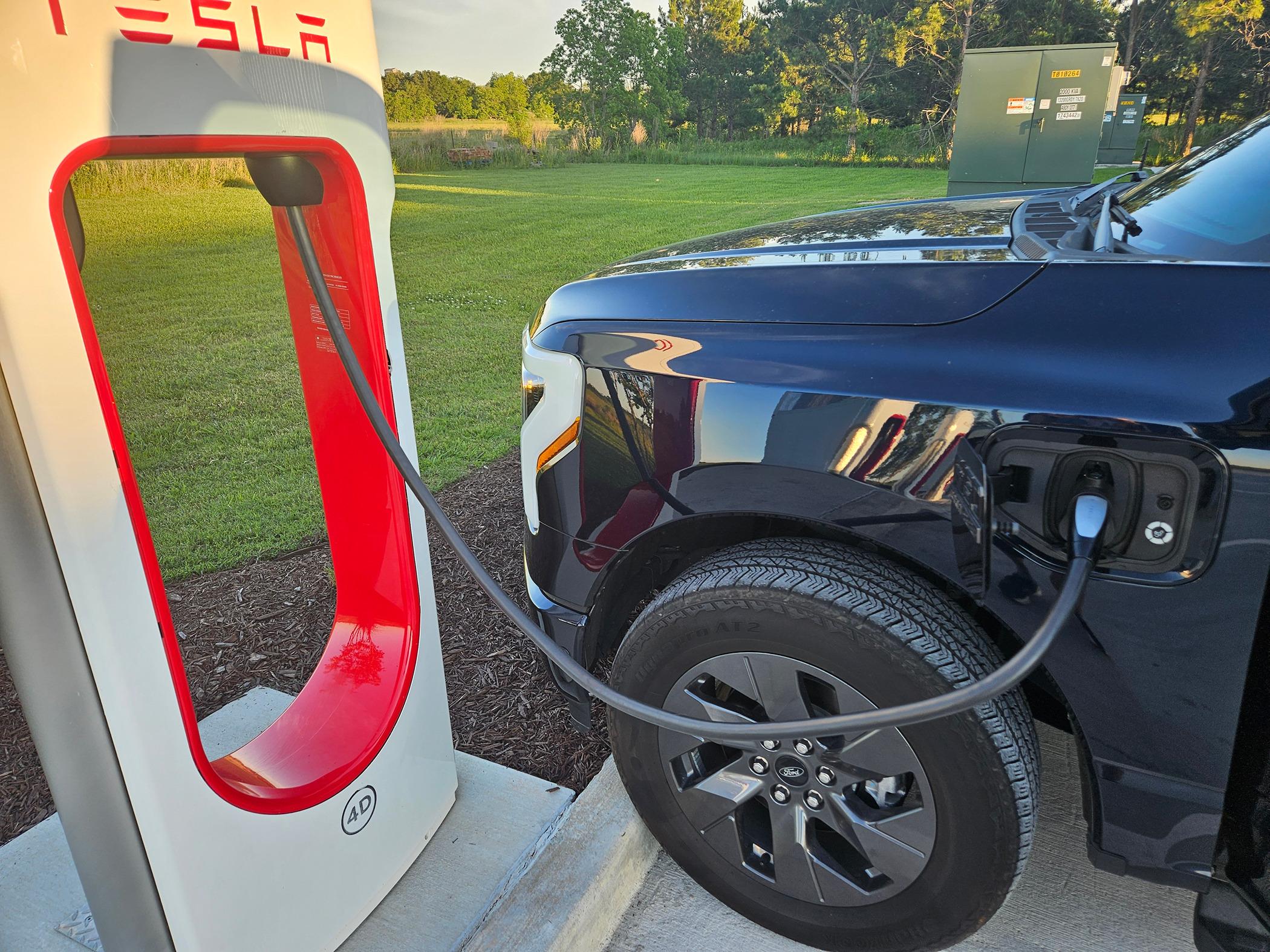

We found a temporary solution. I'm holding the cord so the tension doesn't pull it forward. We don't know exactly why, but I think the short cords may have damaged my charging port. I'll try a CCS station in an hour and report back. If I let go, it will fault out.

For reference, this is how far forward I am and how much tension is present. I let go slowly and it seems to be working properly now.
Lateral tension has caused faults for me before at CCS chargers. I'd definitely recommend your pulling further forward next time. You have lots of space.
The short cables are an issue for a variety of reasons, but this is a big one. Glad you got it working!

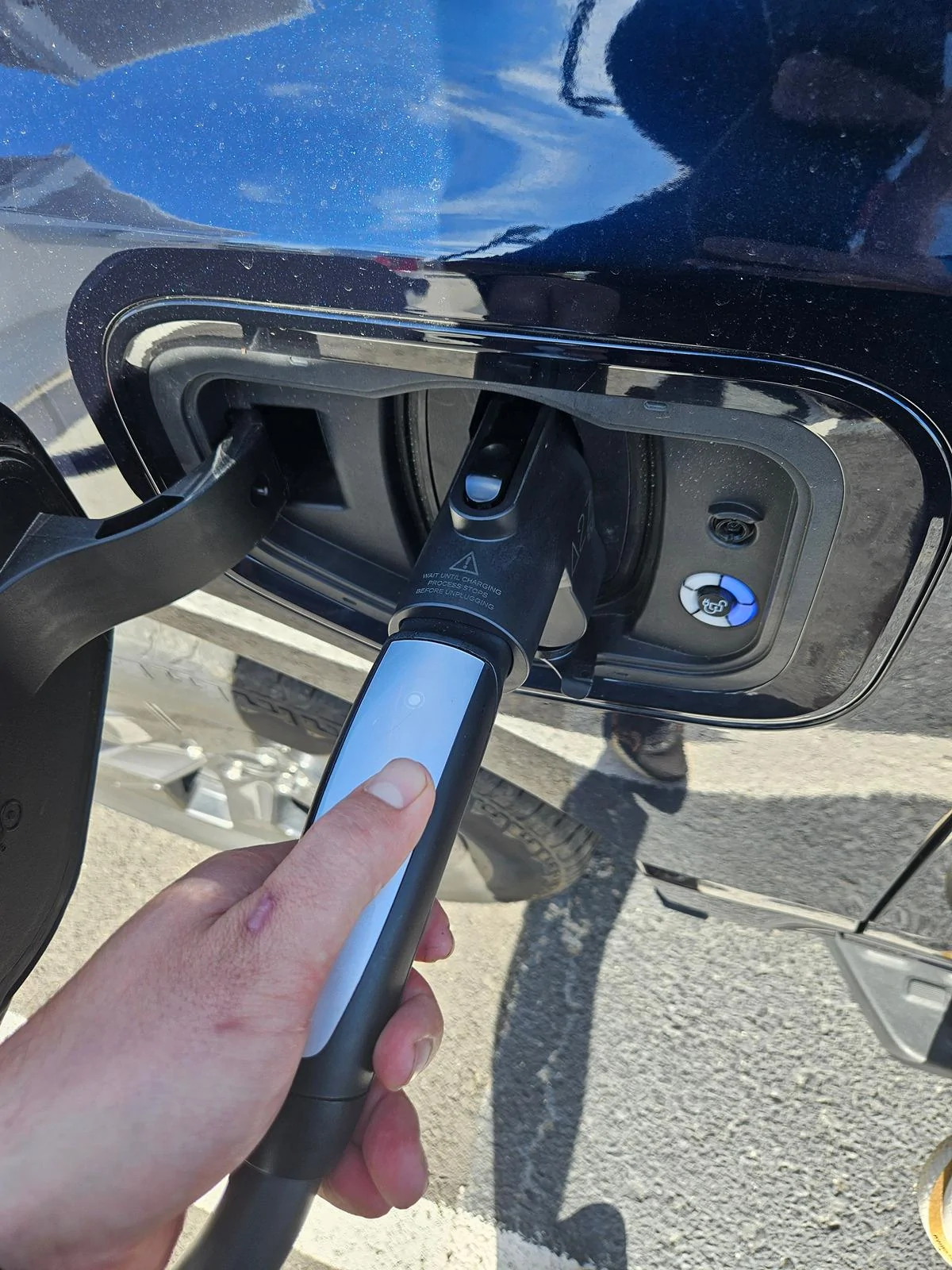

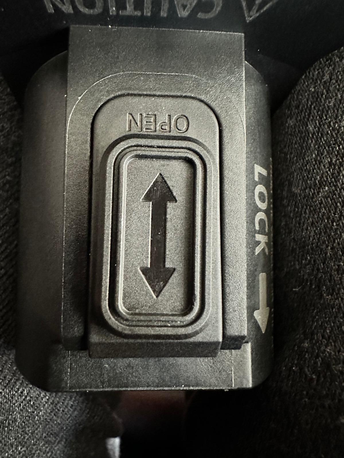

UPDATE:
Problem solved. The locking mechanism was very very tight, not going into the full lock position.
Thanks to Amir from A2Z for taking time on a Saturday to trouble shoot the problem. As I use the lock more it seems to work great.

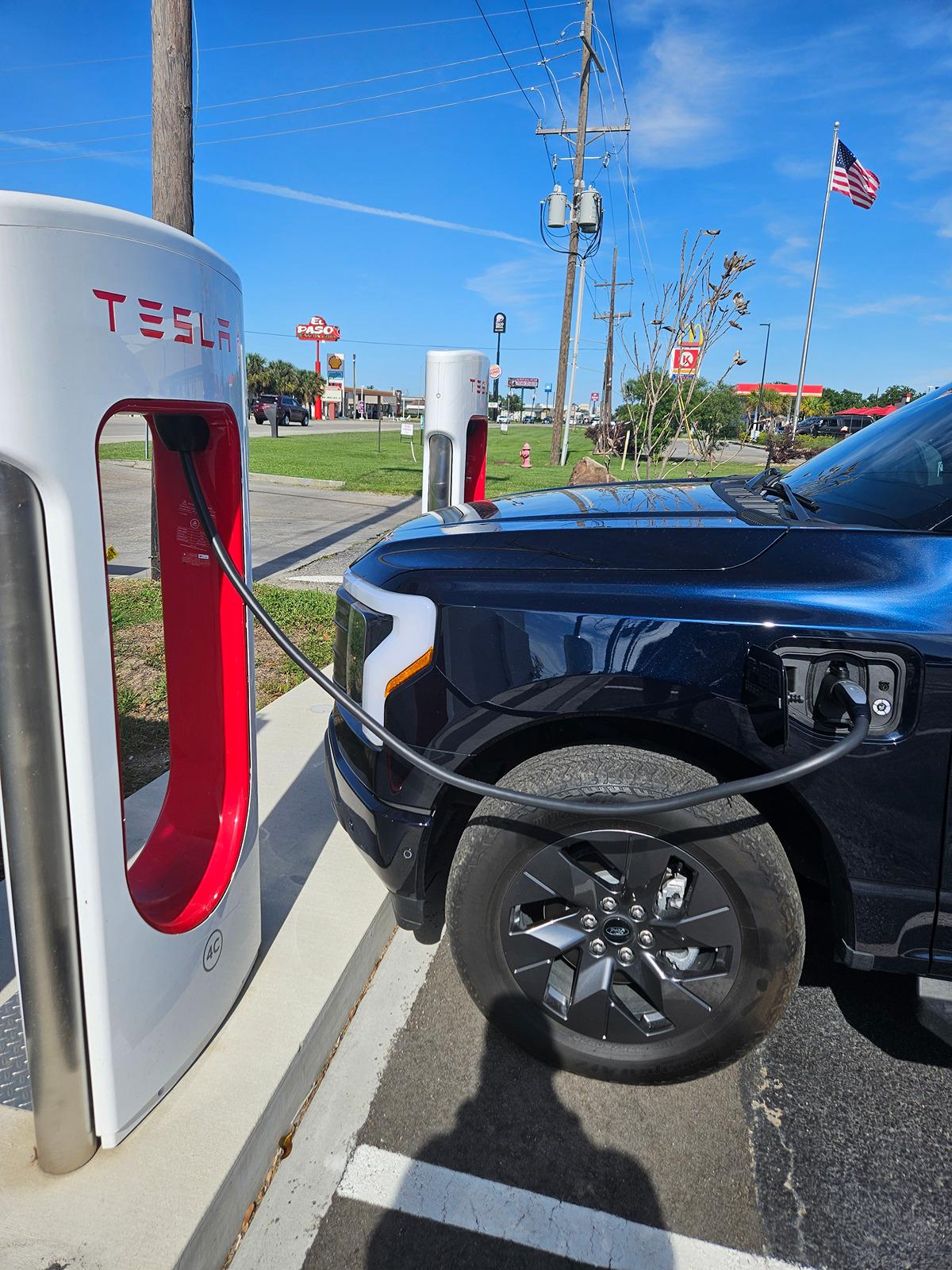

I'm driving solo so it's hard to get super close since I don't want to also hit the charger. I hear you though, at my next stop I got even closer.
That said, it would fail even if I held it. It would start up for a second and then fail. I popped over to the nearby EA CCS station and it plug n charge'd on the first try. A2Z and I are talking, if they agree I can send them my adapter back and take a new one. Maybe there's something uniquely wrong I encountered? Talk about bad luck though lol, they mentioned on the phone they've never seen an issue like this before.

UPDATE:
Quote Reply
I’m glad to hear you got it working! I quickly learned to check the lock position before plugging in, and the tight fit makes it easy to partially seat the Tesla connector into the A2Z adapter.
If you can’t see the entire OPEN label, it’s not far enough in to latch. Sometimes rubber grommets from a Tesla charge port can stick into the Supercharger handle and prevent seating. If you absolutely can’t get it to seat, try its neighbor.

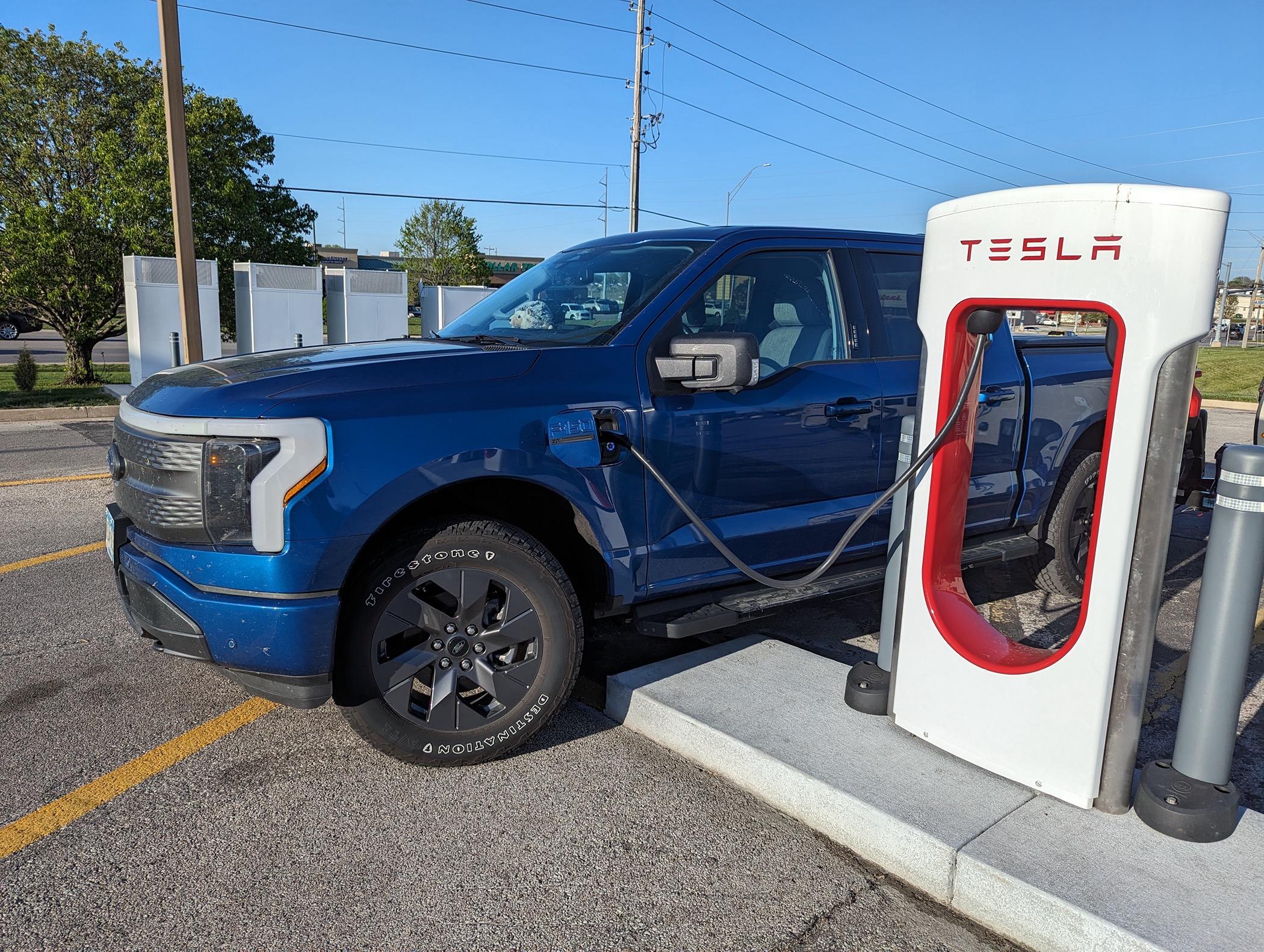

Turn on 360 camera, then pull forward until tires touch curb. I did that when I charged every time.
I’ve gotten into the habit of putting the nose to the right of the Supercharger unit so I can’t hit anything. Sometimes I have to touch the curb, but it all depends on layout.
Ford F-150 Lightning A2Z Tesla and Charge Fault PXL_20240403_161549708_Original

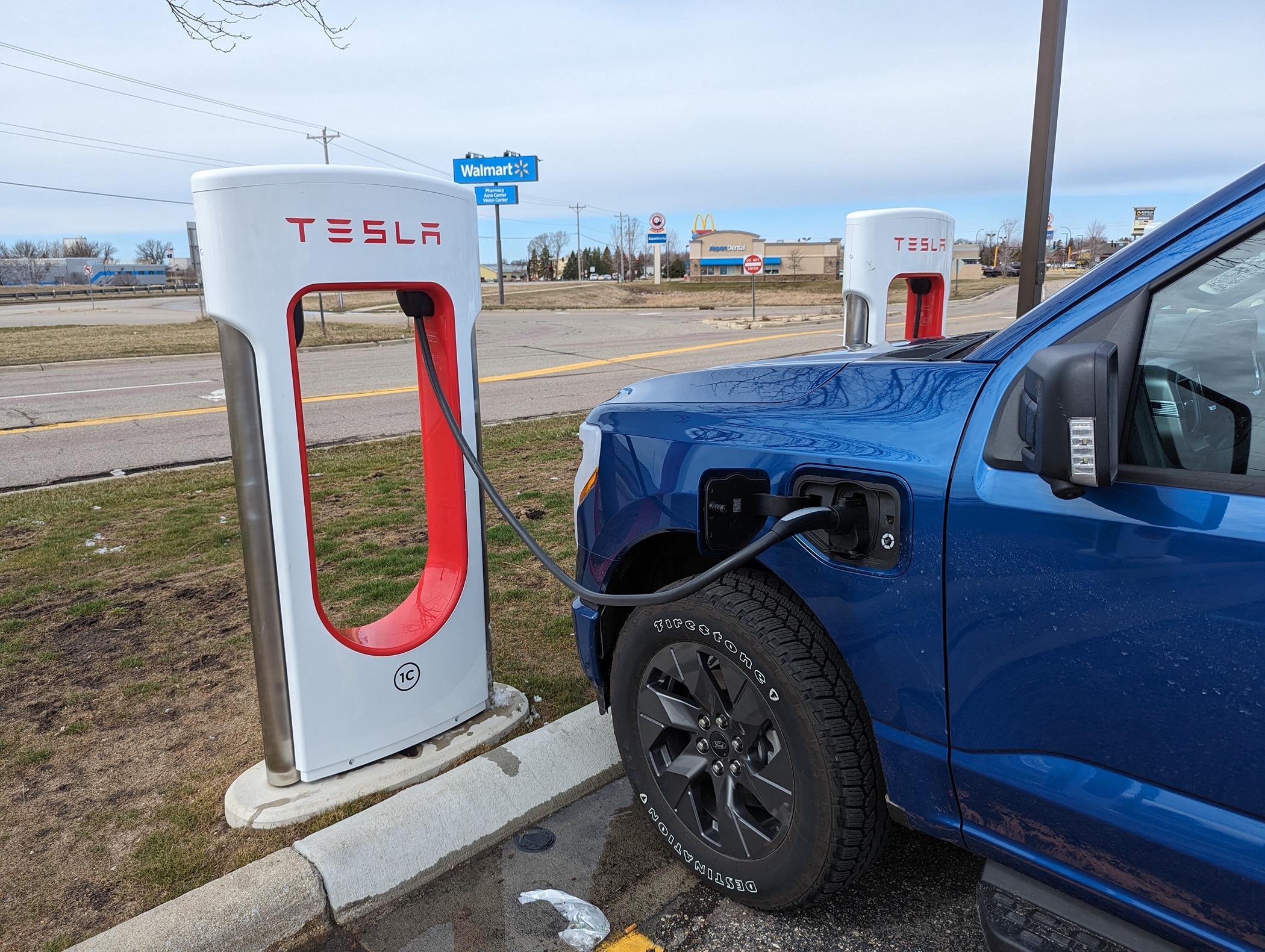

And you’ve gotta get creative pulling a trailer.
Ford F-150 Lightning A2Z Tesla and Charge Fault PXL_20240412_232448769_Original
Yeah, I nosed between the two chargers.
At one location, I simply drove up the sidewalk behind them.

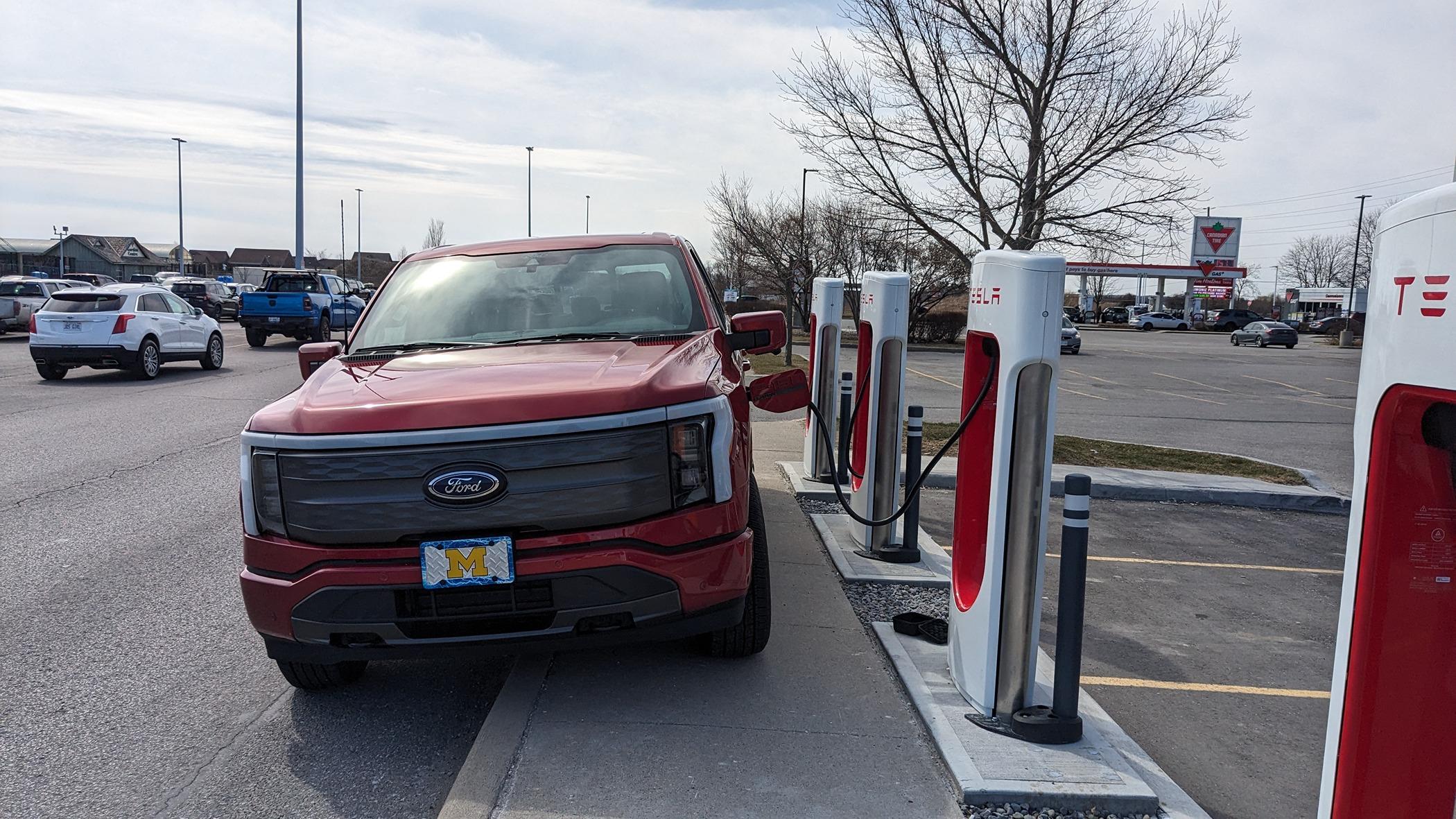

I’ve thought about that, but I’m concerned about causing damage over the long-term. Our Lightnings are some of the heaviest light-duty vehicles on the road, so I try and stay off curbs and grass. That’s probably a better option than taking up two Supercharger spots at a busy site, though.
