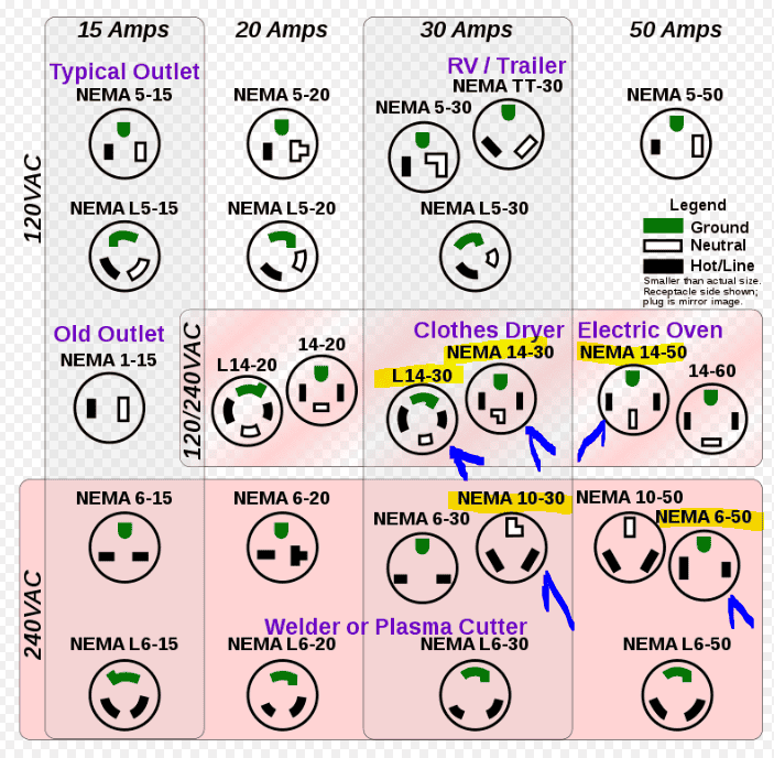

Here is a post I made last August. I haven’t used most of the adapters but it’s nice to have them when going to a place where you don’t know the available source of power.
I ordered the following off of Amazon: I think I spent about $240.
14-50 Extension cord (figure if I'm borrowing some 240v power at someone's home I may need an extension cord to go from a laundry room through a garage.) This extension cord has 6/3 wiring in it so it is truly rated for 50 amps. There are some others with 8/3 wiring which would work for 30 amps but not 50 amps.
RVMATE 50 Amp 25 Feet RV Power Extension Cord, Easy Plug in Handle, 14-50P to 14-50R
If someone has a 50 amp welder outlet then this adaptor is needed. It is the one adaptor that the TFL crew was missing on their Alaska trip and caused them recharging issues in Coldfoot.
ONETAK NEMA 6-50P to 14-50R 240V Compact 50 Amp 3 Prong Male Plug to 50 Amp 4 Prong Female
For an old 30 amp dryer outlet this adaptor. (probably the least likely to get used).
RVMATE NEMA 10-30P to 14-50R EV Charger Adapter Cord, 30 AMP to 50 AMP EV/RV Conversion Adapter
For a newer 30 amp dryer outlet this adaptor.
RVMATE NEMA 14-30P to 14-50R EV Charger Adapter Cord, 30 AMP Dryer to 50 AMP EV/RV Conversion Adapter
For the F-150 240 volt outlet in the bed of the truck. Or from a 240 volt welder/generator.
13 Inch 30 Amp to 50 Amp RV Generator Adapter Cord with Handle, 4-Prong L14-30P Twist Lock Male Plug to 14-50R Amp Female
I also got this adaptor which probably isn't necessary for most but I also have a NEMA 6-50 extension cord for my welder so I figured if I needed extra extension then I could use it with both adaptors.
ONETAK NEMA 14-50P to 6-50R Compact 240V 50 Amp 4 Prong Male Plug to 3 Prong Female Receptacle Generator Welder Dryer EV Charger
Finally not pictured,
- I have a 100 foot 10/3 extension cord which is good for a full 20 amps of 120v. I've owned this extension cord for quite a while so not part of the first aid procurement.
- I added a Li-Ion Jump Start battery booster to the truck as well.
I did not include an NEMA 10-50 adaptor. That would be an old oven plug in. I figure the odds of plugging into an oven outlet are pretty small.
The TFL truck folks kept trying to use a NEMA TT-30 (120 Volt RV outlet) to NEMA 14-50 adaptor. It of course never charged anything because it would only power half of the NEMA 1450 outlet.
I thought about a NEMA TT-30 to 5-15 120 V adaptor but you don't gain anything over a regular 5-15 plug and those are ubiquitous.

at one of my common destinations they have a 10-30 dryer outlet. Im a bit concerned about burning up the outlet if I just use an adapter as I’ve read the mobile charger will pull over 30 amps. Have you considered that or is that not a concern?
2,508
2,671
To be fair, the topic is on adaptors and not portable EVSE. That said, your point is 100% valid, we always need to know what power source we are plugging into and use the correct equipment for the job. (e.g. an adjustable rate portable EVSE so we don't blow a 30A dryer outlet).
