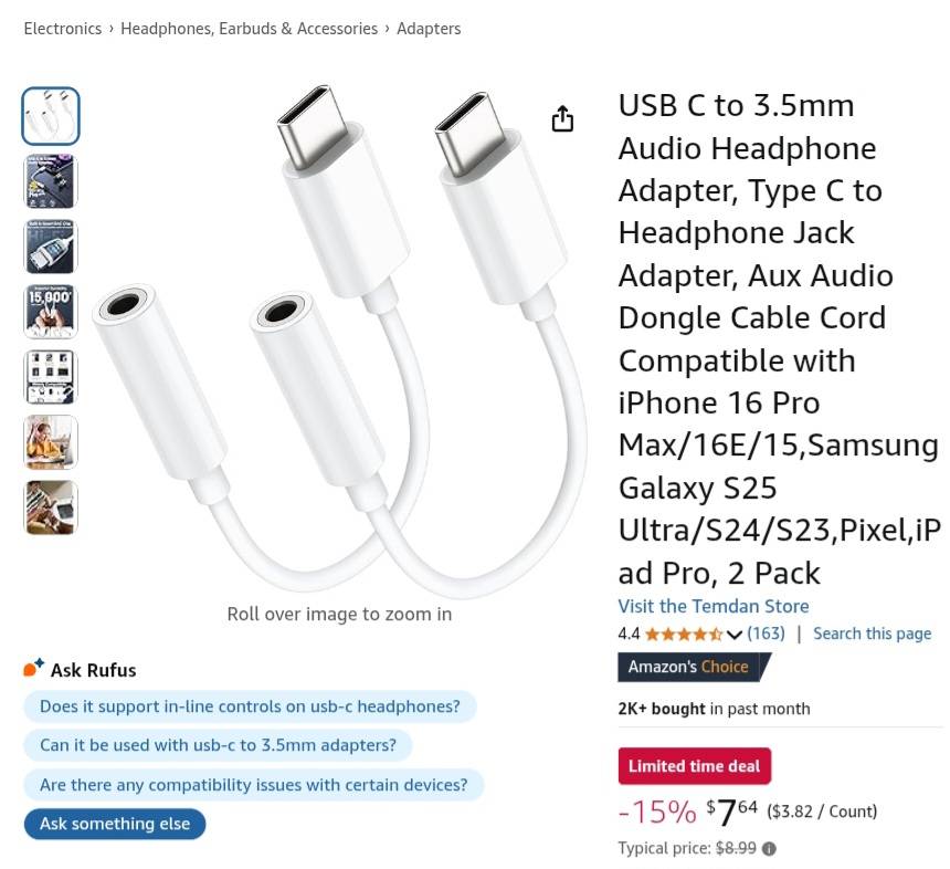

When Apple removed the headphone jack you had to use one of these. Not sure if it will do what you are trying to do though.
I think this dongle gives the iPhone an AUX out using it's USB-C, to use with a headphone set or anything with a headphone type plug.
But since the Lightning doesn't have an AUX input jack, this would only be part of the solution.
Would also need a way to get the AUX out audio signal into the SYNC 4 system of the Lightning.
I would recommend using an FM type transmitter and the FM radio tuned to an unused station rather than a BlueTooth type trnasmitter because the SYNC 4 BlueTooth has been problematic according to many posts - drop-outs, disconnects, etc.
I tried using BlueTooth to stream from one of my MP3 players and it was terrible.
When I switched to the FM, no problems.
FWIW
