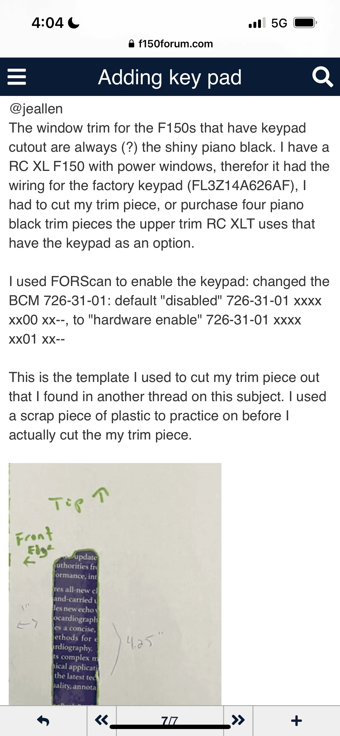

I have the matte cutout panel on order from tasca. Going to cut my current one, but wanted a pre cut one on standby I’m case I screw it up. As far as ForScan, these photos attached are what I have found so far!
I HAVE to have this mod, so just waiting on the trim panel. My 2009 F150 I used EVERY TIME. Keys never left the truck….never misplaced my keys in 14 years…haha

I found a two key procedure to get my code. I also found two settings, one in BCM that lists keypad. When I enabled it updated 726-31-01 xxxx xx01 xx—. I also found a keypad in APIM and I enabled that. It updated 7D0-01-02 xxxx x2xx xx—.
both of these I had written on scrap paper I had written down awhile ago.

Success! I pulled the door panel off again. I hooked up the keypad. i locked the door with the power lock button on door and entered my code and the driver door unlocked
