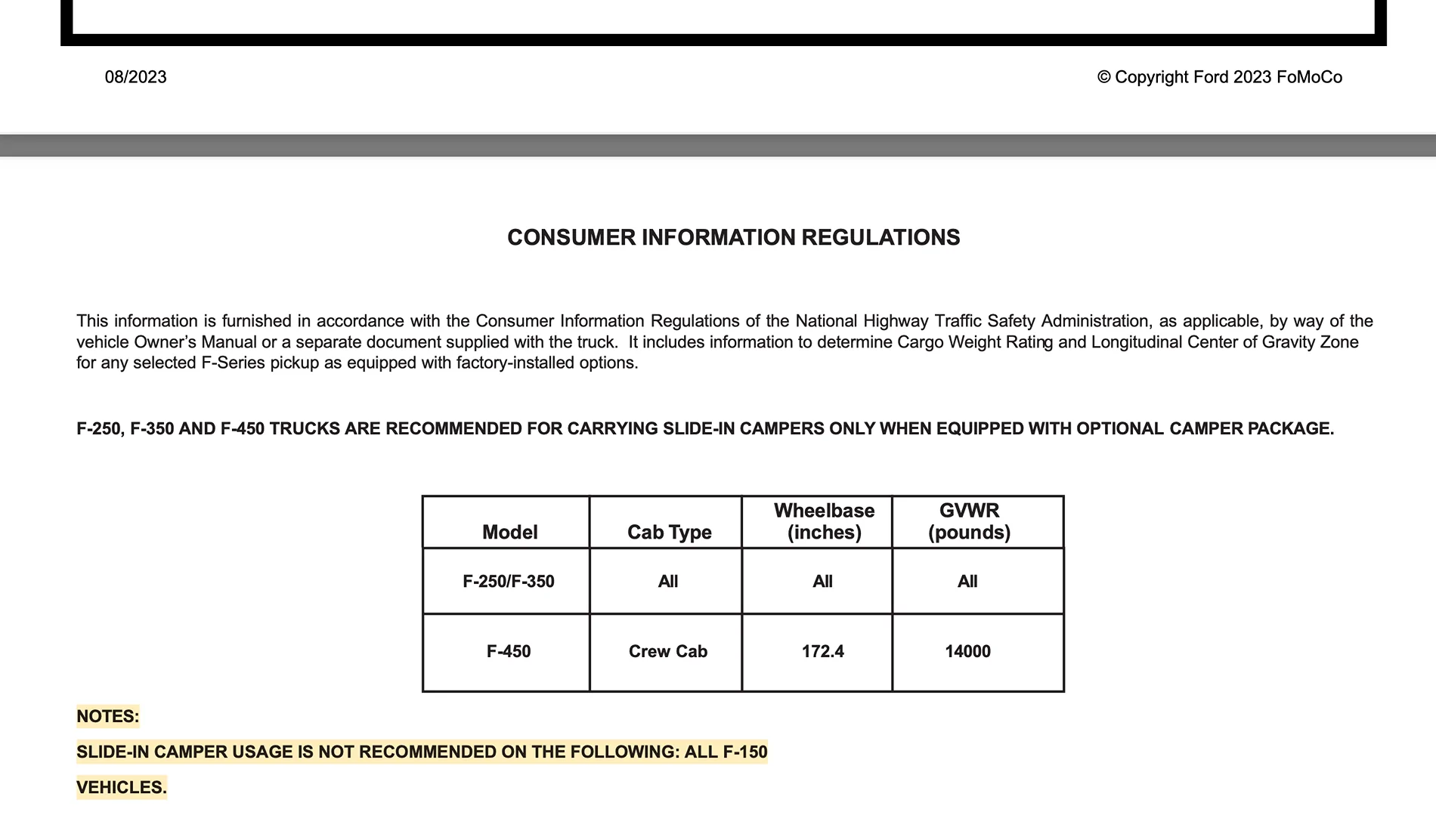

2022 lightning
Yes but they have a stronger frame, Ford even made a camper special back in the 60-70s on an F250.
Your truck so do what you want but don't cry when things start breaking because you didn't heed their warnings.
i own a camper special;)
Lemme ask a question, you cant put a slide in in a raptor or tow like a “normal” f150 right? Why? Its the rear springs! Put hd springs in a raptor and then you can do all the normal f150 stuff, however then it doesn’t work offroad. Airbags solve towing in a raptor, but then it limits the suspension droop and doesn’t work as well.
there is a workaround for raptor towing using long feet on aftermarket air bumps tho.
thats is what i am looking for, a workaround that make the half dozen heavy tows i do a year. All you WD hitch guys go start a club and stop lecturing, i get it, i’ve used them. I want another option
