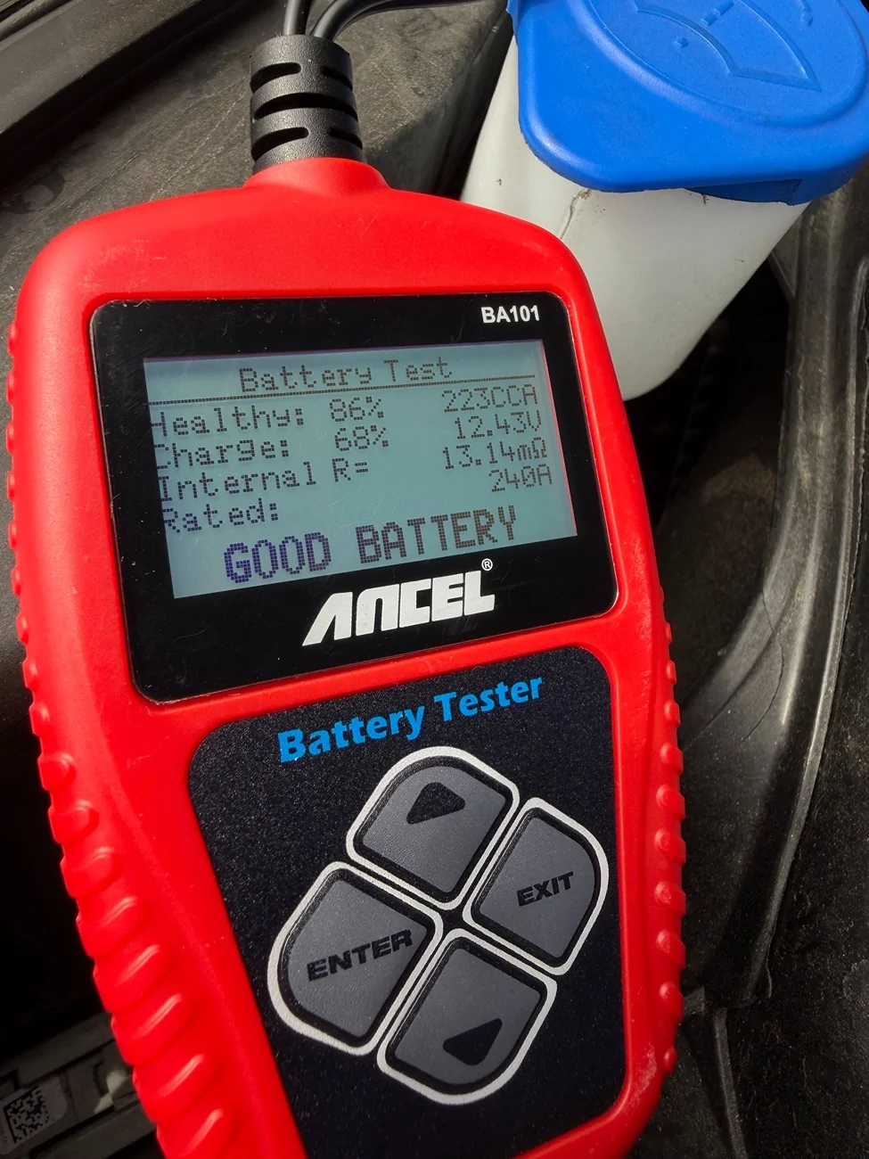

I have a 2023, I added to profile. Battery seems ok to me, I just tested. No rodent damage.
Ford F-150 Lightning Alarm randomly went off IMG_1088

With a 2023, if it is still the original battery, that would be where I would focus. Even though it seems to be testing okay, 3 years seems to be the breaking point for our batteries. Weak 12 volt batteries tend to cause all sorts of weird random issues.

The more I think about it, I am leaning towards your 12-volt battery. You say you had to turn the truck on to stop the alarm. This makes me believe that once you turned the truck on, it activated the DC to DC converter which provided enough current to clear whatever error the low battery was causing.
Does your tester provide a load test on your 12 volt battery?
Not sure, I can check later. But yeah, I'm thinking it's the battery too.

If it's not too late for your battery, you could keep it on a maintainer when parked (overnight) to top it off. 86% is not a great place for an AGM lead-acid battery to sit for extended periods of time because then the sulfates could/will harden and become permanent on the plates.
