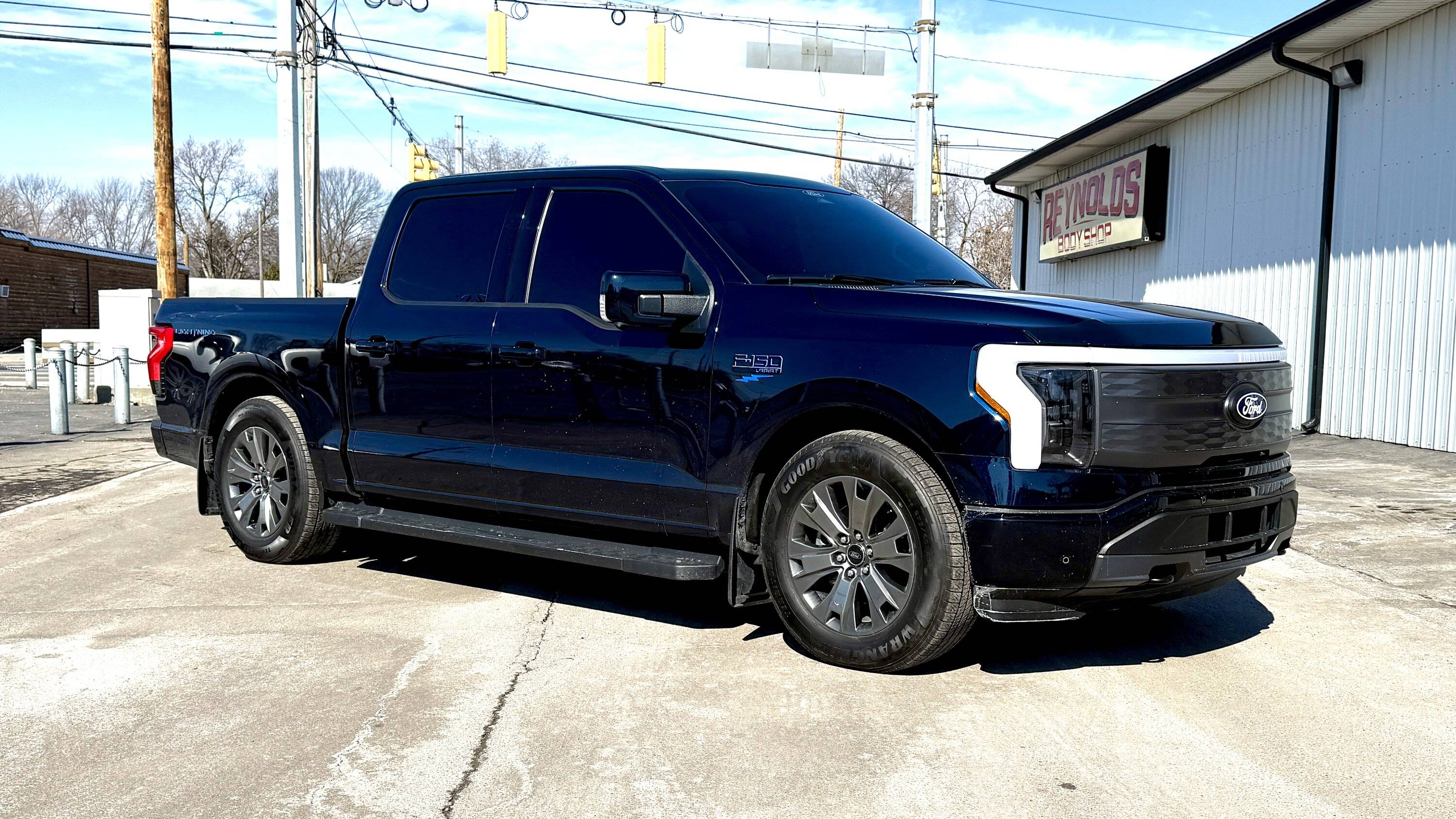

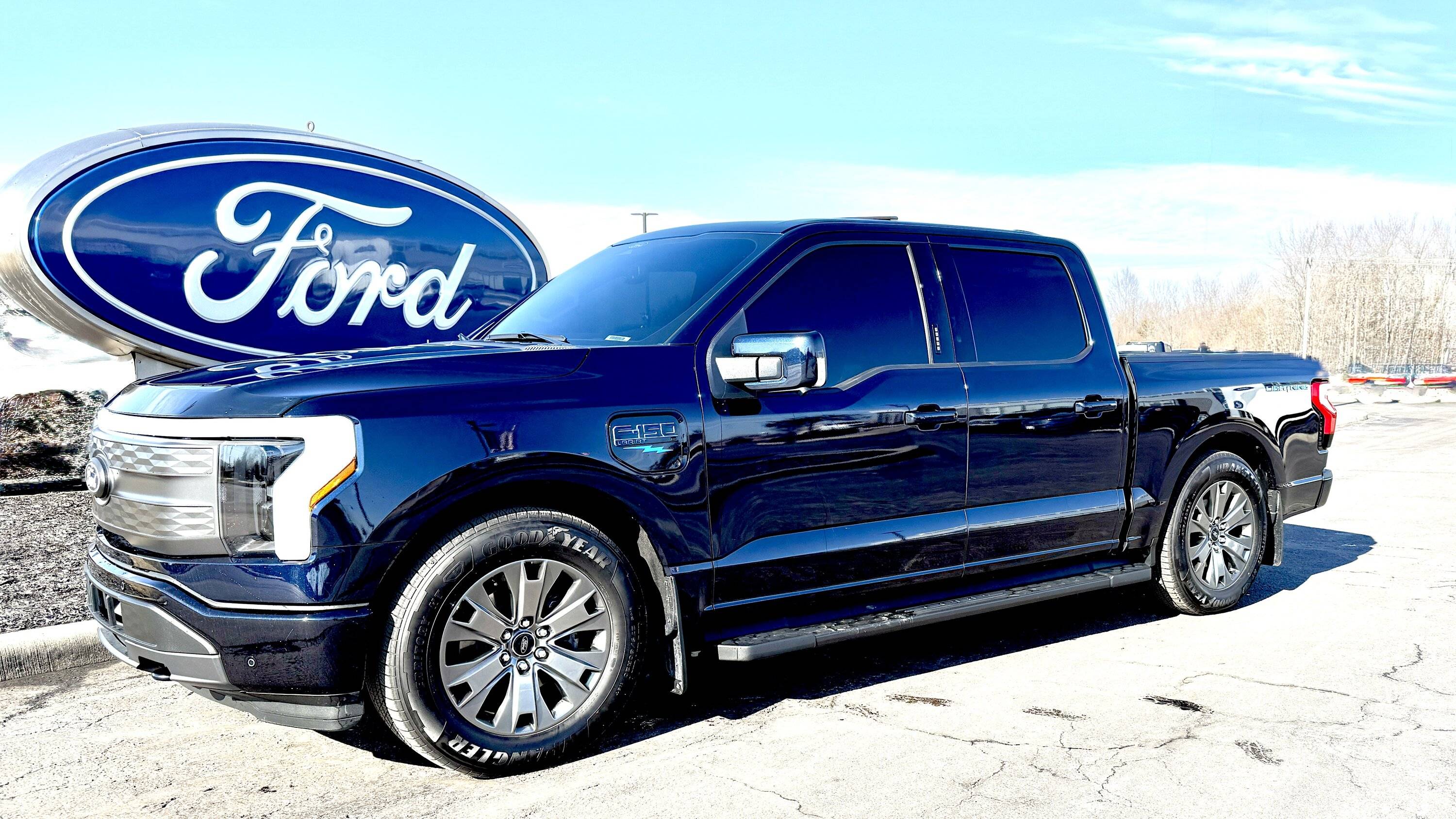

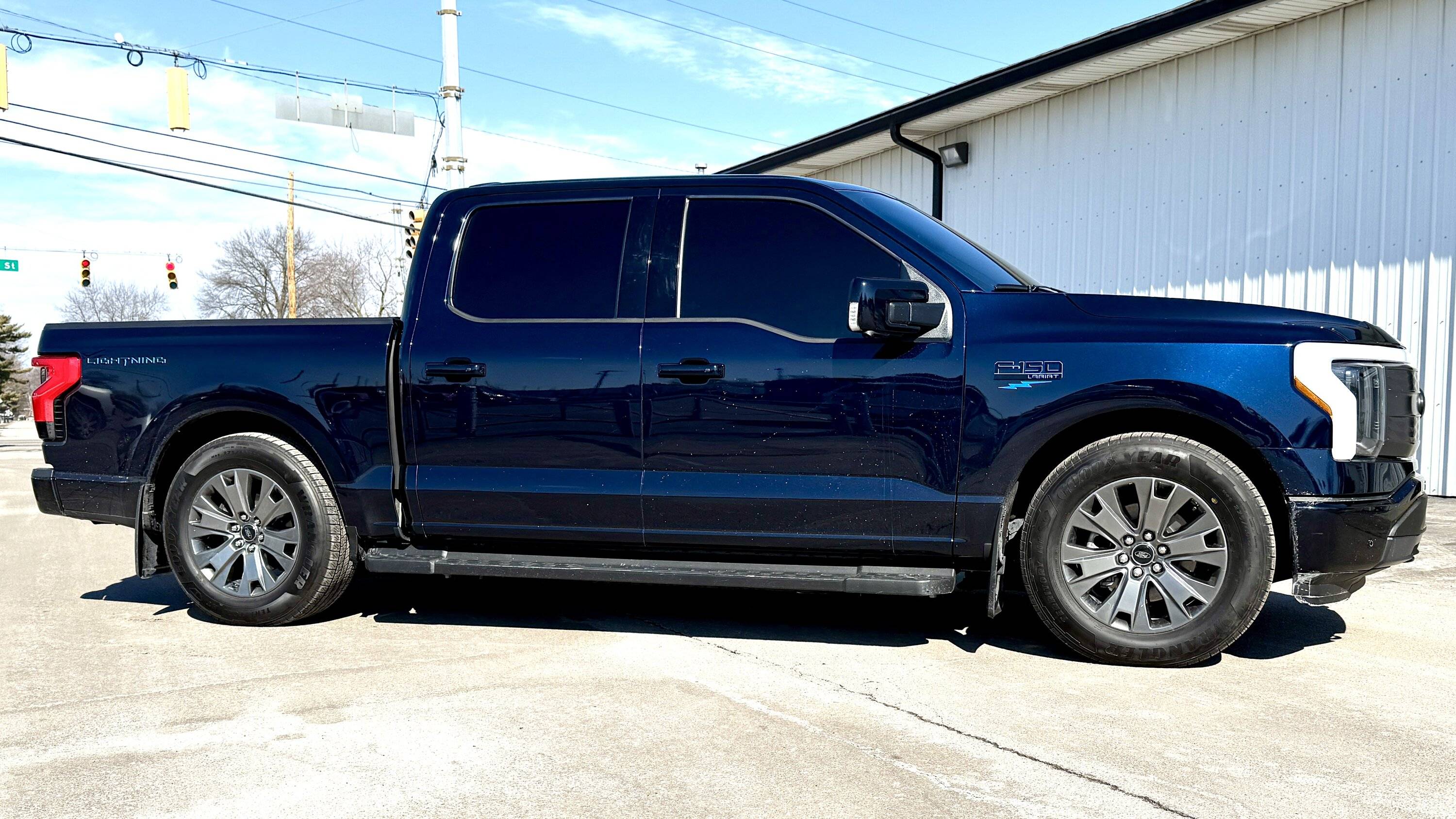

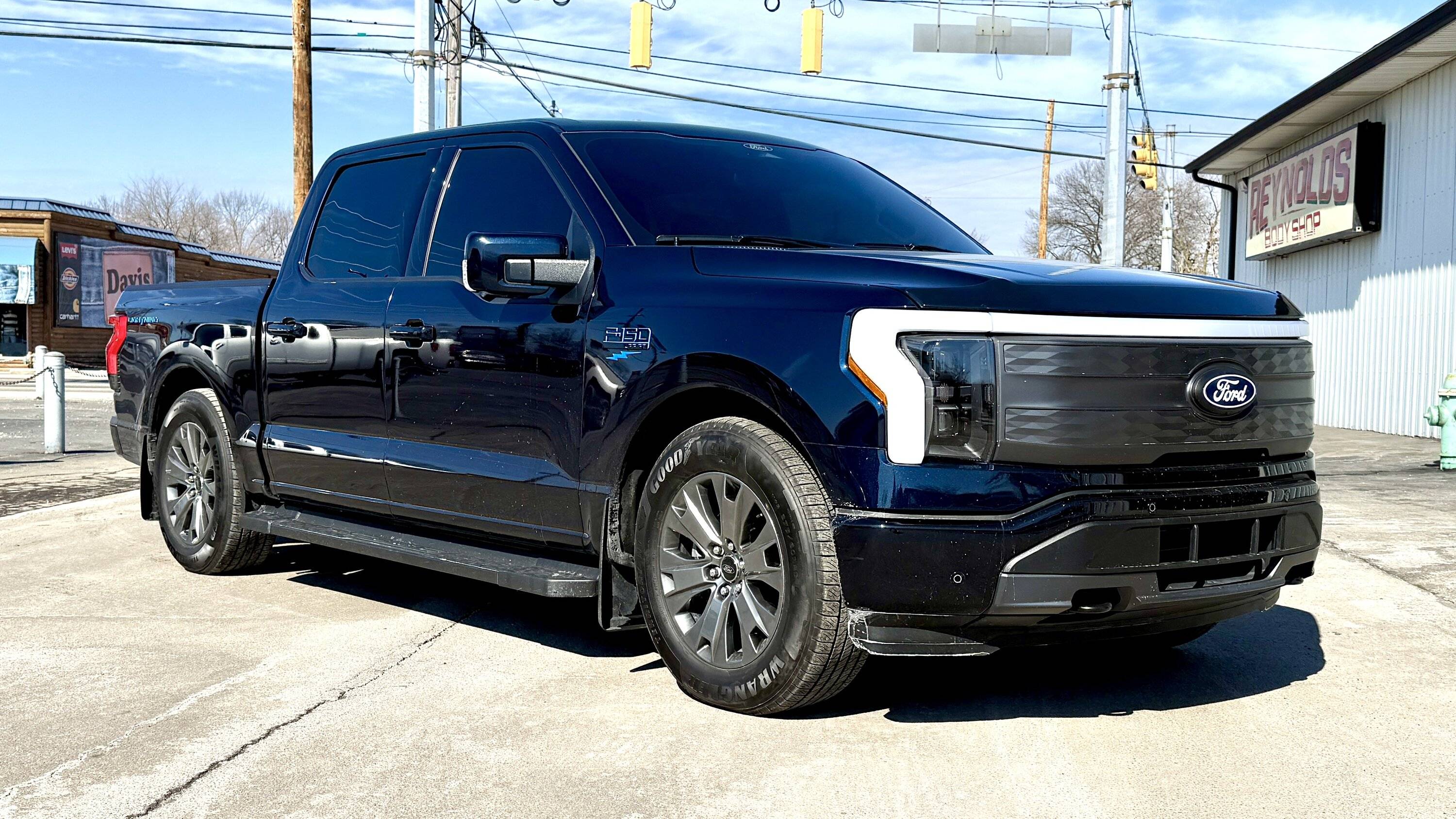

I’ve wanted to lower my 24 Lariat since the day I brought it home. Thanks to Spencer Owens ( Atlantic Built ) sharing his research and being so helpful via messenger I finally did it this weekend!
I did his exact modification but at his recommendation, I cut half a coil off of the rears to help relieve some preload on the springs and then I only lowered the front a little over 2 inches. Super happy with the leveled outcome for an every day driver.
I also added the ICON Dynamics camber adjustment kit. Pricey, but a great kit.
Definitely want to put wheels (probably 24’s) on it in the future but I’m perfectly happy rolling this look for a while.
