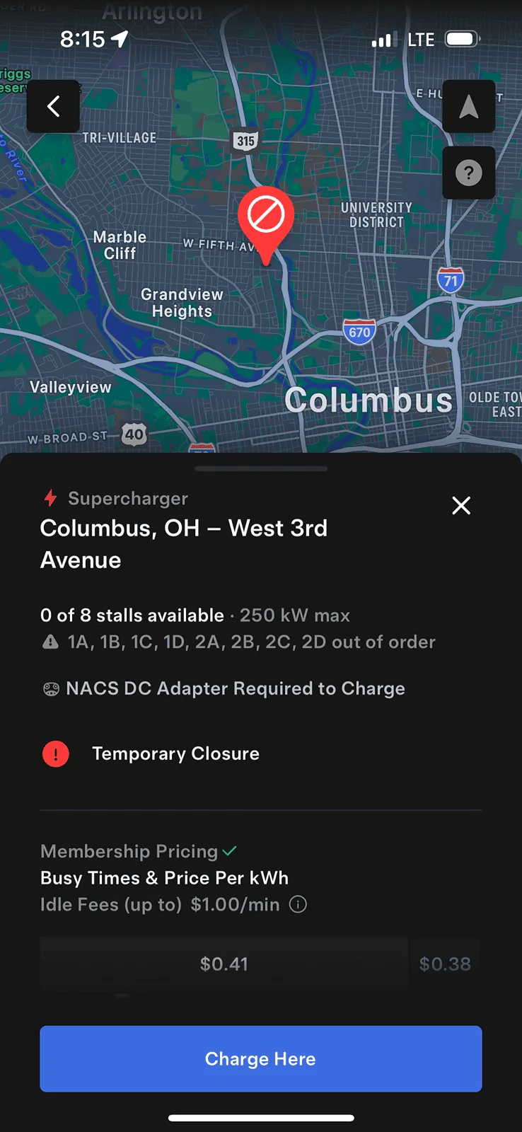

  • Check, the Tesla app even if you just charged at a location yesterday. See picture. This has happened to me twice now at two different locations.
Ford F-150 Lightning Any problems at Tesla Supercharger with A2Z? IMG_5189

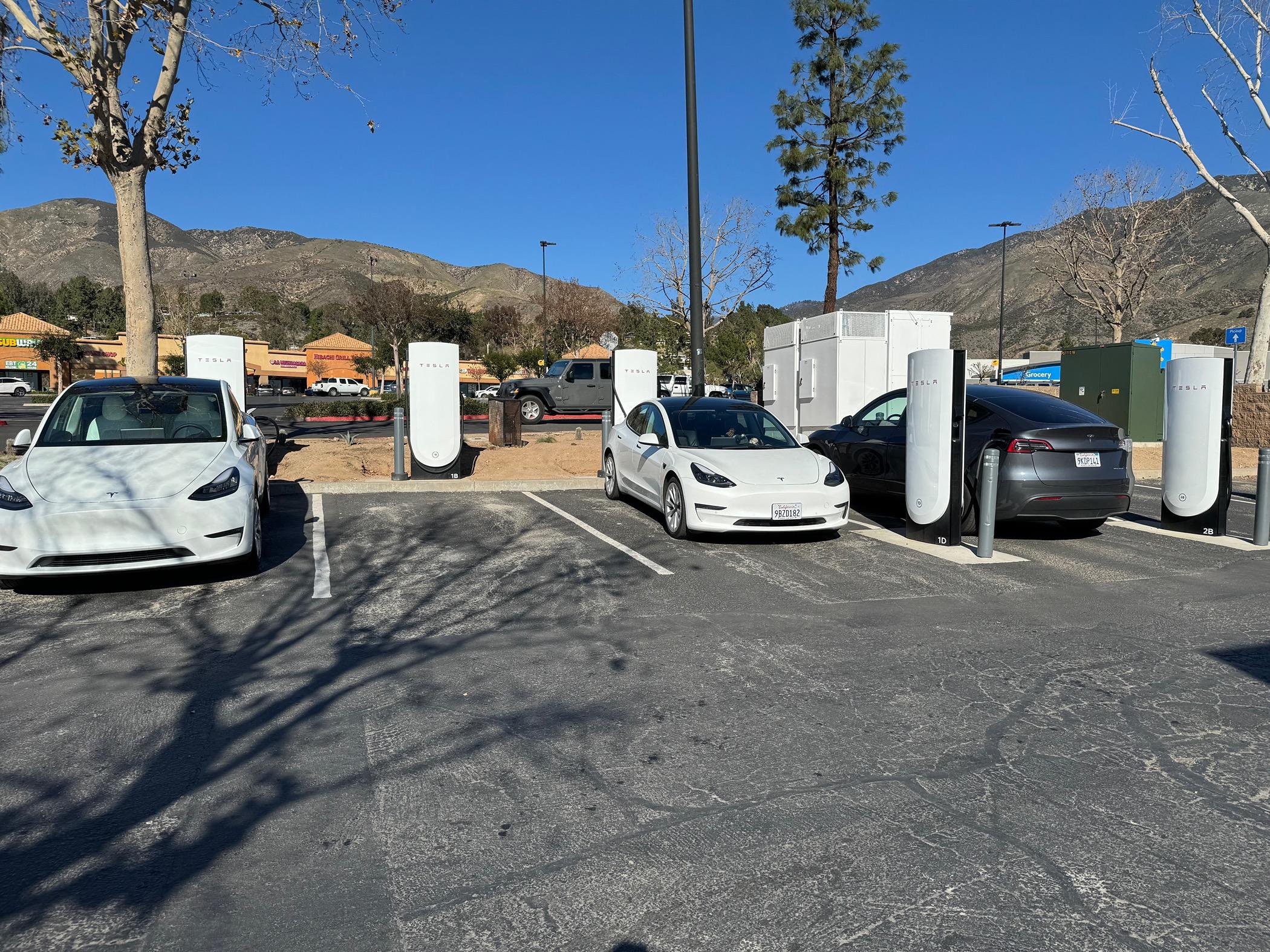

Here’s a pic of the V4 chargers (V3 power cabinets) I came across in S Cal. They’re all magic dock and you’ll see the pedestals are in the center of the parking spot. The cables are longer too. The location was horrible though. It was at the exit of a Burger King drive through so every 30 seconds someone was weaving their way through while trying to eat fries. trying to back in with a Lightning would be tight and towing and charging impossible
Ford F-150 Lightning Any problems at Tesla Supercharger with A2Z? 1716051198310-0v

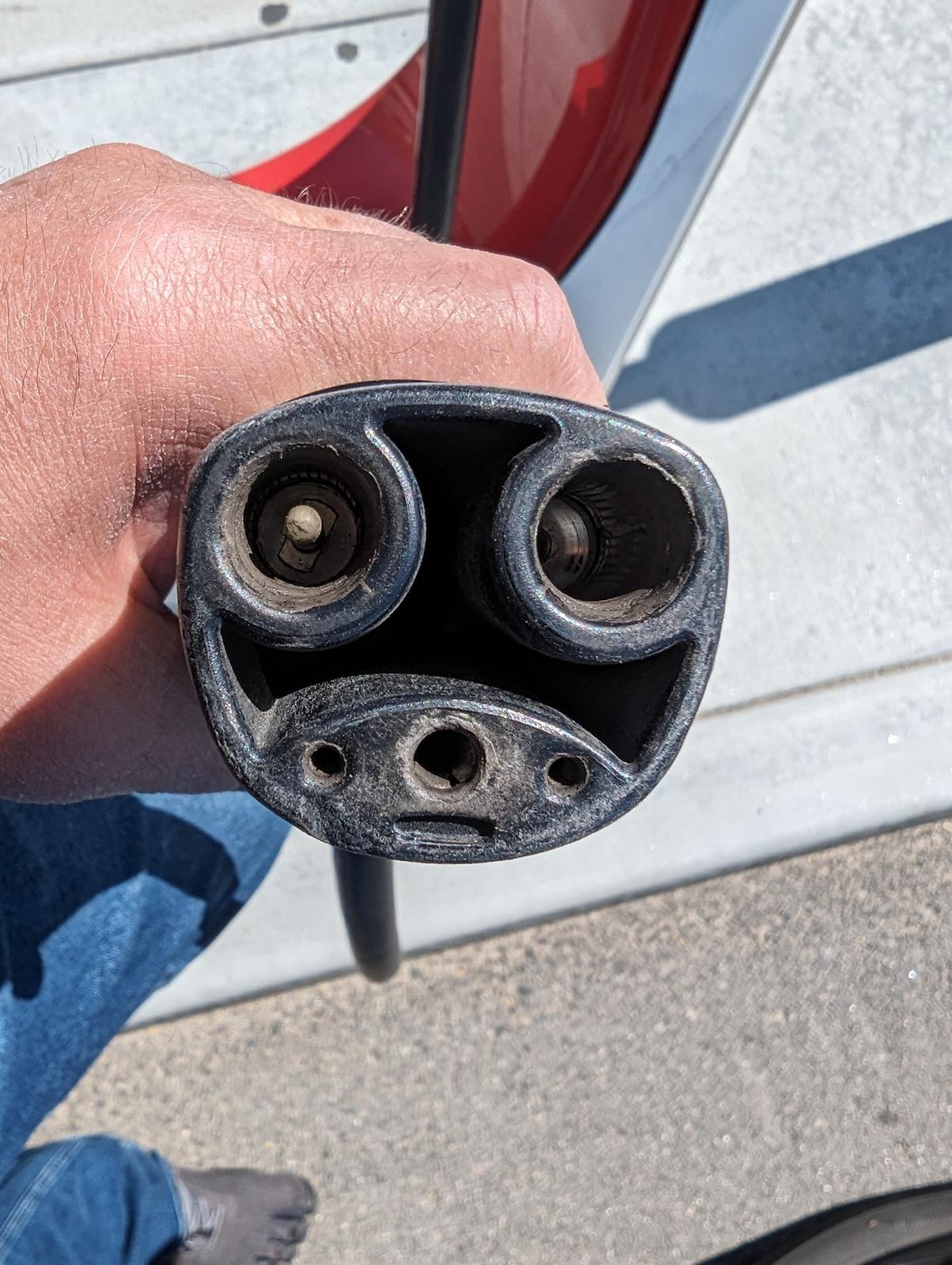

Oh, by the way, you might want to make it a habit to check the NACS power plugs. I've seen at least a couple with missing pins...
Ford F-150 Lightning Any problems at Tesla Supercharger with A2Z? PXL_20240503_172905892 (1)
