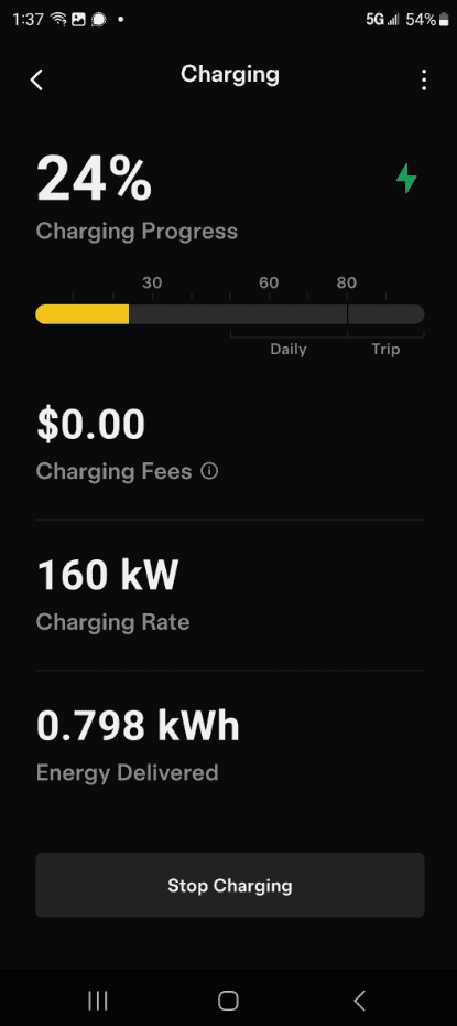

How did it fail?
The only failure I had was with one stall. It did start charging fine and this is what I saw but faulted within a minute or so. I switched stalls and everything went fine. The problem unit cord had questionable looking contacts. Not sure if that was the cause.
