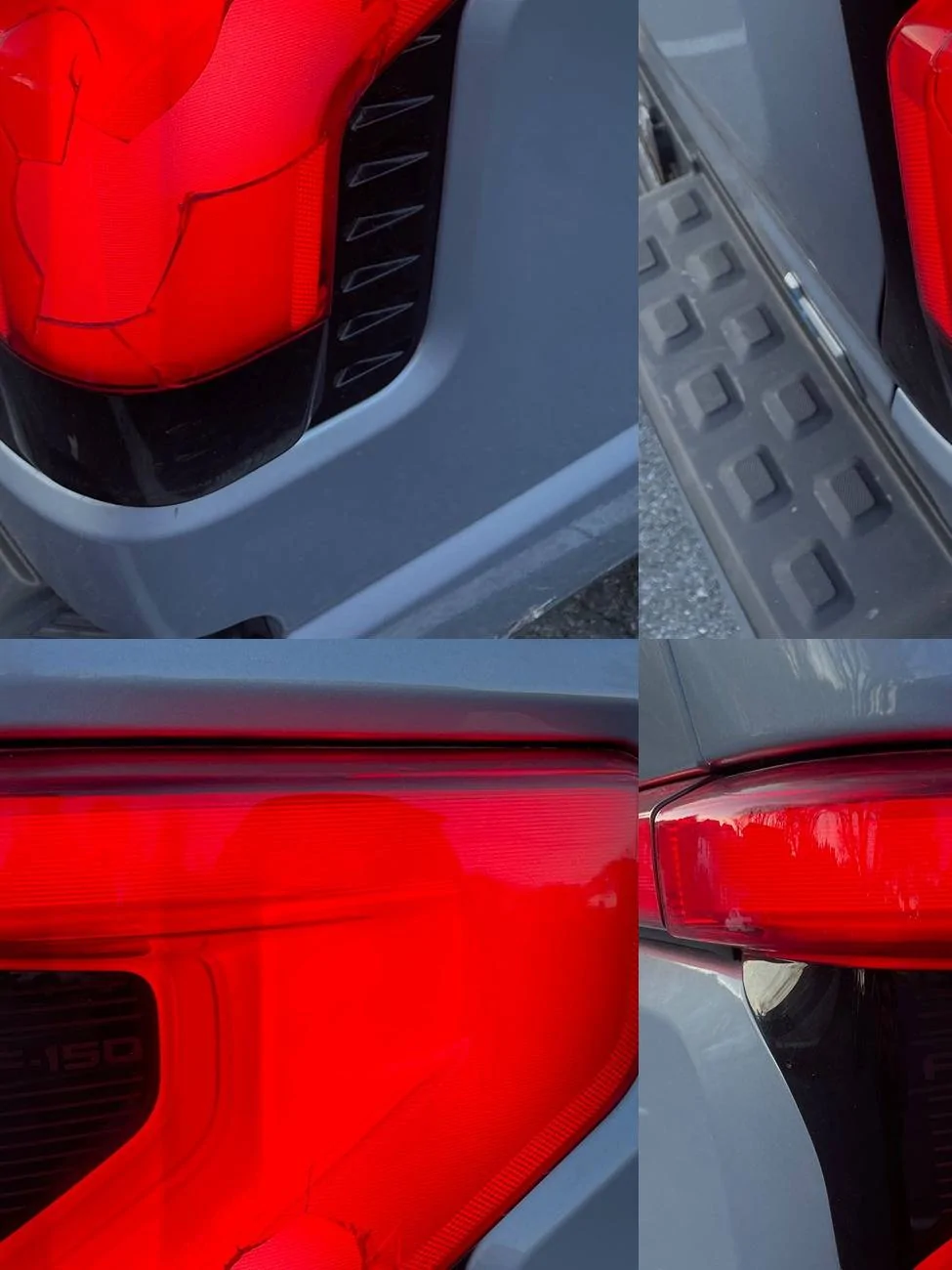

So this happened this morning - called dealership and they said $2,300 - any less expensive fixes / suggestions? Everything works fine - just unsightly broken plastic.

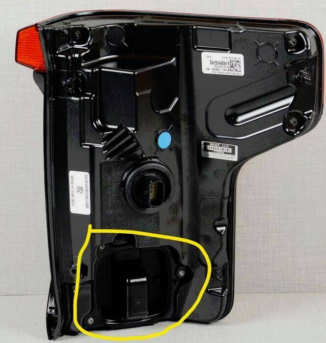

Note that inside there are sensors that need to be transferred to the new lens if you find one. I also THINK that it's (the lens) specific to Lightnings, and perhaps Lariats and above, but not positive on that.

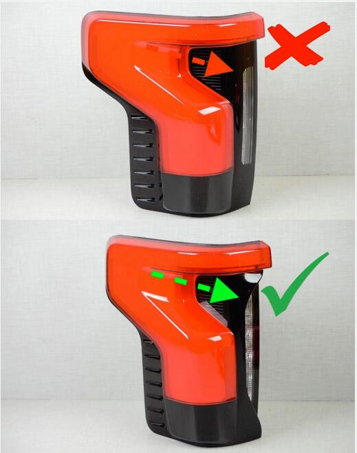

Get replacement on eBay. Note there are two styles. You need the Lariat/Platinum style. Not Pro/XLT Style. Difference is the reverse light and how the tailgate meshes with the light. Lariats/Platinums have a different tailgate.
Then move your BLIS sensor from the old light to the new one. If you don’t you will have to have the dealer program the new one. Easy swap, three torx screws.

More info:
BLIS sensor location. Three T-20 torx screws.

Tail Light styles
Pro/XLT on top (flush mount rectangular reverse light)
Lariat/Platinum on bottom (recessed trapezoidal reverse light, covered by tail gate when up)
