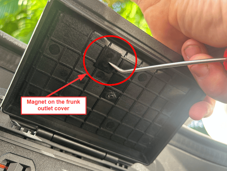

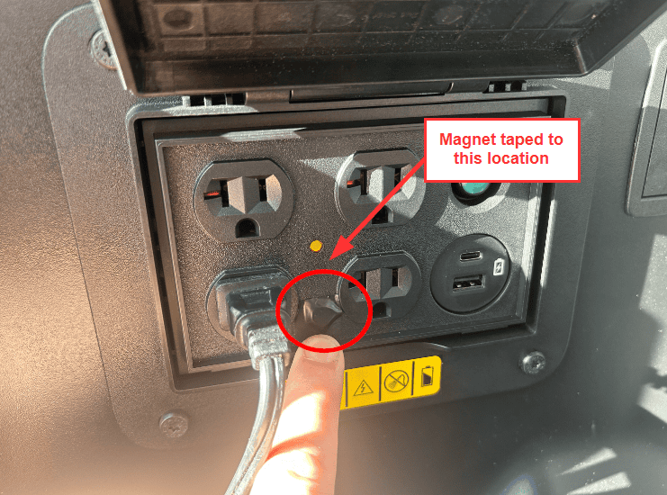

Touch a magnet to the bottom of the outlet, flip the magnet and touch again. Try the cover now.

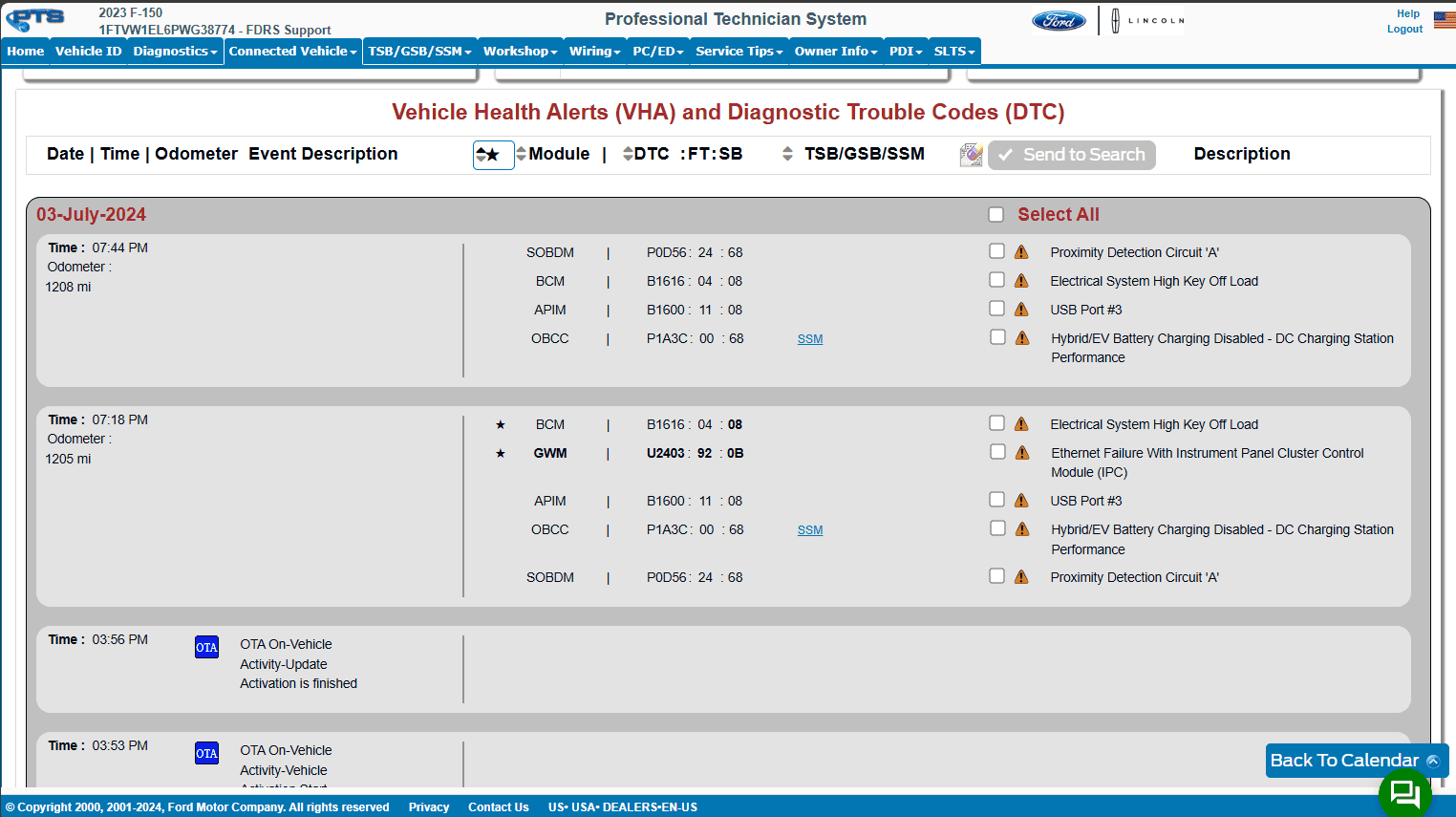

Mine is at the dealership since 6/26/24 after having a drivetrain malfunction and high voltage battery warning. It’s throwing 2 error codes related to the TCM. Looks like they were test driving it 7/3/24 and I was getting “messages” on Ford Pass that the Pro Onboard Power and Frunk outlet cover were acting up. They’re no closer to diagnosing any of it and new concerns are dropping like dominoes now…

They haven't connected FDRS up to it yet...but you did get an OTA the other day for the gateway module ( Ford Power-Up 4.2.3.1 ).
Here's what your truck told the cloud yesterday:
Ford F-150 Lightning Anyone having this issue?  Front Trunk Outlet Cover Not Shut 1FTVW1EL6PWG38774-4-Jul-24-VHA
Maybe they ought to just give up and update your OBCC to make that DTC go away....just sayin'.
