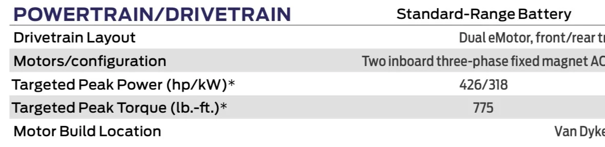

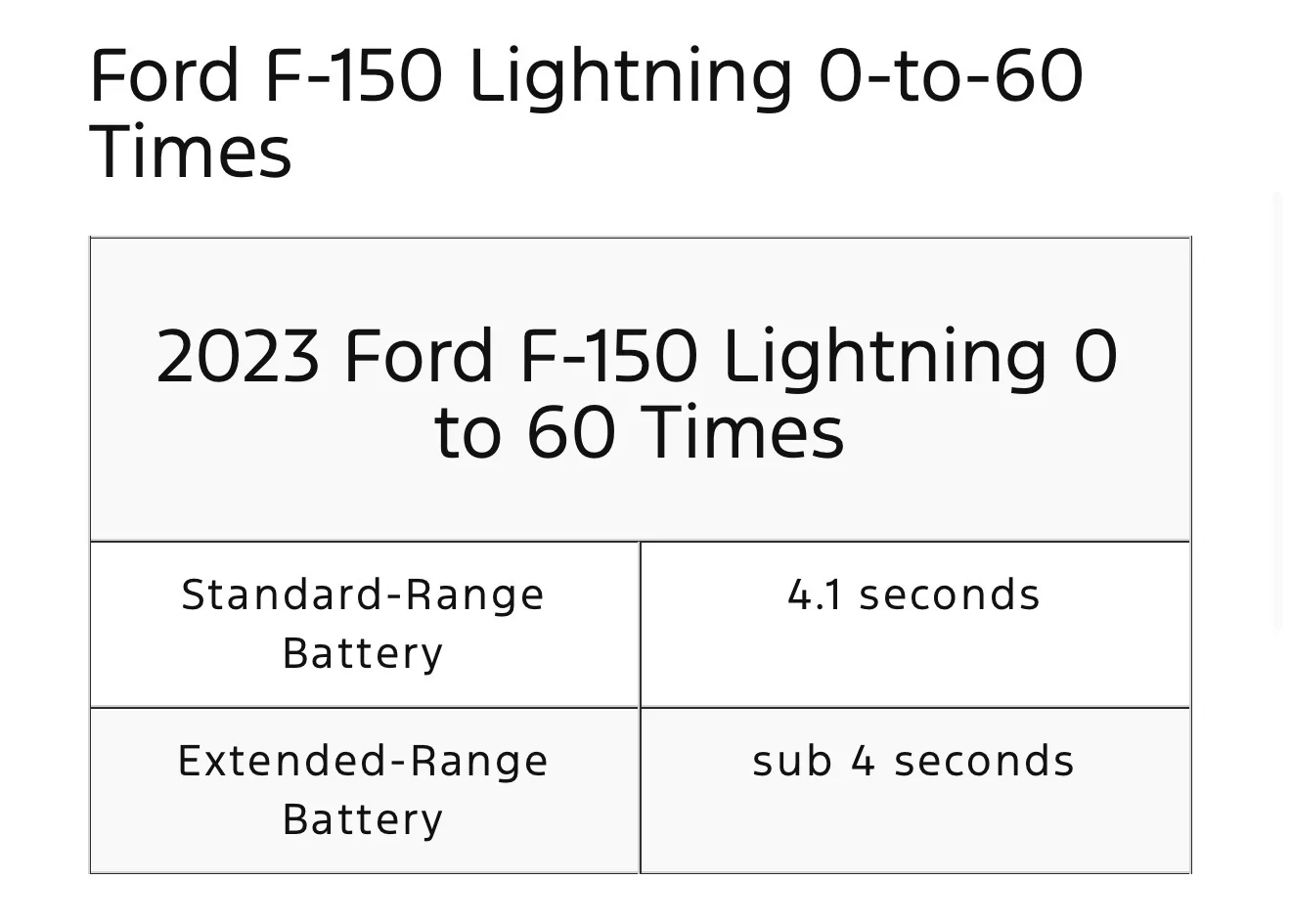

So we don't have a source of official numbers delineated by trim, wheels, battery size, etc.
BTW, the link provided isnt a Ford memo to dealers, its a Dealer advertising page. That cannot be confirmed as a Ford official number as you dont know what the source of the information is. The other thing is it does not delineate by trim (weight).
Which means 0-60 or 1/4 mile times means we are using community derived numbers...
And what are we expecting as a result here. If someone says they put a 0-60 app on their phone and then records lower numbers, the reduced performance claim is validated? How many tenths slower for a loaded Lariat is considered reduced performance? If my ER pro shows a 0-60 of 4.1 on the Torque app is that reduced performance? What is reduced performance for a Lariat ER, 4.2? 4.3? 4.5?
Are you for real? You mean the memo about the truck that was distributed to hundreds of dealers didn’t come from Ford? 🤣
Again we do have official data from Ford on various trims, you just don’t seem to want to look for it and that’s fine.
The difference here is the community (media) backs up Fords claims vs your “current” metric which you’ve yet to point out a community source.

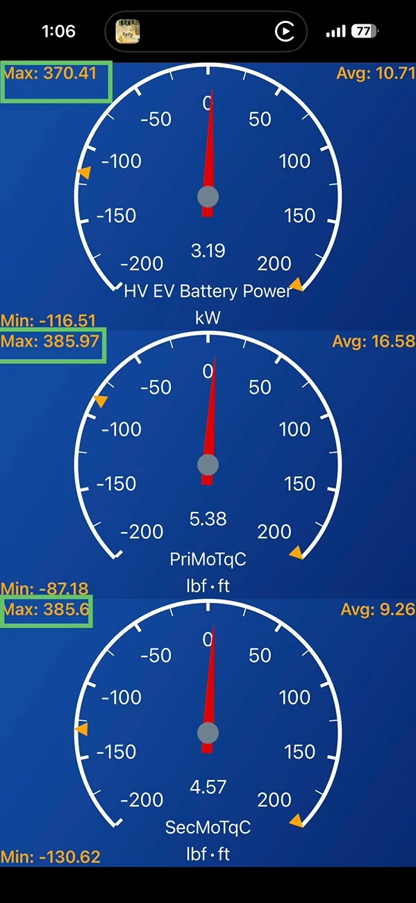

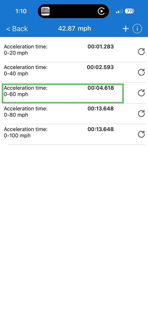

....stab, to full throttle and then relatively quickly back off. Agreed, WOT is the only meaningful way to do this.
I did also say it was not a good test.
. I agree it's not a good test, but it was a test I had previous data on and could replicate.
Did slightly better testing a short while ago.
. at low speed going full throttle peaked just under 1300amps.
. as speed increases maximum current tapers off. Full throttle at around 60mph gave around 1200 amps, and up around 80 mph full throttle was closer to 1100.
I think this is better information - and honestly more in line with how I feel my truck is behaving differently than before (I noticed the 'downgraded feeling' not from doing 0-60 times). I don't know a lot about "EV power delivery" in a technical way - however I have very keen senses, to a fault sometimes. I'm not convinced WOT would be the actual verifier in this, but it might be - Is it possible to cut power intermittently or have 'pulsing power' to essentially improve efficiency to these motors???
Could the sensation many like me are feeling be due to a potential "remapping" of Sport Mode in our trucks? –I feel like my sport mode has less regen braking than it did prior. Again, I have no actual data to back this up unfortunately. Just my trusty habits on where I let off the gas coasting into my neighborhood, and how I didn't used to have to hit the brakes before the turn, but I do now, as of several weeks ago.

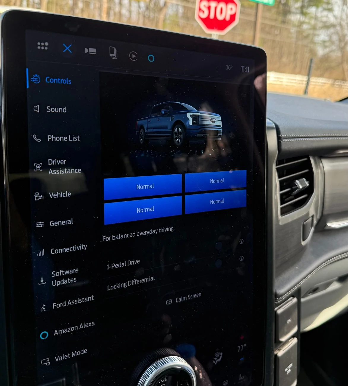

Maybe related? –Sometimes as of recent (1 in 4 times) whenever I first start the truck and drive, the only modes available are "Normal" - see attached. This persists generally between 60-90 seconds or so. Even after selecting Sport after all this, the truck often will 'fall out' of Sport Mode and I go back in an re-select, usually it persists this second time. Anyone else seeing this?

Yikes….. Something seems very borked. I wonder if it’s worth taking to the dealer for a complete reset?

That display issue has happened in the past, it clears up in time.
