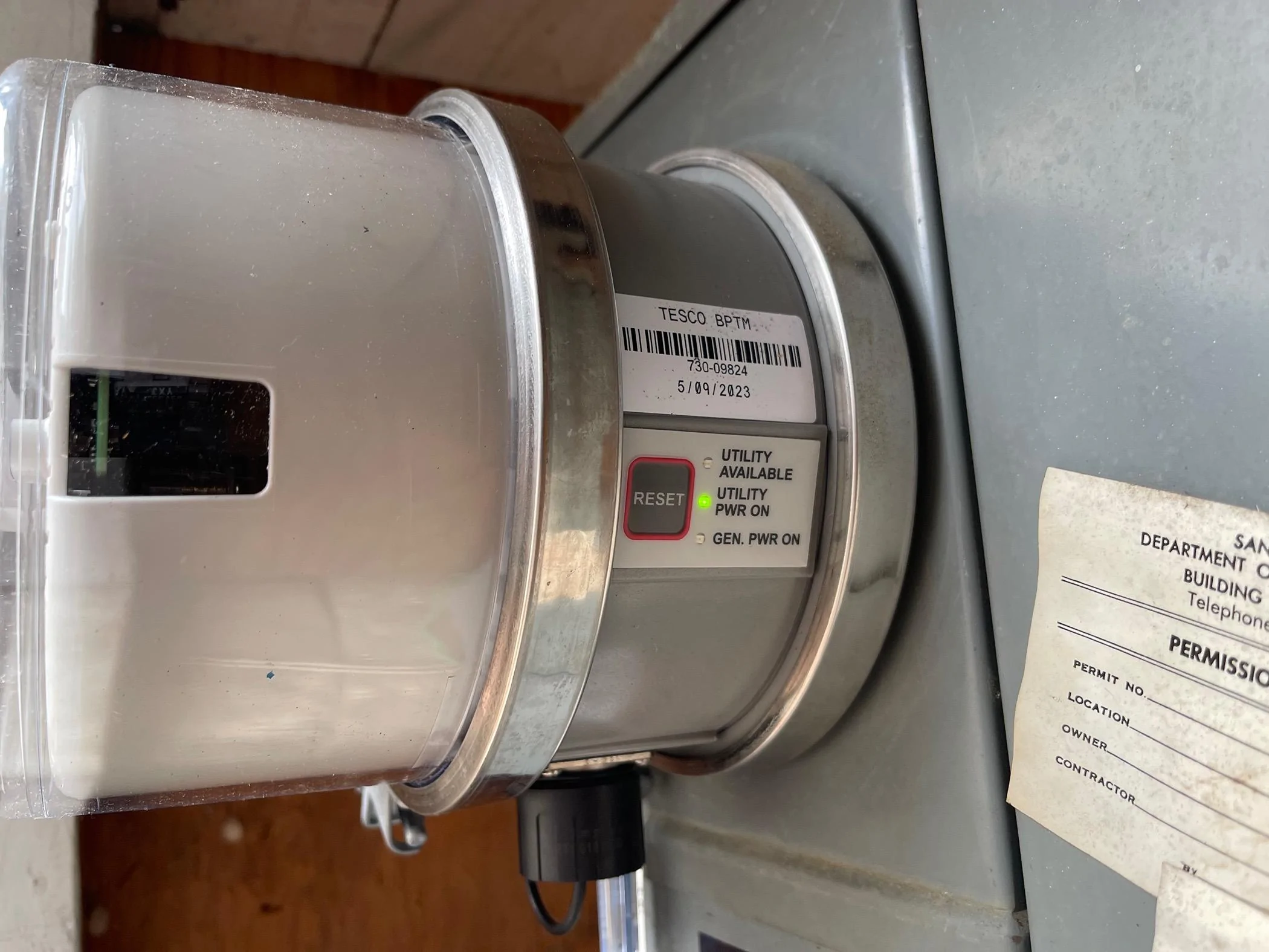

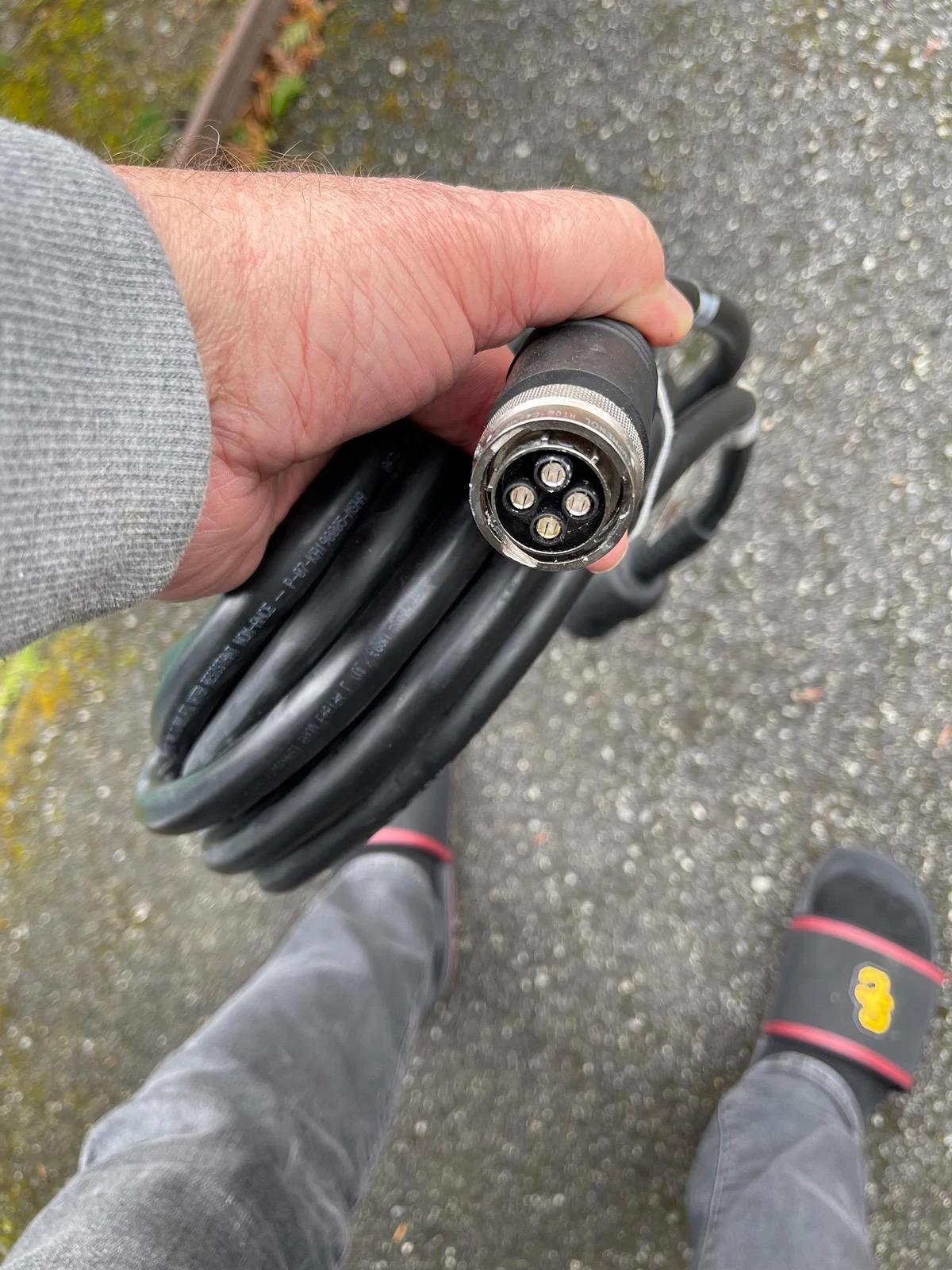

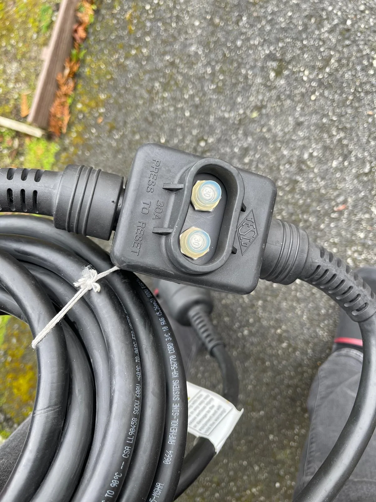

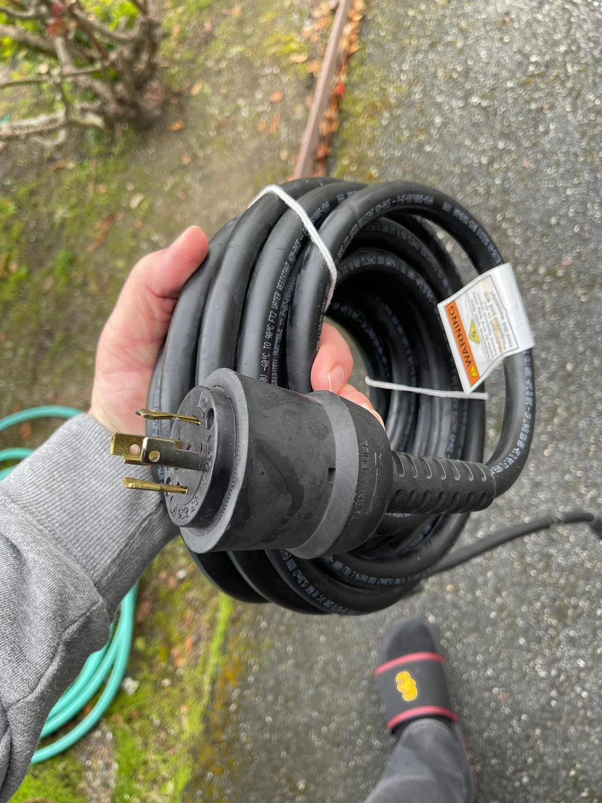

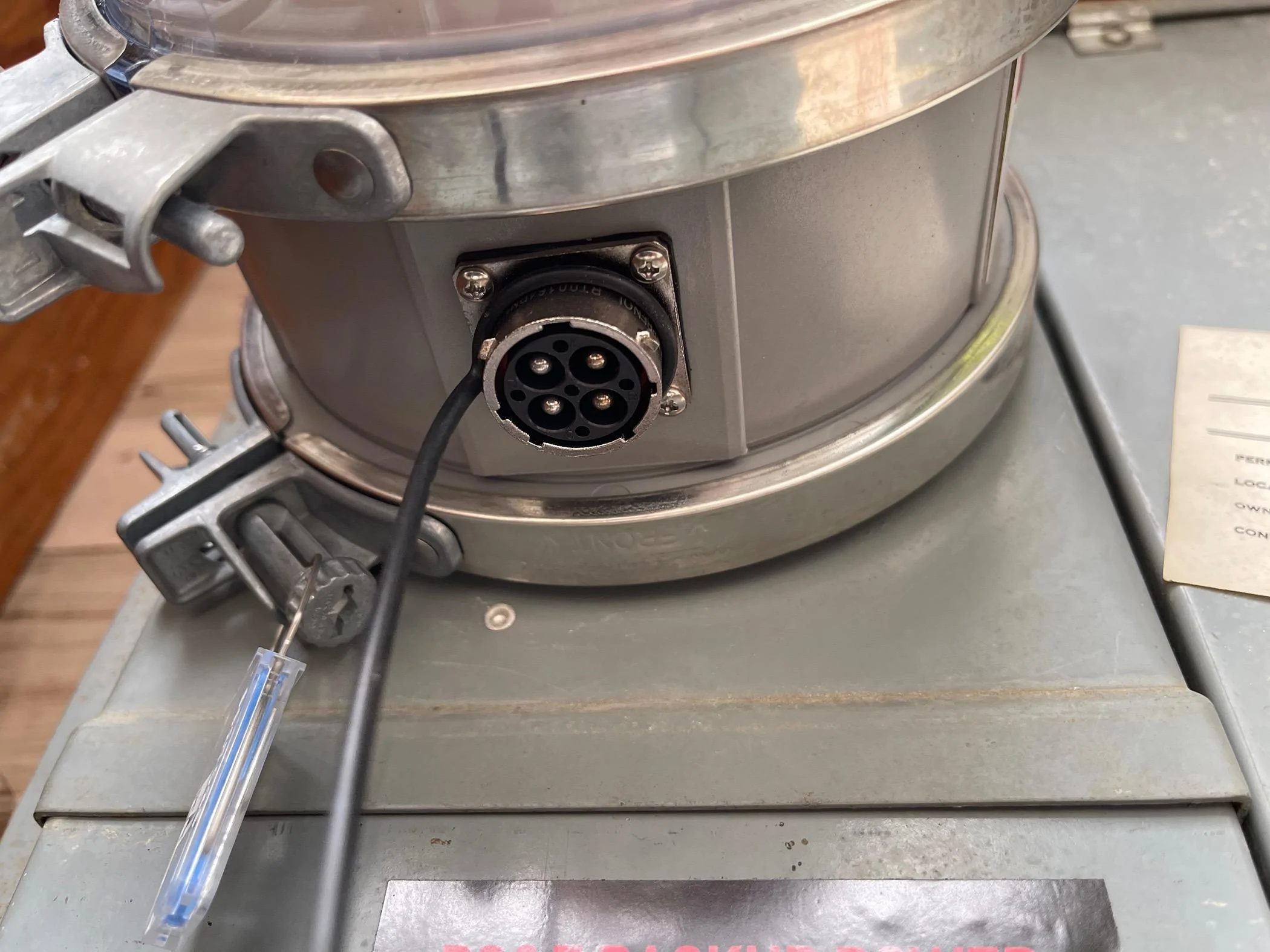

Suggest you switch to Enphase. It is simply a better approach without a single point of failure.
And for the time being you want one of these to use the 240V 30A outlet in the bed for home backup. You can use a standard EVSE to charge the truck when the sun is up during said outage.
Ugh, this is such an elegant solution, but I called about it and it's not approved by my utility, or I'd already have one. Lucky you!
