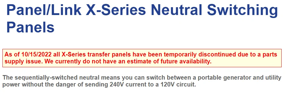

Glad you were able to get this done before Reliance temporarily stopped selling those panels.
