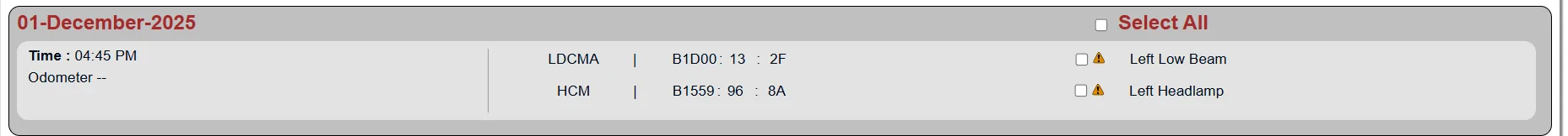

@KingConan Got your message, but responding here so the info is out there. Your truck is reporting these codes:
Ford F-150 Lightning Auto highbeams not working 1764694982035-fk
First code is citing an open circuit in the lighting driver control module and the other code cites a component internal failure in the HCM for the left headlamp. Both of these are active and not stored codes. Seems like the headlight may be the toast. If the issue was config or software related, the codes would indicate something along those lines.
Codes are only stored for 60 days at a time on the cloud, and these codes have been there for 60 days and more.

Hard to say without being able to plug into the truck and run pin-point tests. Some things are obvious and can be diagnosed remotely, but I don't feel comfortable saying for sure it the headlight based on those codes. Maybe @Jesse-Infotainment can chime in and give his opinion.

Have you checked your front low beam if it is working? I have no idea why they even went for the HCM.. This would be either the Headlamp assembly or the LDCMA(Headlight Module)
If the Low beam is indeed working then My best GUESS would be the actual headlight module.
You would need to confirm the low beam situation first though

The center light in the stack of the left headlamp always remained working. The upper/lower light in the stack worked for high-beams manual, but would intermittently turn on for low-beam night driving.
Ok. that would have absolutely NOTHING to do with the HCM.
That DTC set when It detects a open circuit from the Low Beam LED
So looking at this my GUESS would be the Headlight itself. The DTC points to an Internal Headlamp issue. COuld be a wireing inside the Headlamp.. you can pull the module and inspect the connector.. verify nothing is damaged or has gotten too hot.

I have exactly this issue. 2022 Lightning Lariat. Forscan gives me B1559 and B1D00.
Like @KingConan , I first noticed the auto high not working; then later noticed the driver side low beam out.
Took it to the dealer, took 2 days just to "run diagnostics" - result of that is they wanted to remove the assembly for $600 to test it more, but saying it would probably need replaced. I said no.

===HCM DTC B1559:96-8A===
Code: B1559 - Left Headlamp
Additional Fault Symptom:
- Component Internal Failure
Status:
- DTC Present at Time of Request
- Malfunction Indicator Lamp is On for this DTC
Module: Headlamp Control Module
Freeze Frame #1:
-ECU_POWER_SUPPLY: 14.3 V - ECU Power Supply Voltage
-EVENT_TIME: 111656839 s (Wed Nov 13 22:14:26 2024) - Event time
-HCM_DiagVehMde: 1 - Diagnostic Vehicle Mode
===END HCM===
===LDCMA DTC B1D00:13-2F===
Code: B1D00 - Left Low Beam
- Circuit Open
Status:
- Malfunction Indicator Lamp is Off for this DTC
Module: Lighting Driver Control Module A
===END LDCMA===
