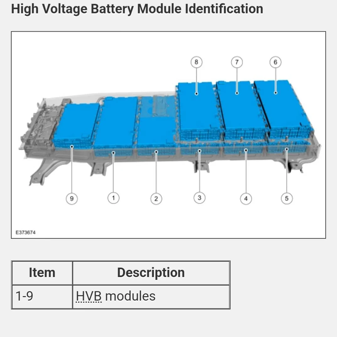

Exact same container. The standard range just has empty space in the battery hump.
Not really true. Both batteries have 9 modules taking up the space. It's that the cell modules are different. SR has 9 40 cell modules. ER has 8 56 cell modules and 1 40 cell module. This arrangement is different from the Mach E which as you noted was two modules less for the SR.
Ford F-150 Lightning BATTERY PACK REMOVAL GUIDE -- How-to remove your F-150 Lightning battery pack Screenshot_20220821-152915_Samsung Internet
Thanks for the update. And earlier video of a ford rep said that space was just empty for extended range.
