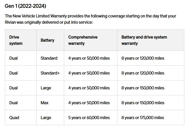

Free Charging
Mar 25, 2026
65
82
Atlanta, GA
Tesla Model Y
Ford really should've given the Lightning a Rivian tier battery warranty. SR 120k, ER 175k. These were $80 - $100k MSRP vehicles...
Ford F-150 Lightning Battery Part Number? 1780683109491-lo
MountainAlive
Apr 18, 2024
50
884
1,609
Massachusetts, USA
2023 F-150 Lighting Lariat ER 512A Max Tow
Or at least give us the option to buy extended warranty on the high voltage batteries and service. To my knowledge, the extended service plans do not include the high voltage powertrain batteries.
