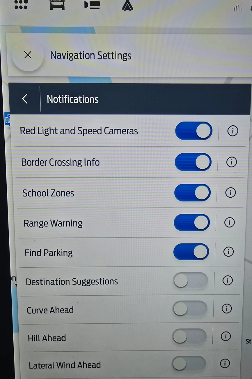

Every once in a while, I’ll hear a little bell ringing sound. It’s very faint, but it only happens periodically. What is that?
240
17,102
19,475

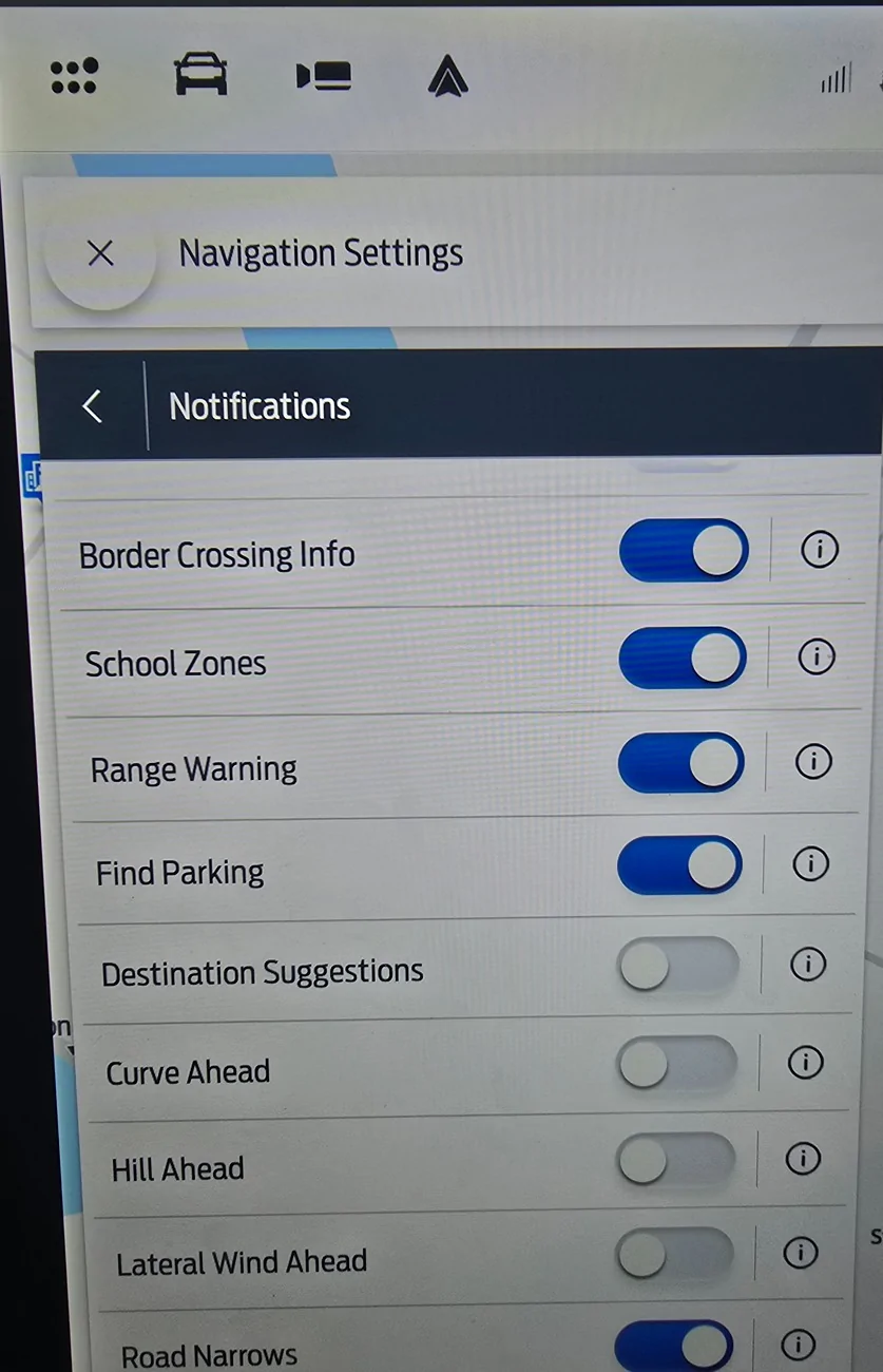

It might be an alert from sync regarding an assistance function in Ford Nav, there are a variety of conditions that you can opt out of.
Review these settings, do any of those conditions correlate with your 'random' occurrences?

So I figured out one of the bells is the Red Light / Camera dinger. There’s another one I haven’t figured out though. If I do I will follow up. Thanks.
There have been mysterious chimes noted by F-150 ICE and Lightning drivers.
It can be an indication of a low 12v battery, or the audio system didn't boot up fully, or the navigation system route planning found traffic jams or other problems ahead...many post on the ICE F-150 forum wondering about it.
As noted above, you can turn off a lot of the suspects in the navigation system to eliminate that as the source.
