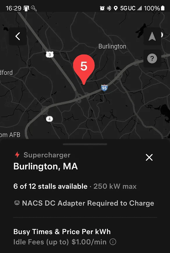

Which Tesla charging site in Mass?

This station is coded as NACS adapter required, which means you should be able to activate with Blue Oval Charge P&C.
