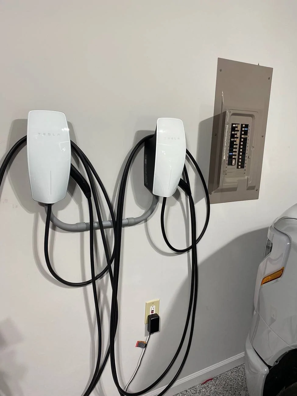

so, here’s the install. Universal Wall Connector on the right, Gen 3 Wall Connector on the left. Universal has wiring pass thru for daisy chain connection. Works perfect. The built-in NACS/J1772 adaptor is really nice. Just un-holster the one you need.
The conduit change (for the truly observant) was because the first elbows were so close they wouldn’t allow the unit faceplate back on. Didn’t see that coming. Lol.
Looks good. Theoretically it’d be very straight forward to swap my Gen 3 for a Universal and add the necessary conduit to install the Gen 3 on the other side of the garage door. The conduit run would be about 20’.
Exactly what I did. The new Universal unit literally used the previous existing mounting holes from the Gen 3 baseplate.
Super easy addition, with PVC conduit, although not quite as elegant looking.
Took a couple trys to set up power sharing feature via the install app.
The key is to disconnect phone from home WiFi and disable home WiFi auto connect. Then scan the Universal ā€œleaderā€ QR codes, making a connection with the units to update software, make setting for sharing and then scan the QR code for the follower and update its software if applicable. Then unit setup is finished.

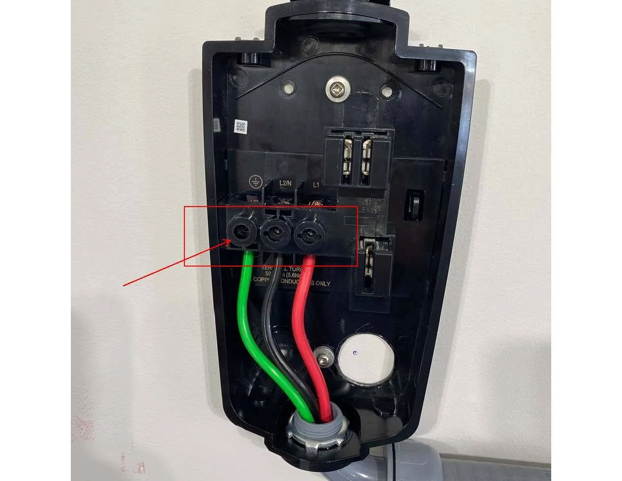

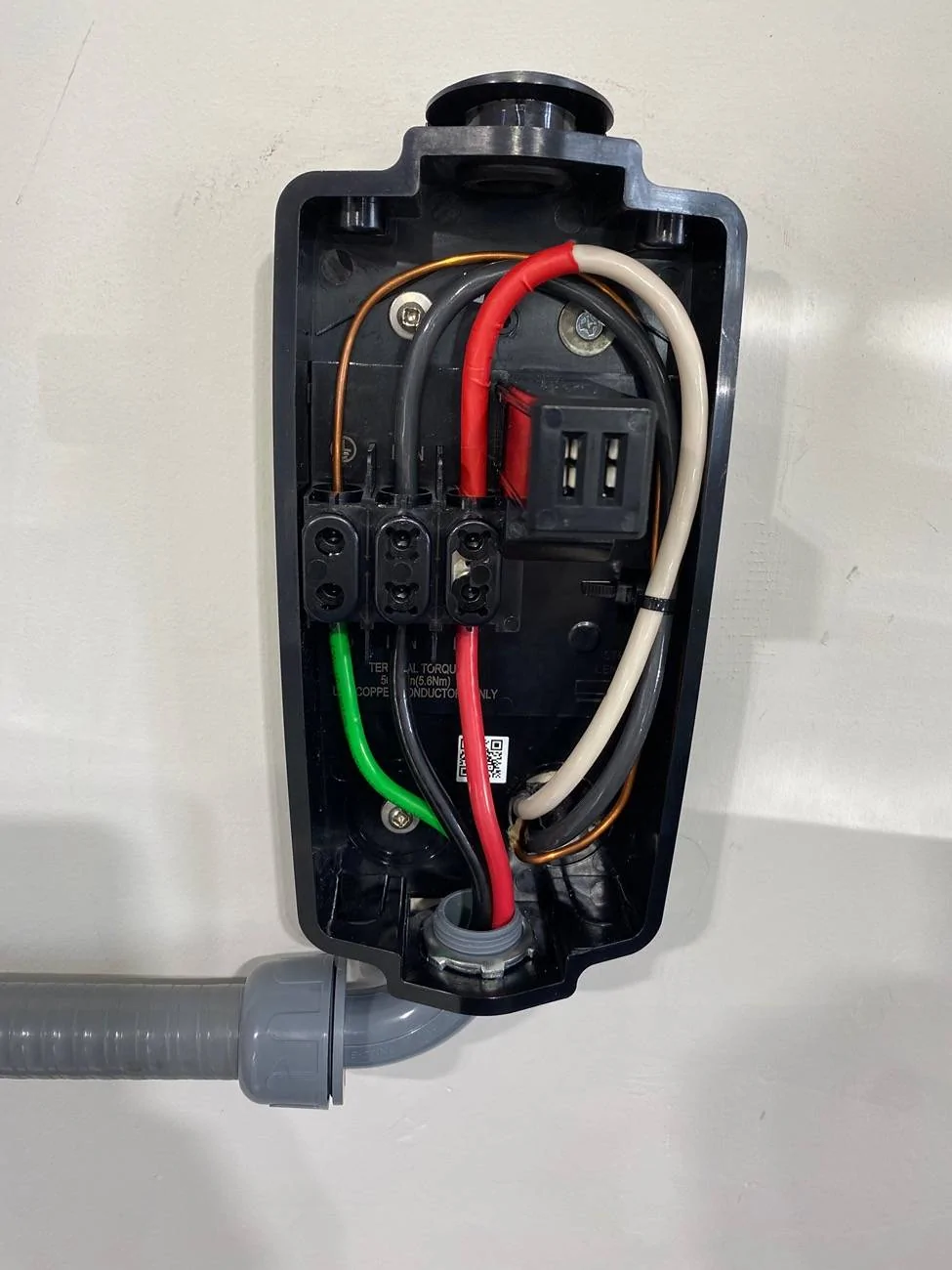

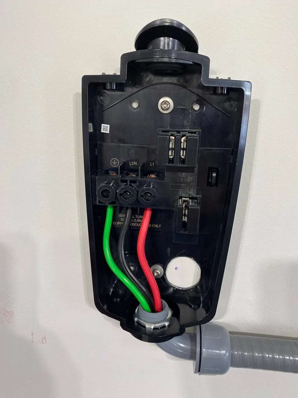

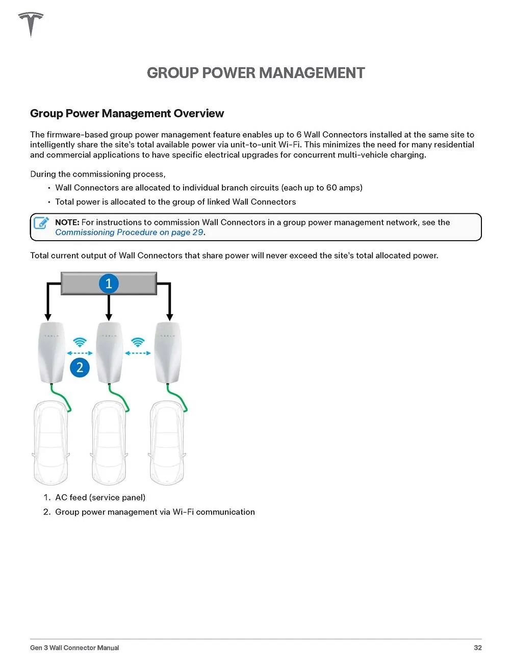

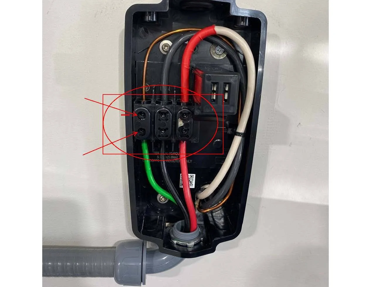

YES, Sort of!!
The base mounting plates are different an not interchangeable.
The Version 3 only one possible connection to land each wire input
The Universal has 2 available connections to land two wires per input. This makes "daily chaining" them easy.
YES you can configure 2 or more versions 3's BUt you can't easily daisy chain them. You would need a junction box or a sub panel to split each line to two or more inputs, depending on how many Wall Connector's you want to power share.
See pictures below.
