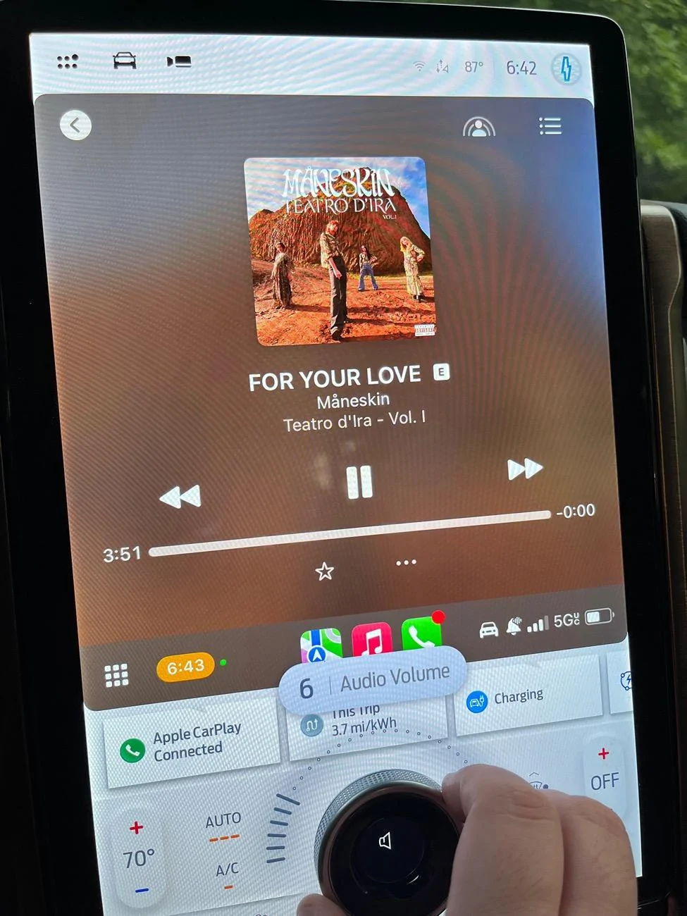

In case anyone wanted to see what the updated screen looks like.

Which update is this?
I use FDRS to do updates, I just know people have been mad at the lack of UI updates and this just became available. So it does look like Ford is finally making updates the Mach E's have had for months available for the Lightning which is nice.

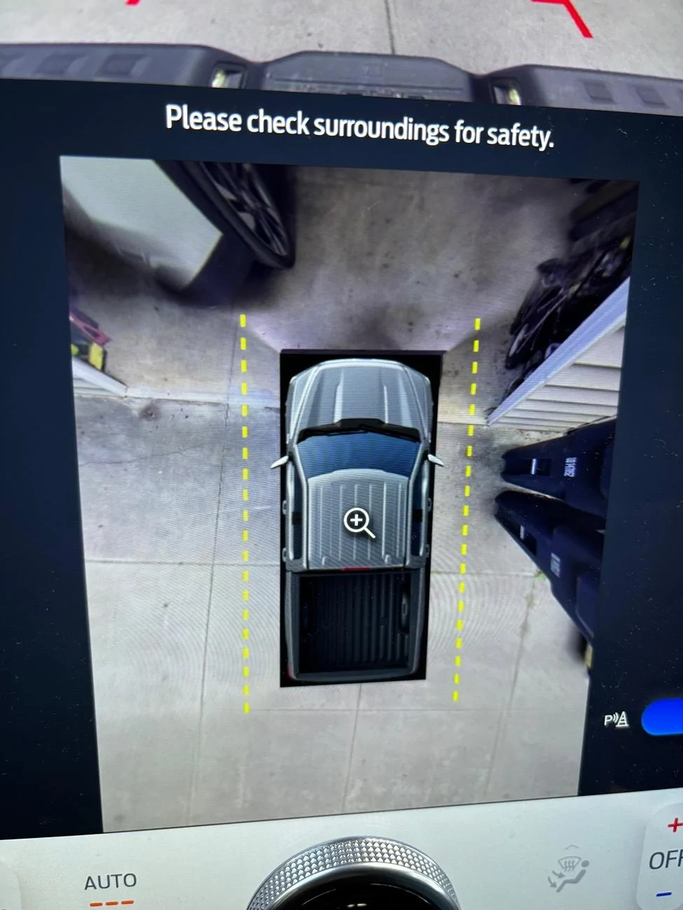

Not surprised, there is still no official fix for the 6.13 that took away BC. Seems to me like I got an update from a Mach-E to fix my BC which resulted in half a 360 screen. What a mess.
This is one of those time I would love for these bloggers sites to make a fuss out of it to light a fire under Fords ass.
This fixed my BC not working but my 360 camera has been messed up since that update also.

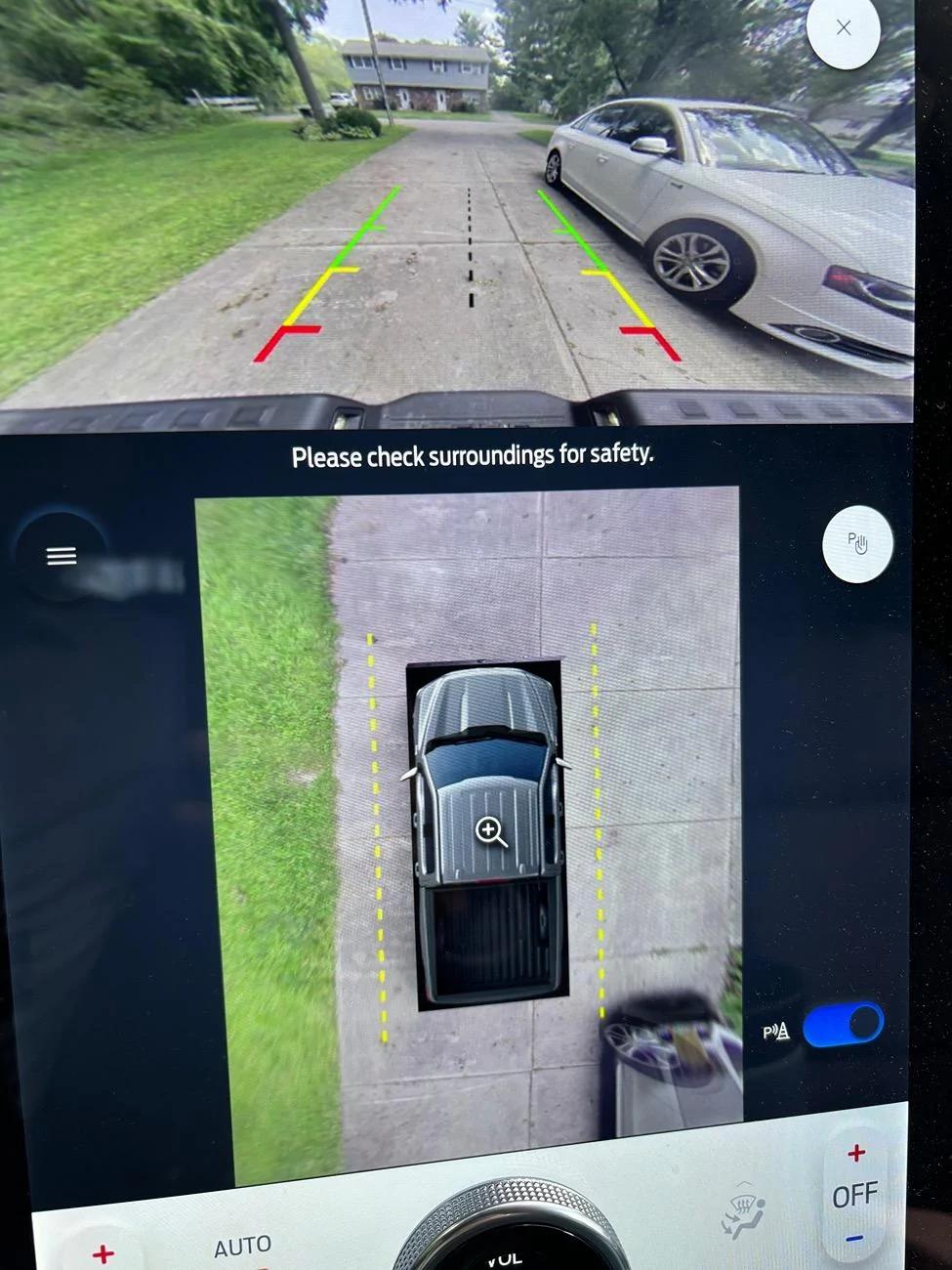

Look at image at corners - distorted. Can’t really use it / trust it on all 4 corners.
That's weird if it happened right after an OTA. If you have FORScan, you can run the IPMA/360 cams calibration procedure to see if that fixes it.
This happened after that CMR FX that dealer had to install for me to fix my BC camera fault.
The CMR itself has nothing to do with the 360 cams. I believe you that the problem started then, but I would try the calibration first to see if that fixes it.
I've had this same issue since the day I bought it. Attempted to fix via service twice, it's better, but still not great. They need either a better auto calibration tool, or the ability to let us manually calibrate because I still cannot trust this like I could in the MME.
