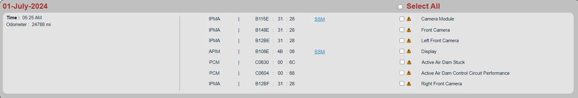

In these cases, what I do is pull the as-built data of the IPMA module to compare what certain lines that have to do with BC functionality are showing can compare it to some notes I keep that shows what it should be showing. For some reason, certain updates that have nothing to do with the IPMA change the config on a particular line in the module making BC inoperable.
However, in your case, all the config seems correct. I had a second set of eyes that knows A LOT more than I do about these things look at your truck, and he does not see anything preventing BC from working either.
So, I pulled the codes your truck was reporting to the cloud and I found some possible clues there. SSM 51688 referenced by one of those codes cites a possible loose connection between the IPMA and the cameras. That will for sure cause BC to not work. Looks like it may be due to a hardware issue in your case.

As soon as I could, I took the truck in for service with the Ford BC people assigning the appointment and helping the technician thru with the problem. It came down to a fwd camera misalignment. The reset/alignment of the camera was successful. BC is working now.
Since then, when I access the Software Updates page, I still see that impartial update displayed. Also, Ford is working to send me the rest of the update at a later date. So…….still waiting.

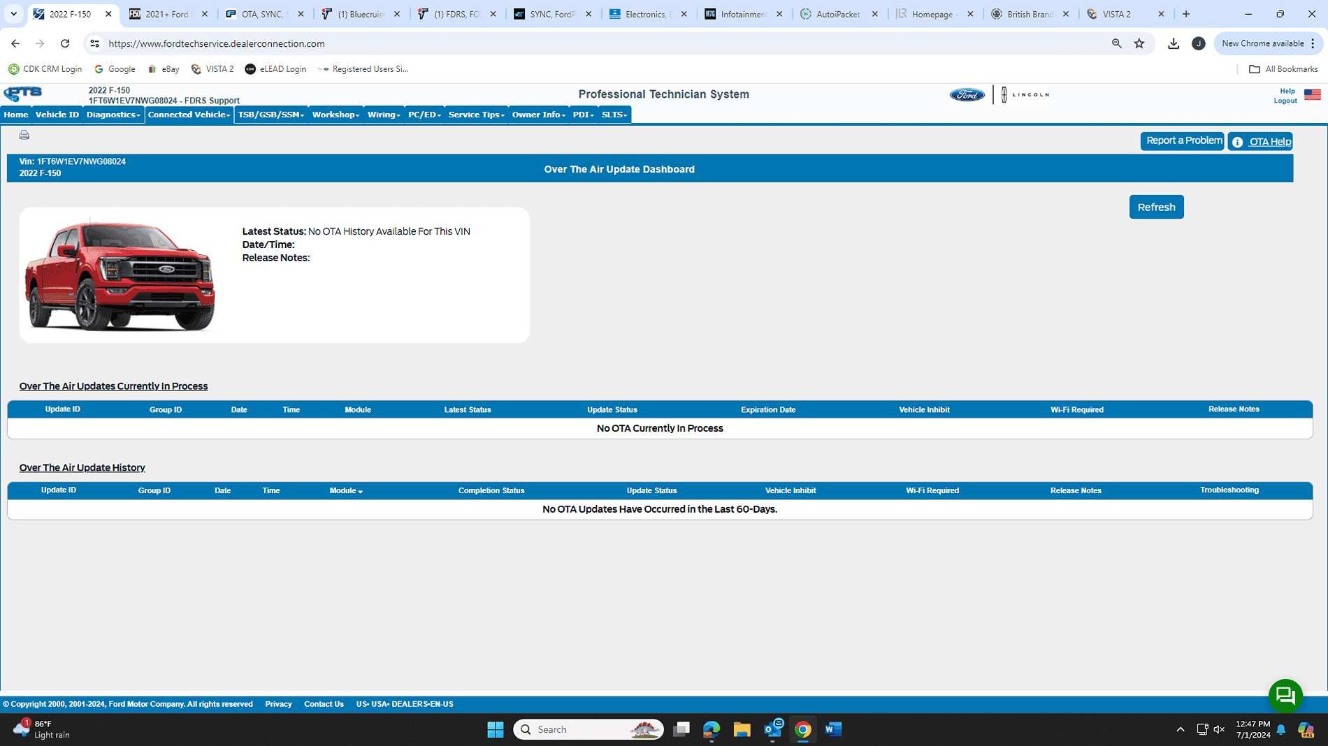

Not sure about the failed update and what you're seeing. Your OTA dashboard in PTS does not show any recent OTA history.
