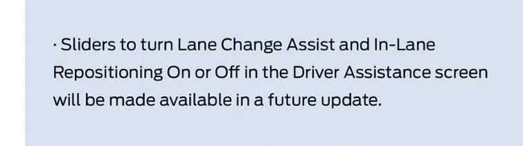

I would be curious if this latest round of 1.4 updates have the same release note that Sync updates are coming later. I.e., you don’t have the toggles for Lane Change Assist and In-Lane Repositioning (but the functionality is there).
Yes that was what I saw in the release notes... Still noting the toggles will be coming... didn't look yet to see if they might be there.

Here are what the original notes said (post #11):
I also got the early update but I had enabled sliders with FORScan. That’s why I’m curious if this update has notes that said the same thing.
Also curious if the update release at the bottom is still IPMA-24.204.10.9
My recent update states IPMA-24.204.10.9 so it looks like it is the same...
