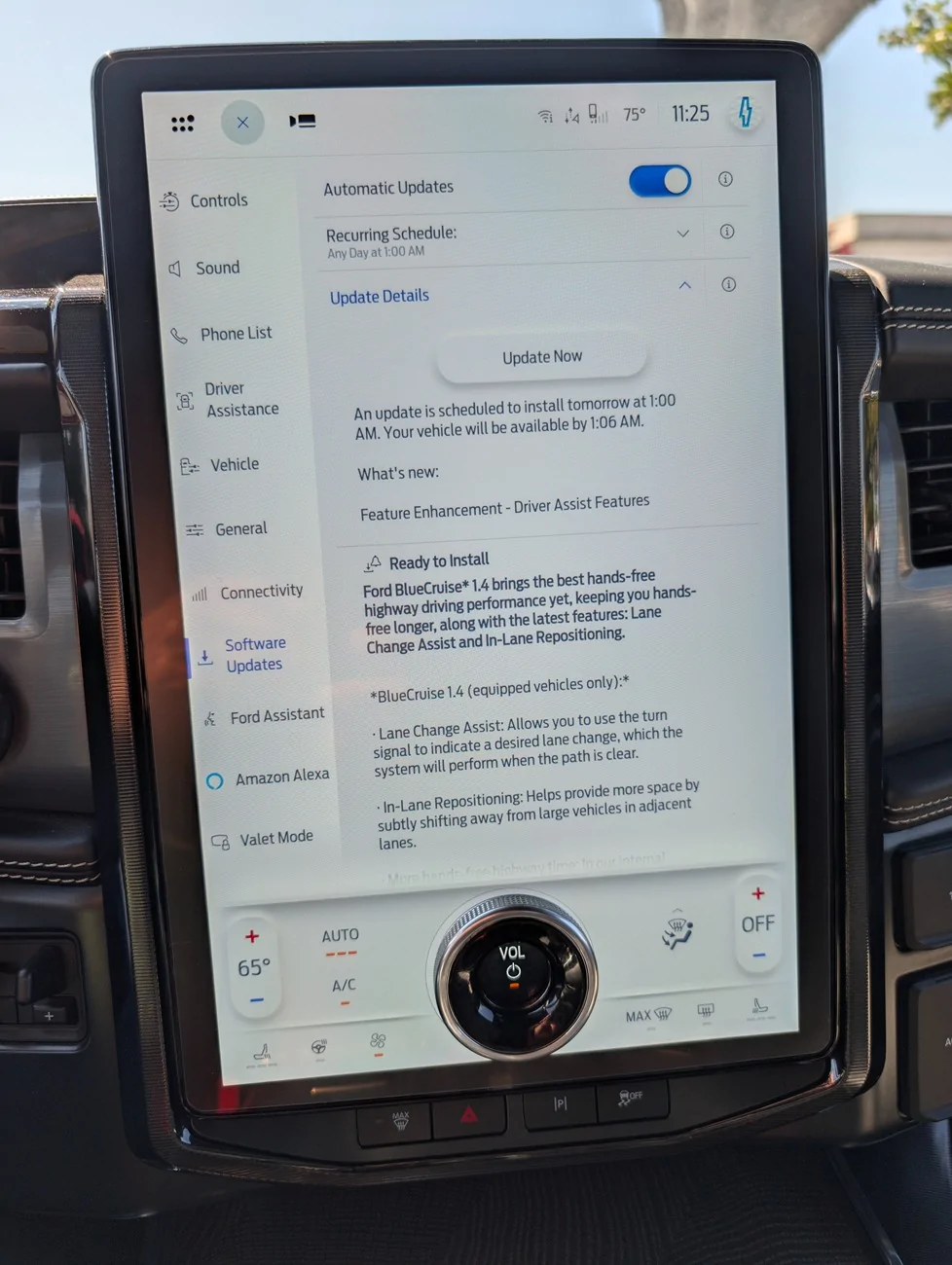

Yes, I've taken the Mrs. out to lunch, this popped up when I parked the truck, I'll install it later after we're home...
Big news!! I gotta check mine at lunch
edit: I got nothin. :explode:
