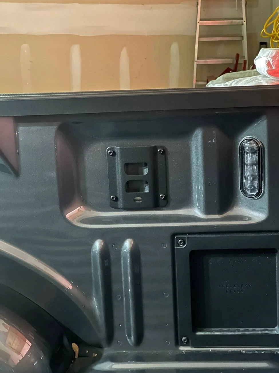

Searched the forum and didn’t see answers to these questions, most likely because I’m such a rookie truck owner they’re pretty basic.
1) from my research (and help of chatgpt) I guess I have ford “boxlink” in the truck bed. First Q based on this statement: is this just as “cross compatible” as traditional t slots? Searching Amazon most accessories require a t slots instead of the “boxlink”.
2) to keep my level of effort low and since most of my “hauling” is going to consist of light work like camping gear, bikes, furniture and 20lb propane tanks… which tie down anchors would be recommended with these boxlinks.
picture of the boxlinks in my trucked:
Ford F-150 Lightning Boxlink cleats IMG_4958

Also that mounting plate looks different than what I remember. Looking at @GarageMahal's link (which are the ones that used to be included) they have a note:
2024 and newer F-150 requires replacement of the “H-Loop” production Tie Down, if so equipped, with the Standard Interface Plate Kit HC3Z-9928408-AA to be compatible with Premium Locking Bed Cleats
Sure enough, your truck has the newer H-Loop (the one on the right). The cleats in the link fit the old style on the left:
Ford F-150 Lightning Boxlink cleats 1750637684959-fi
I would hope Ford has a new cleat that fits the "H-Loop" plate style you have.
I don’t think these cleats would work for his type of boxlink.
Good catch! I didn't know they changed them, wondering why...

My 2024 Lightning came with the new H brackets. I replaced the brackets with ones from Amazon for $20. They come with screws also. https://www.amazon.com/dp/B0CW14LQT1
I had a set of the old cleats from a previous truck and used them.
