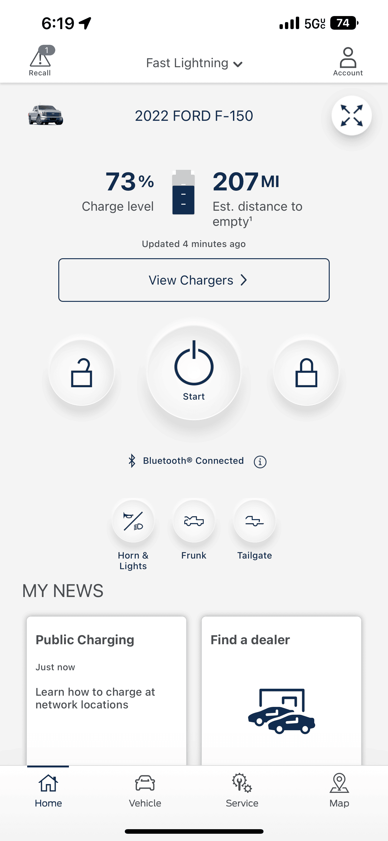

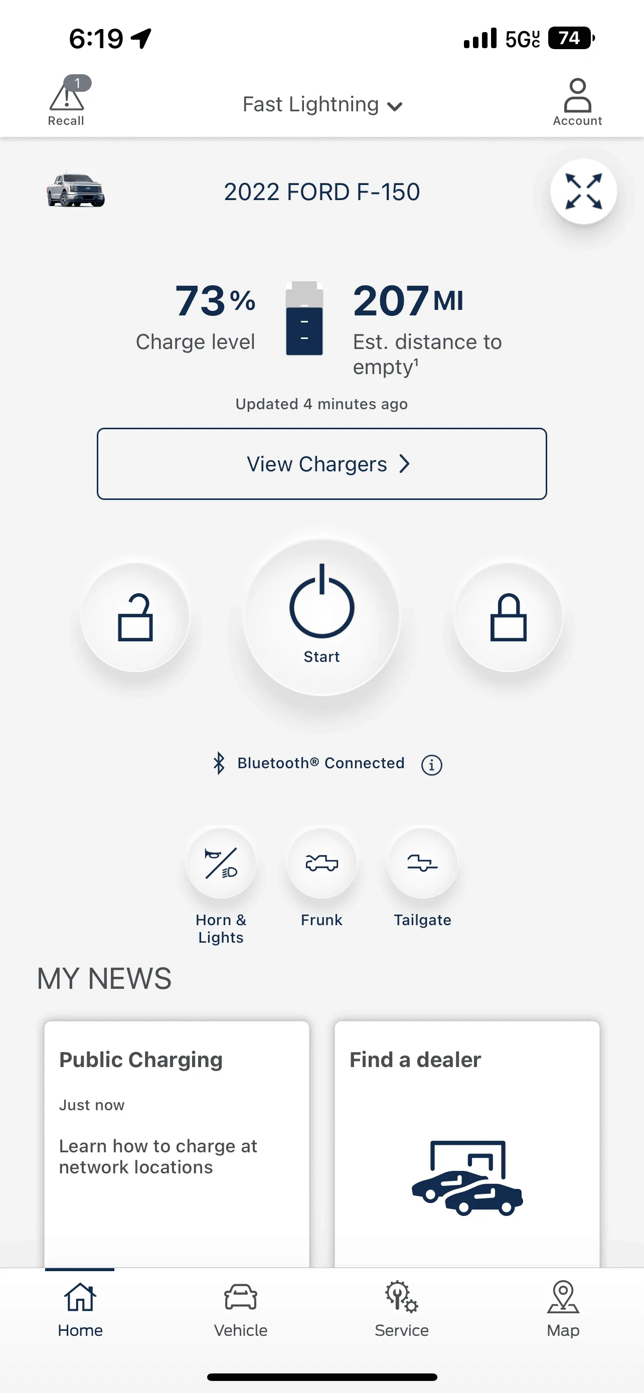

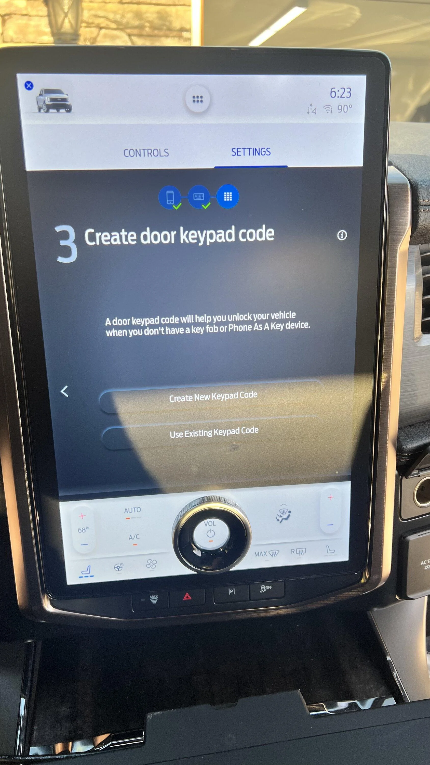

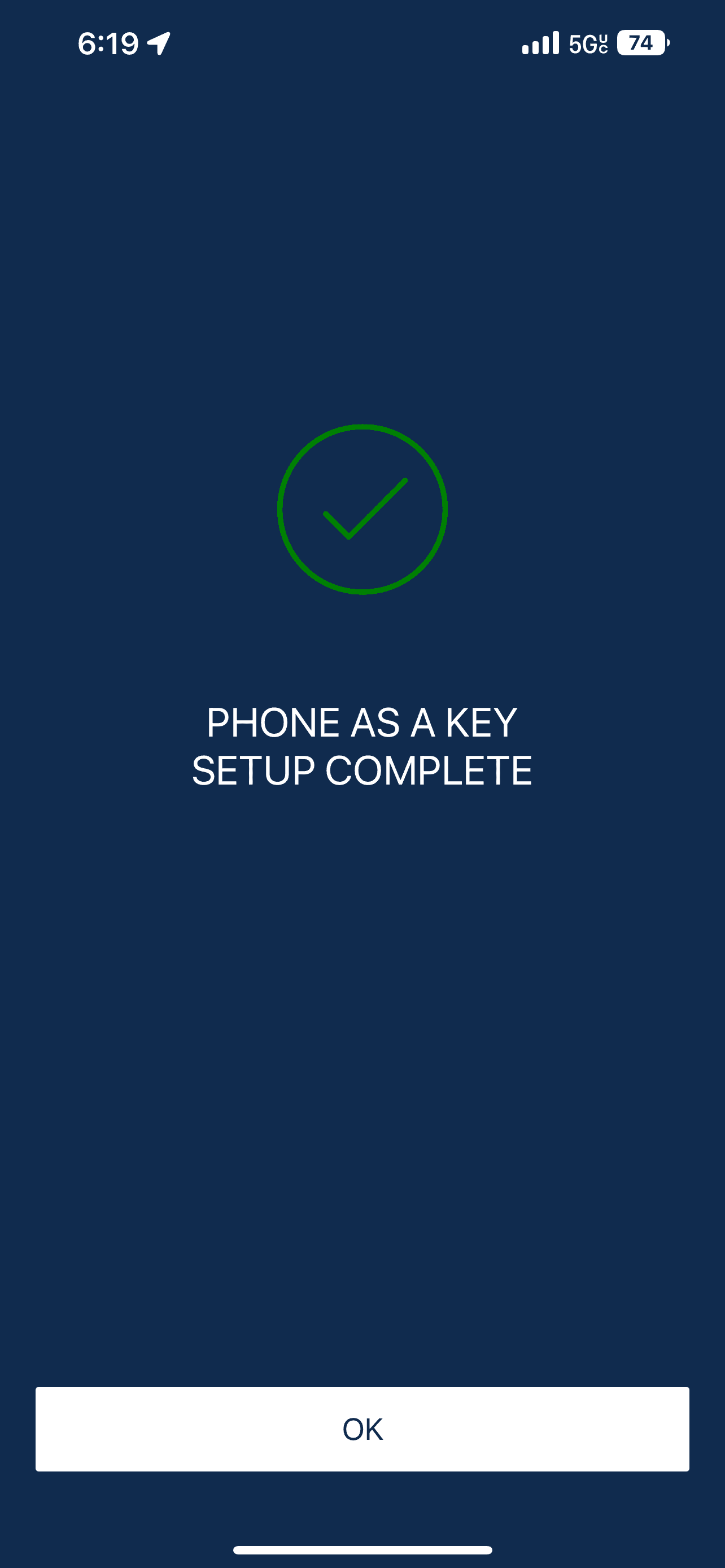

Boom fellas we got Paak working!!! thanks to @Livnitup
all we need is update the rfa module
Run a network scan with FDRS tool and close and open your FordPass app and set up phone as key should appear.

We used FORScan to flash the RFA module from strategy NU5T-14G623-CJ to NU5T-14G623-CS as this was the one difference between @jredondox truck and a VIN with PaaK working.
After this we ran a Network Scan in FDRS so that Ford's servers would recognize firmware change to the RFA module and then the PaaK setup appeared in FordPass immediately.
