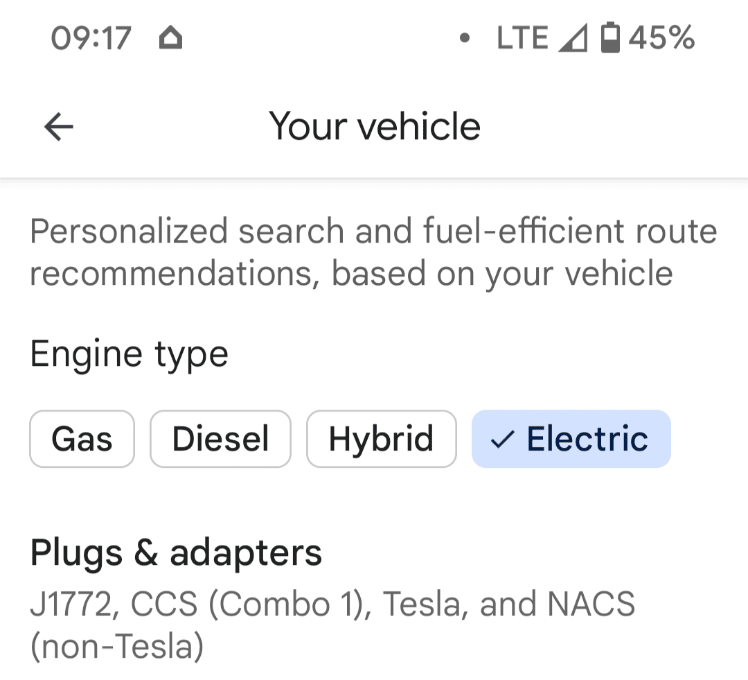

You can modify your vehicle settings in Google maps. Tap your photo in the upper right, tap Settings, tap Your Vehicle.

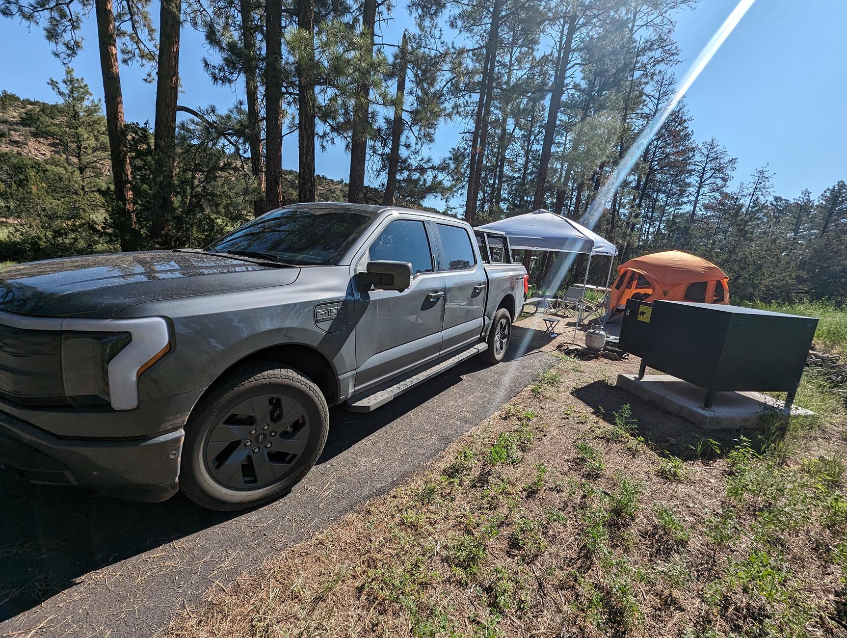

Ford F-150 Lightning Software inconsistencies locating compatible Tesla SC's 1000010678
About 75% of the 50,000 miles on our two EVs have been road tripping (>500 miles round trip by my definition). There's a short learning curve, but it's rarely been problematic.
For Tesla NACS superchargers, I will always verify with the Tesla app or website (tesla.com/findus). They're currently the primary authority until other networks implement NACS.
I'm typing this from a no-hookups campsite 423 miles from home.
The Lightning is my favorite road trip vehicle ever. The Toyota Sienna has a slight edge in comfort, drivability, and utility, but because it's not electric it doesn't take top billing.

Thanks for this! On my iphone I went to settings then to navigation to change engine type to electric.
