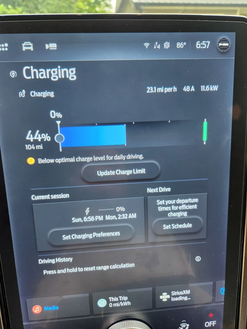

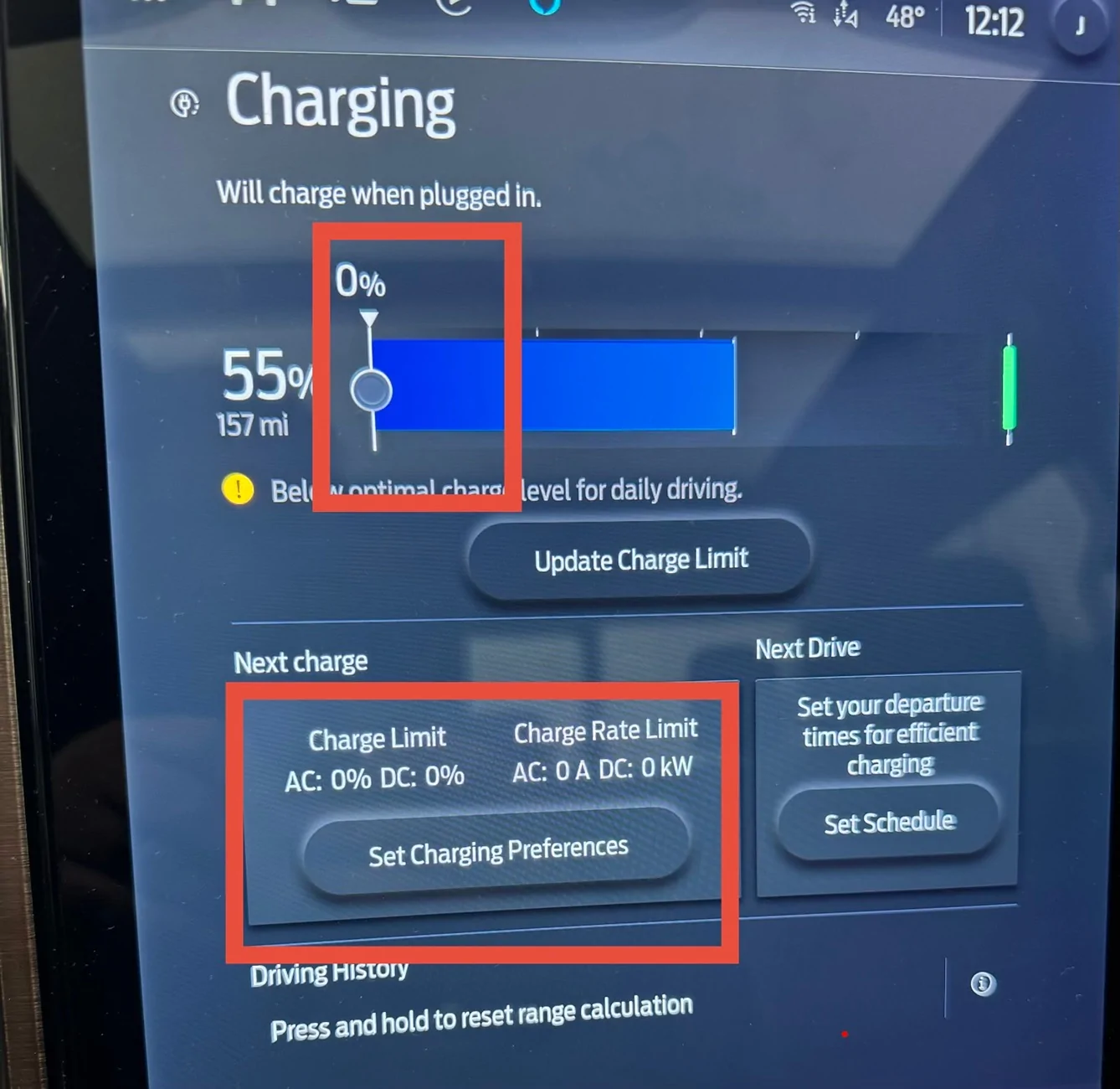

I charge +95% of the time at home on the FCSP that came with the truck. I went to charge at work this morning (I have previously charged there no issues), and instead of charging it said “charging paused”. I then looked at the global settings and they are all at zero. After resetting them, I tried again, and same results. The defaults went back to zero. I then drove to a local Tesla supercharger and it timed out there as well. Has anyone had this issue?
Ford F-150 Lightning Charge Settings Defaulting to Zero. I can only charge at home IMG_2022
I then did a master sync reset, redid my phone as key, etc. and the same results. I did go back home and it is still charging there.

Looks like you used FORScan to enable the 2025 enhanced charging screen? That's known to be mostly broken on prior model years. Does hitting update charge limit do anything? I usually change my % in the app but can't remember if I've tried changing it from the center screen after adding the enhanced charging screen.

I have not used FS on this truck, although I will if I can correct the issue and keep it out of the dealership. This was all done at the dealership. When I change the charge limit, it will jump back to 0%. thanks.

That's the behavior we've noticed after enabling the 2025 charging screen. None of the settings will stick on the global preferences screen. Not sure how you would've gotten that from the dealer on a 23 without any Forscan changes. Does it show the charge rate at the top right similar to the below when charging? Does your work show under Target Charge Locations in the Ford app or under charging preferences on the truck? Add Charge enhanced charge settings | Ford Lightning Forum For F-150 Lightning EV Pickup: News, Owners, Discussions, Community

Yes it shows the charge rate (in kmph).

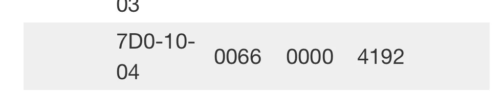

Wonder if they changed something at your office. If it's working on your FCSP, it doesn't sound like a truck issue. And I'm assuming you don't have any charging times set if they reset everything. Out of curiosity go to - FordServiceInfo.Com , enter your vin and hit download. After some time thinking, it should show values. Post what you have for 7D0-10-04

Thanks for the info. Here is what showed up.

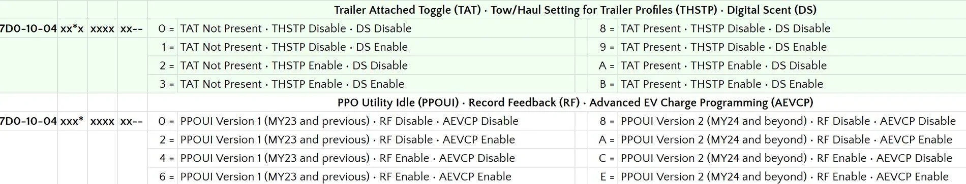

yup. Looks like you have the advanced charging. 6 is what I changed to on my 23 to enable it. Factory was 4. AFAIk, you would be the only non-25 that has managed to get that screen without forscan. Below is the snippet that @Jesse-Infotainment provided in that thread. No guarantee it'll fix the issue but you should at least be able to get back to the old charging screen. https://www.f150lightningforum.com/forum/threads/f150-lightning-forscan-thread-version-2.23634 You might can check there if anyone is local to you or you can just order the adapter and use the free 2 month license. Easy peasy if you have a windows machine. Amazon.com: OBDLink EX FORScan OBD Adapter : Automotive
